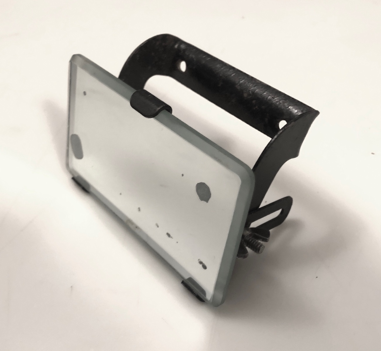

In 1924 Ford offered a rectangular accessory mirror that attached to the top of the open car windshield. The mount was curved to conform to the rounded windshield frame. Two holes were required to be drilled into the frame for installation.
My question is what type of bolts/nuts were used for this installation on a curved surface. Were lock washers used. Were the nuts on the outside or inside? Anyone have a picture of one of these from an unrestored windshield or a vintage picture showing this installation. Here is a photo of an original mirror of this type.
