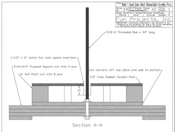

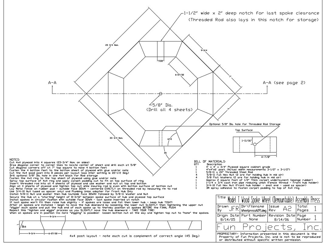

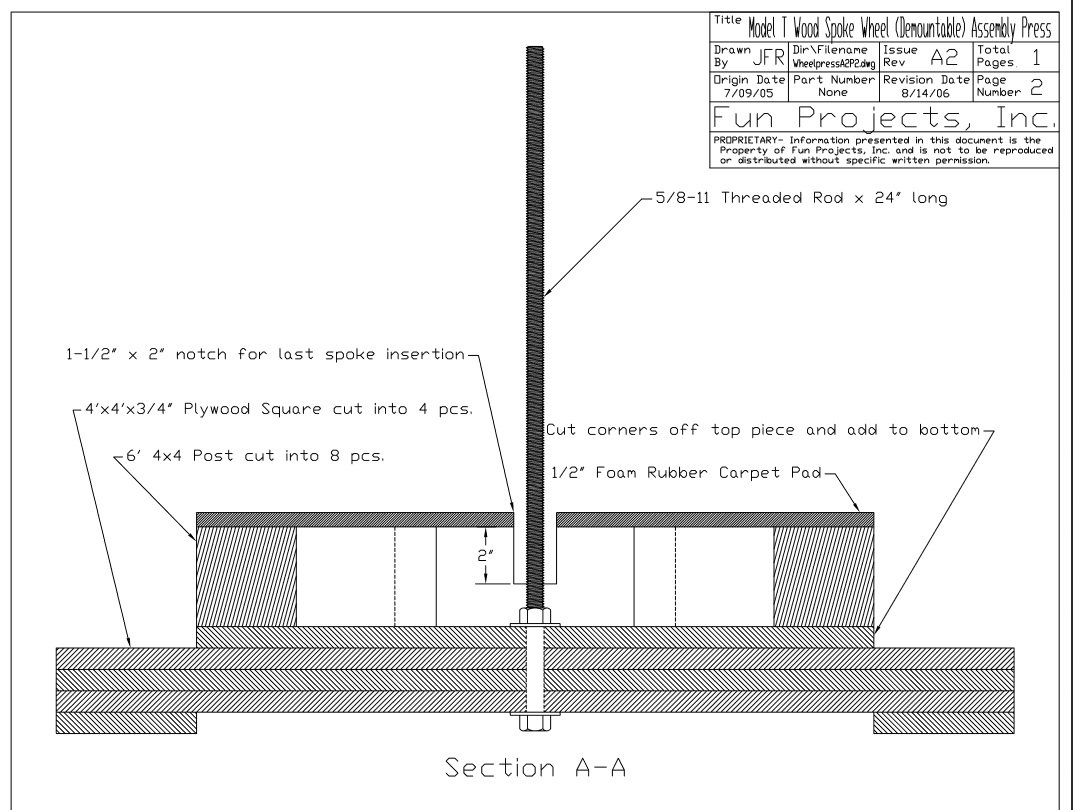

I have to rebuild my 21” demountable wheels with some new spokes and total repaint. Need drawings or general pictures and dimensions to build a spoke press. Thank you. Frank

http://www.funprojects.com/pdf/WheelpressA2.pdf
http://www.funprojects.com/pdf/Wheel%20 ... %20Jig.pdf
- Posts: 6499
Re: Need spoke press drawings.
Here are the fun projects instructions here is the link to the site as well where these page
http://funprojects.com/pdf/WheelpressA2.pdf

Thank you gentleman, I have seen this diagram but couldn't find it now that I needed it.
Appreciate the help. Frank
