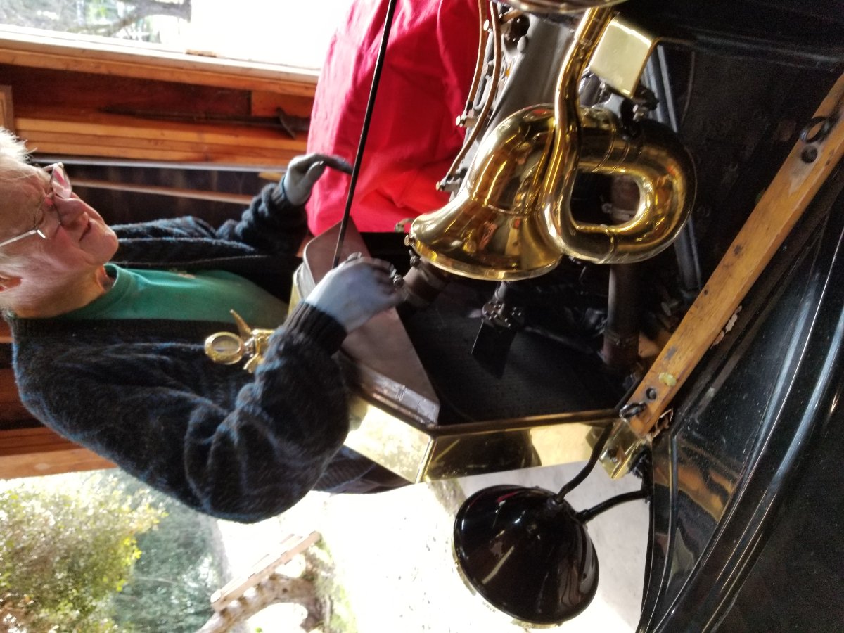

Re: Why won't my 1915 engine start unless I tow (bump-start) the car.
Tony Balkor to the rescue.
I looked it over and decided the following.
1. The plugs were dry and sooty even on full choke
2. Lots of suck at carb inlet
3. Timing Is rather restarted. The lever is at nine o’clock at top dead center. I’ve seen this previously when switching from roller timers to the carbon brush version.
4. We pulled the NH carb apart and all looks good, the needle could do with sharpening but the shut off needle looks fine and the float is a fraction less than 1/4” from the top.
5. We did a compression check. It’s hard with only a hand crank but it appeared to be 25-35 pounds.
6. All the plugs were very sooty.
I put raw gas in both #1 and then #2 plugs with no results. When I pulled the plugs there was a small pop When the plug sparked and the fuel burnt. No explosion. So we decided over lunch to pull the head The valves all looked very sooty. So we ground in all eight plugs, they only needed fine paste and most came with a nice grey line with just one application.
Then I asked why did Steve change the timer, “because the other one fell apart and there was HUGH backfire which blew off the preheated”.
So there it was, soot everywhere from backfire. After we replaced the head, new gasket etc it started on the fifth pull. The timing lever has to be at nine pm and the mixture needed to be at about one turn. That’s probably caused by the poor needle shape and Steve will have to shorten the timing rod but it should be OK for the weekend tour.
