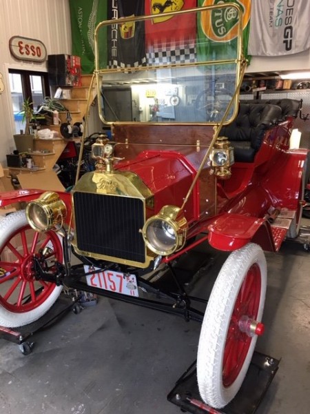

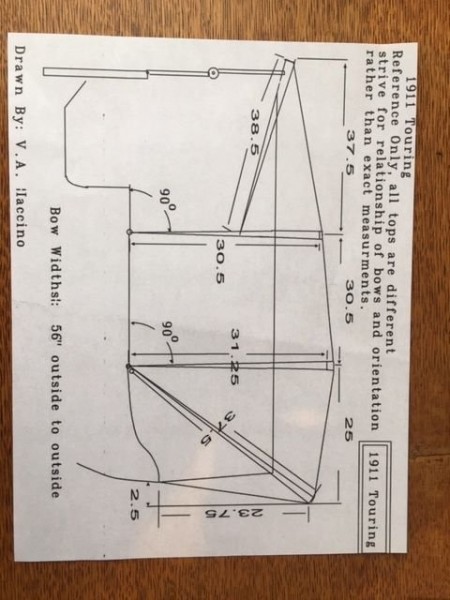

Hi,
I finished my 1911 Touring restauration but I do not have the Top when I bought the car. I'm ready to go ahead with the top but I would like to know what is the dimension? I found that dimension bellow on MTFCA forum. I have the bows and I bought the top wood Bows laminated at Lang's but I would like to know how deep I shape the end of these bows to fit in the metal bows?
Any suggestion place for the top ? I heard classtique Upholstery do great job. I'm leaving in East part of the country near to the border and close to Plattsberg City in New York State.
Thank you in advance for the help.

I don't have the drawing of the 1911 top but I do have the 1914 touring car top drawing.
The front and rear bows are driven into the sockets 7" and the two center bows 5". In addition:
On the front bow assembly, when the top is up, there should be a 1" to 1-5/16" space between the inside of the wooden bow and the top of the windshield.
On the second bow assembly, the distance from the center of the "eye" to the underside of the wood bow is 30-3/4".
For the third bow, the same dimension is 32-1/4".
On the fourth bow, the distance measured vertically from the top edge of the body sheetmetal to the REARMOST TOP EDGE of the fourth wood bow (this bow has a wedge fastened on top, so the rear edge is a bit higher than the front edge of the bow) is 29-1/2".
Hope this helps. The 1911 top could well be different because of the different windshield but this is all I have.

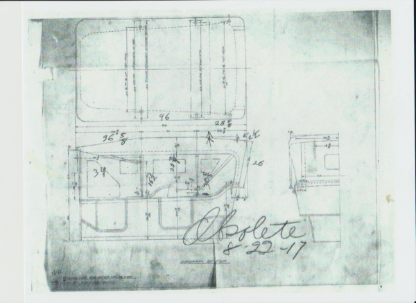

This is a ford drawing for 1912 , the amount of bow that you are going to insert into the socket depends on the height of the bow as per your drawing your mounting holes are not at body level , the drawing show the mount hole is level with the top of the body. You need an proper height of the bow before you fit the bow to the socket. you will see in the 12 pic it shows the mounting point higher than the body line I hope I am making sense . Cheers Colin

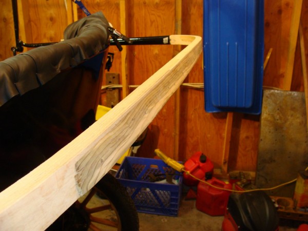

Note RV's comment about the wedge that is required for #4 bow. I'm not sure whether this is a strictly aesthetic adder, or whether this is intended to reinforce this bow. Seems logical this end bow will see more stress and therefore tendency to sag if this supplemented support wood is not in place. I made this from the same 1 1/2" wide white oak as the bows. It is both glued and screwed to #4 bow, then dressed to blend at outside edges. I saw a hand sketch of this here on the Forum, but not sure I have seen it on any of the various Ford top drawings.

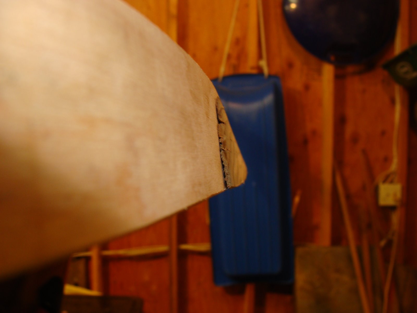

I shaped the bows to fit into the sockets using a draw knife. It is a trial and error fitting process.
Here are some pictures of the wedge on the 4th bow when I did my top:
I have some other notes I will e-mail to you.
-Keith
