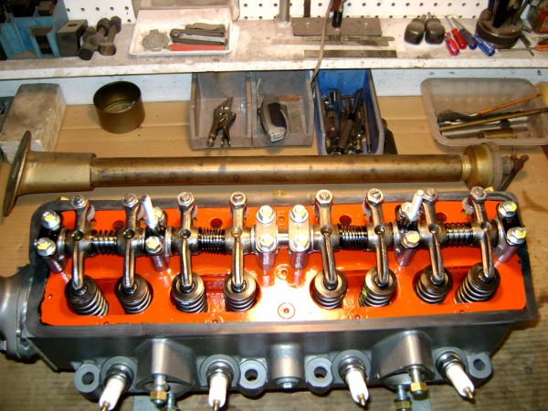

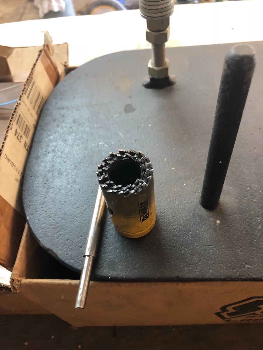

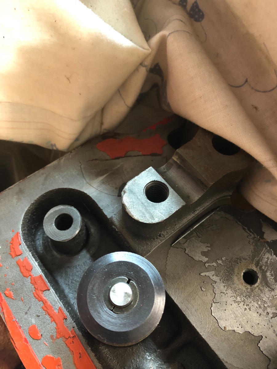

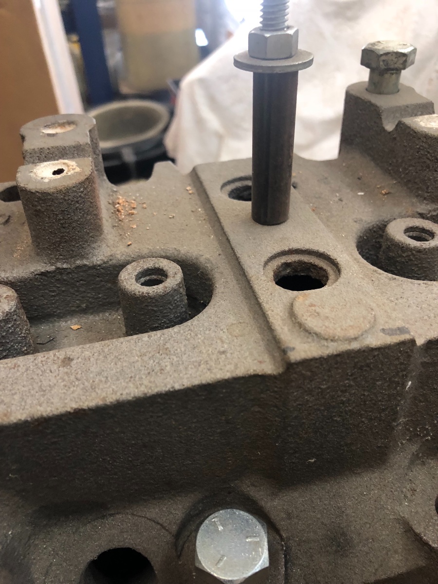

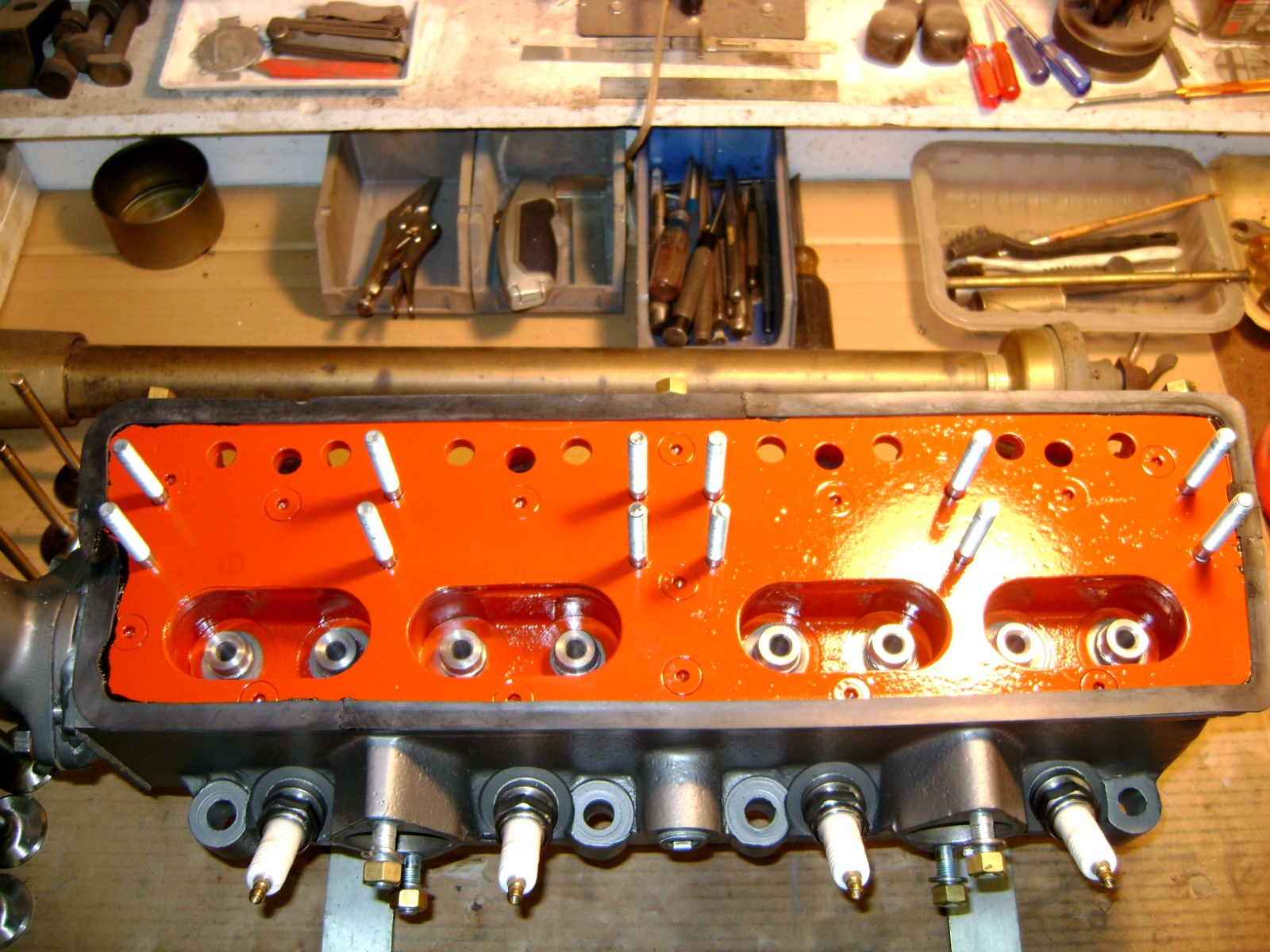

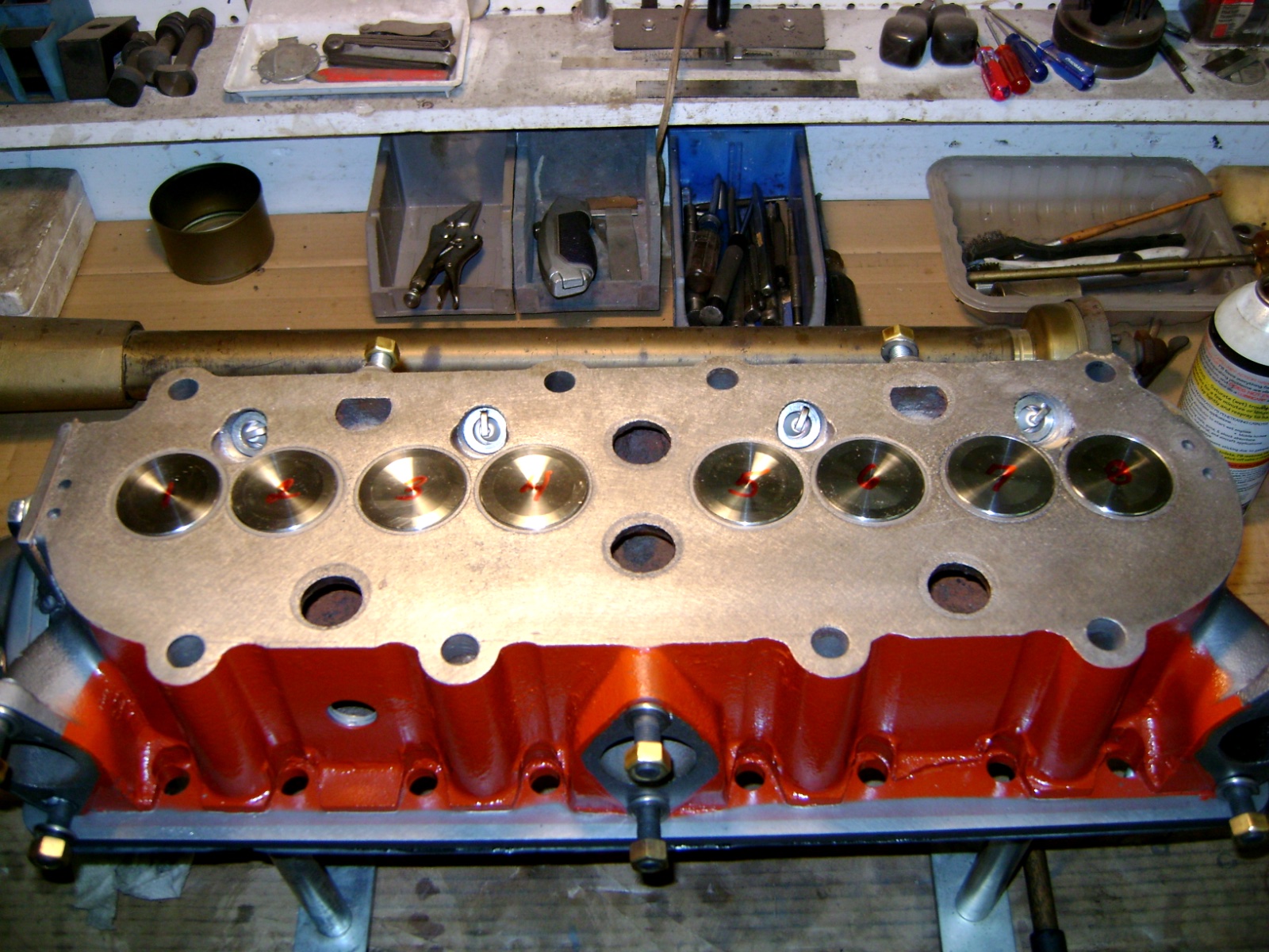

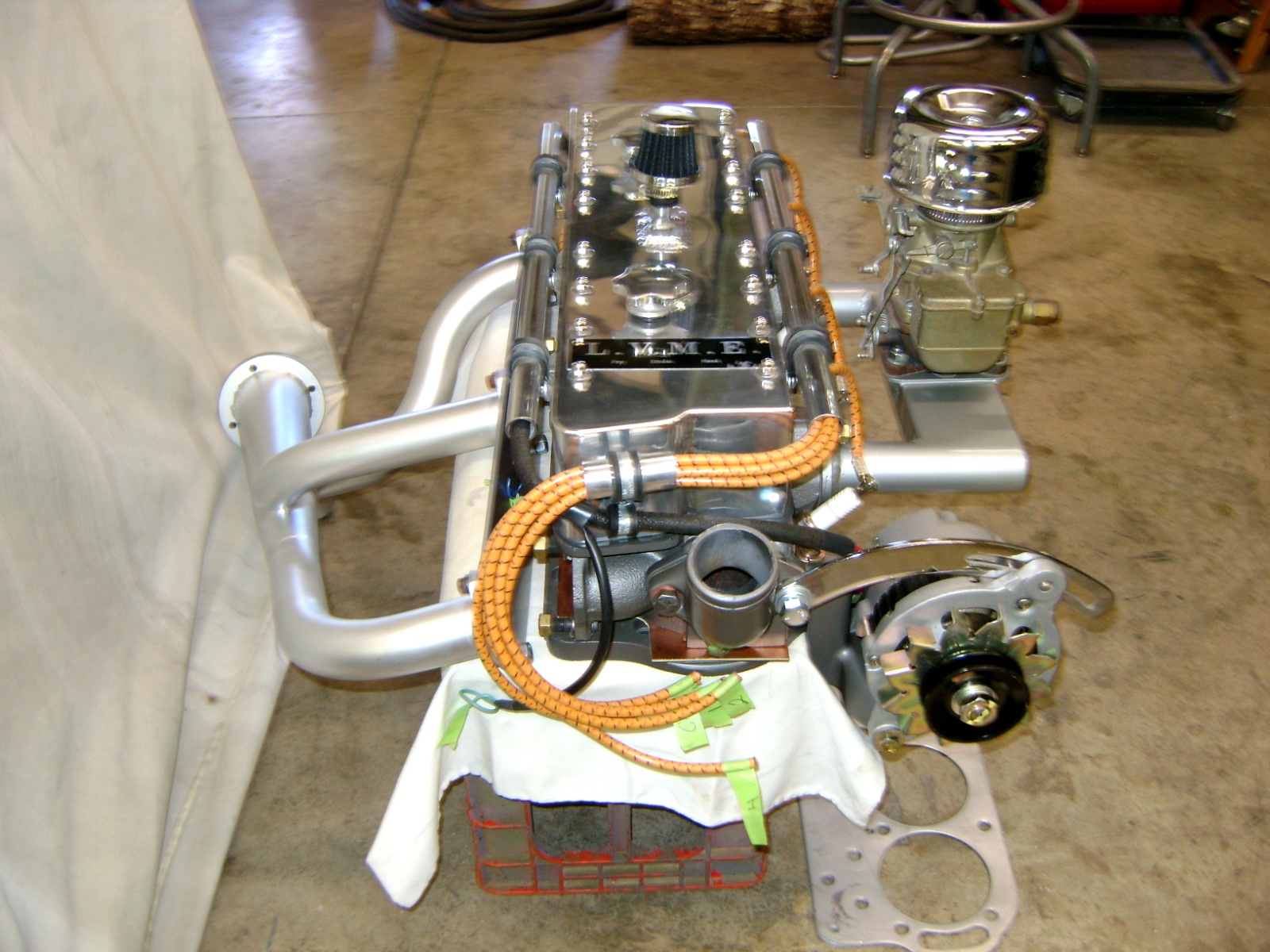

Here you go Steve,
Make a simple tool from bimetal hole saws. This will get you to a correct plumb dimension for small block Chevy valve springs.
This is a fly off with plate reattachment to change to ratio from 1 to 1 to 1 to 1.375 using a 260 cam.
Develops around 280 CFM with over size valves on the flow bench.

Thats a great help. To summarise,
- you milled the rocker stand shafts off to fit the new higher ratio rocker assembly _ what was that off?
- used the start cutter tool to take down the valve guide and fitted SBC valves? and springs?
- fabbed and fitted a funky custom built 3 branch manifold
Looks great
did you use chevy 4 push rods?
Im hanging on, i can't shut up
