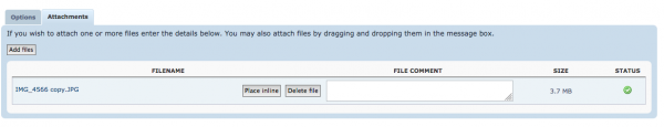

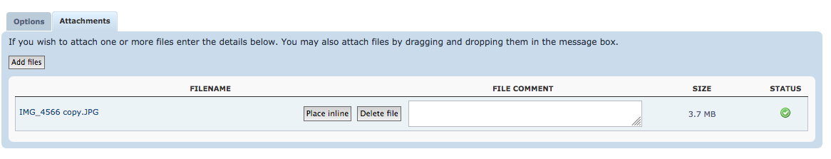

Screen Shot 2020-01-18 at 8.51.11 AM.png (10.87 KiB) Viewed 18002 times
Click Attachments.
Screen Shot 2020-01-18 at 8.51.35 AM.png (6.3 KiB) Viewed 18002 times
Click Add files.

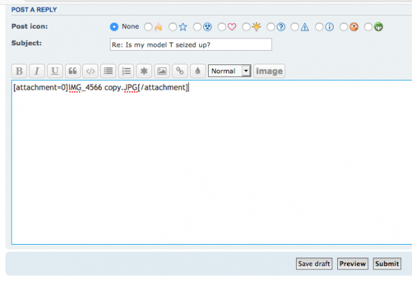

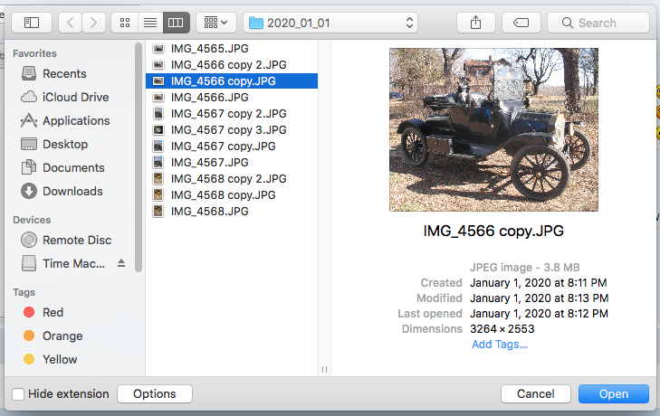

Select the photo on your computer that you want to post and click Open.
When the button appears click Place inline.

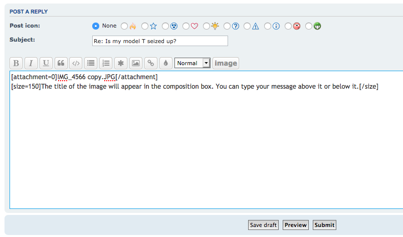

The title of the image will appear in the composition box. You can type your message above it or below it.
Posts: 7411
Re: Is my model T seized up?
Post by Steve Jelf » Sat Jan 18, 2020 10:19 am
Click Preview and you should see your image.

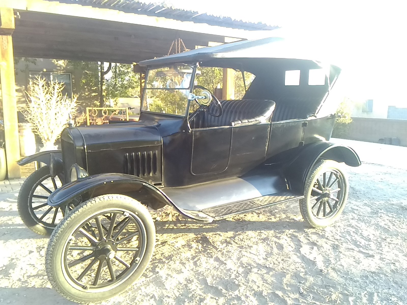

this is my t!
Mr man
Posts: 67
Joined: Fri Jan 17, 2020 6:51 pm
First Name: Carson
Last Name: Combs
* REQUIRED* Type and Year of Model Ts owned: 1924 touring, 1923 roadster pickup project
Location: Las Vegas, Nevada

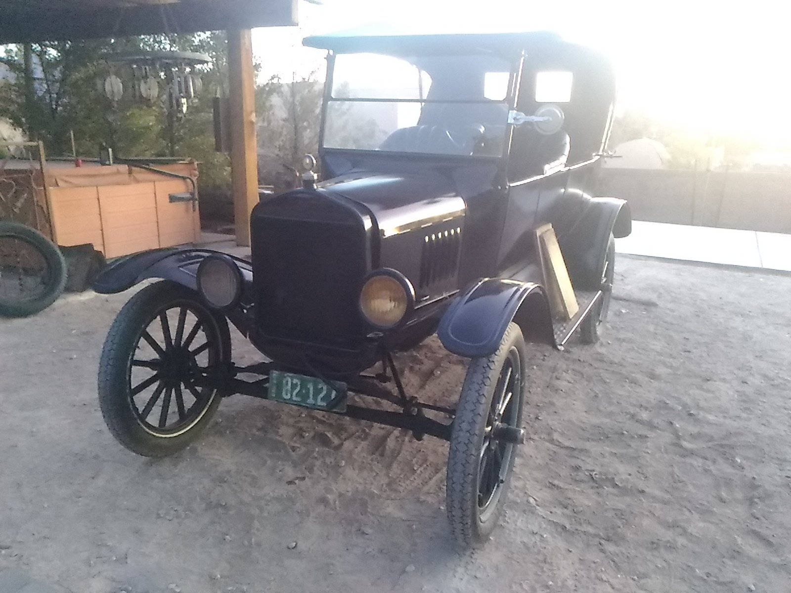

Post by Mr man » Sat Jan 18, 2020 10:25 am
Sorry a bad photo. Here's another.
Mike Royster
Posts: 42
Joined: Thu Jan 17, 2019 2:47 pm
First Name: Michael
Last Name: Royster
* REQUIRED* Type and Year of Model Ts owned: 1915 Runabout 1916 Runabout
Location: Shelby NC
Post by Mike Royster » Sat Jan 18, 2020 10:41 am
Nice car, welcome to the T world.

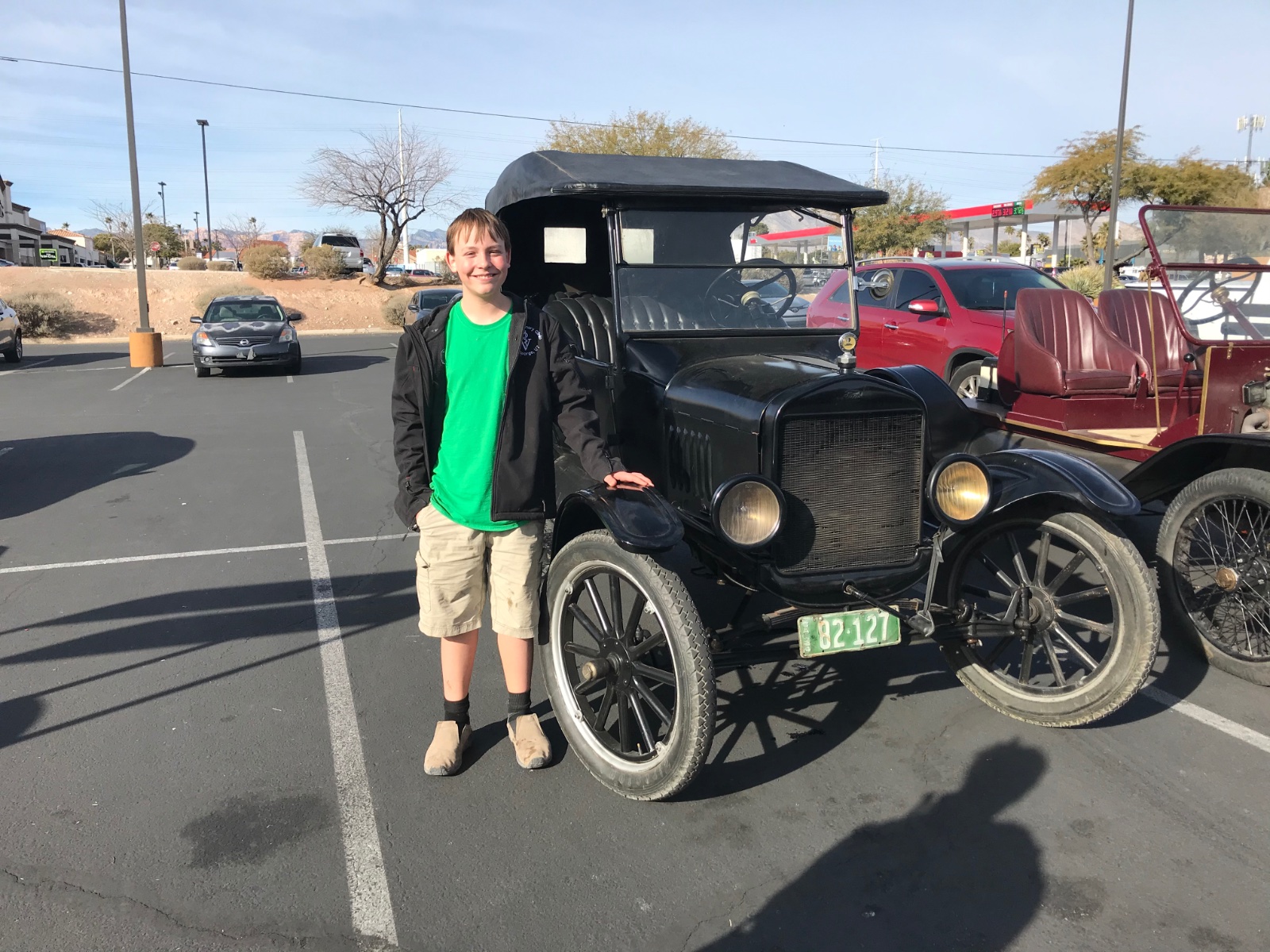

Carson and his family did meet us for breakfast and guess what......
We were all excited to see his new T. It sounds like the previous owner wanted for Carson to be the new owner. Very nice original car and Carson wants to keep it that way. He does have a few things he needs. AC brakes, he has a small drum ruckstell. I advise him to pick a gear and not shift that for now. He is also in need of two decent used firestone tires. 30X3-1/2. His generator cutout is also sticking. I’m sure he would appreciate any help. It is a great seeing how excited he is about his new car😁
