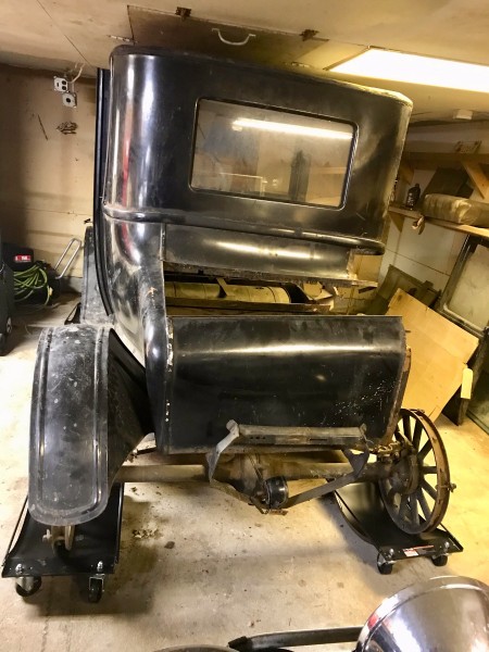

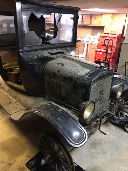

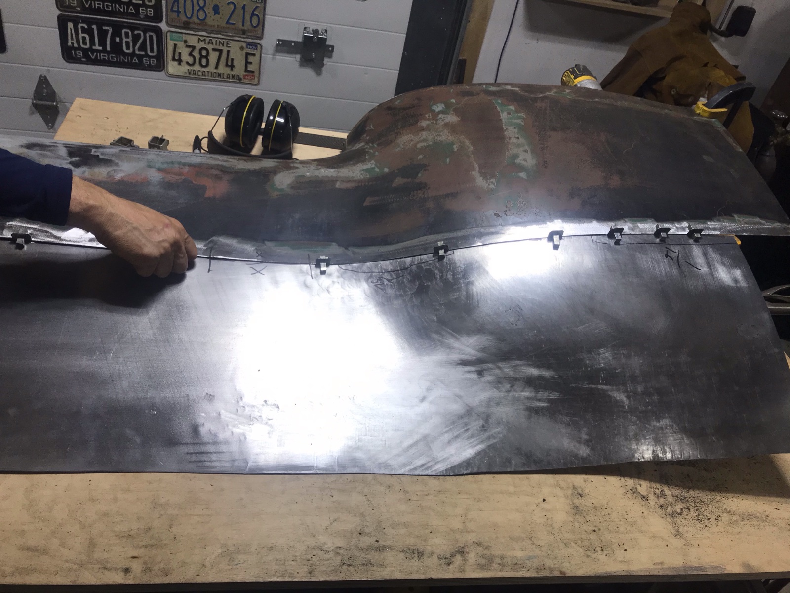

I have started work in earnest on a 1924 Model T coupe I rescued from a garage in late 2018. The find was serendipitous as I was sitting at a traffic light near my house in my Model A roadster and a woman came up to me and said, "I have a car like that in my basement garage and I want to get rid of it." I got her phone number and paid her a visit. The car had been in the house when either she or her mother bought the house in 1964. It was so buried with junk when I first saw it, I was initially not sure what it was? Once I climbed over the car, I realized it was a 1920's Model T. I took a photo of the engine number and determined it was a 1924.
I had not been looking for a Model T, but this was such a chance discovery, I decided to see if I could purchase the car. Long story short, it took about two years to acquire the car. She got angry at my initial offer, but finally a family member called and asked if I still wanted to buy it? I immediately said, "yes"!
Once we agreed, I had some old car buddies join me and we excavated the car, put it on a trailer and got it to my garage where I didn't do much for about a year while I worked on other projects.

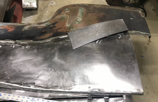

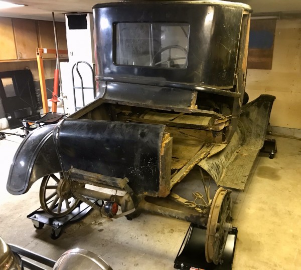

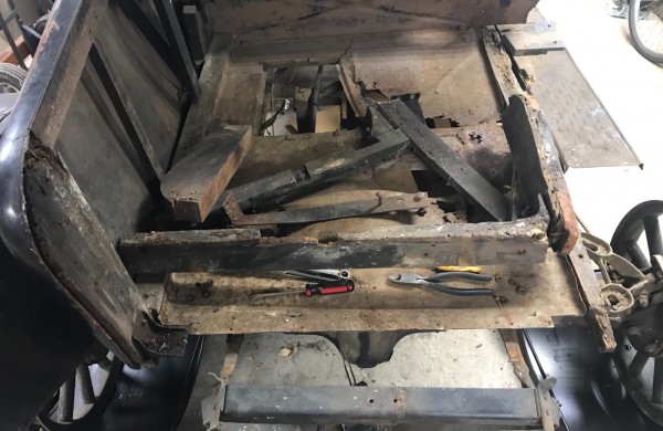

The car is in pretty good shape, but the passenger's side was disassembled to replace some wood and repair the rear quarter panel. The car came with a 1919 door which I was able to sell to someone in Colorado for their project.

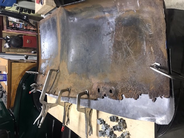

The quarter panel that had been removed had significant rust up about 4" from the bottom. I found another back coupe body that I purchased as the panel on that body, while rusted, was much better than mine.
So far I have purchased a new trunk floor panel from Howe's, done a slight carb refurb and removed the gas tank to make sure the sediment bowl is clear. I also removed the old rims with tires and dismounted the very old tires. I have bought new tires, but need to find two rims. The spare was missing and one rim is missing part of a clamp where the rim splits. It has 21" wooden wheels that mount using Jaxon lugs.
The last few weeks I have been disassembling my spare coupe body so it takes up less space in the garage. I have listed my extra body parts for sale here and on other forums, as I don't need them taking up space in my garage and when they might be useful for some other restorer.
I hope to get the car running in the next few weeks.
I have some salvageable wood from the extra body. I plan to order the wood parts I need from Fordwood within the next few weeks.
In addition to trying to get it to run, I hope to start work on the body panel that needs repair. My intention is to do what I need to do to get it drivable and safe. I will only do the body work and wood replacement that it needs. I don't have a lot in the car so far, but there is quite a bit of work to do. This is my first Model T and most significant project I have undertaken. I will post progress, questions and photos as I go. I hope to post some "as found" photos as you have to see it to believe it.

It’s a 24 by the looks of it. I have one just like it. It looks like the passenger side wood body pillar that sits on the main body sill is either broken or rotted out. Could be the body sill is deteriorated and the rest of the body pillar dropped down. Go to Fordwood.com and take a look at the body wood structure of a 24 and you can get an idea of what the wood structure looks like. They make the wood pieces for your car BUT they are slow in replying if you email them.
If you have space you can remove the fenders and splash shields, Then you can put 2 saw horses under the car, raise up the body and then roll out the chassis and go through it to get it in driving shape, restore as best you can the body and put the body back on the chassis. That’s pretty much what I did with mine several years ago.
I would suggest looking at the wood body structure though. It will give you an idea of what you are up against if the wood is to far gone to repair. Good luck and take your time!

The wood is a mixed bag. Driver's side is good, doors are good on both sides. Most of the passenger side needs replacing although some may be able to be repaired. I have looked at the Fordwood site and I know what I need.
My plan was not to remove the body, if I can get away with it, but repair and replace with the body on. I know I have my work cut out for me. Easier to buy a better car. I may have the same money in it when I am done, but I am up for a project and would like to save this one if I can. Maybe I am crazy, but we old car guys are all crazy to one degree or another.

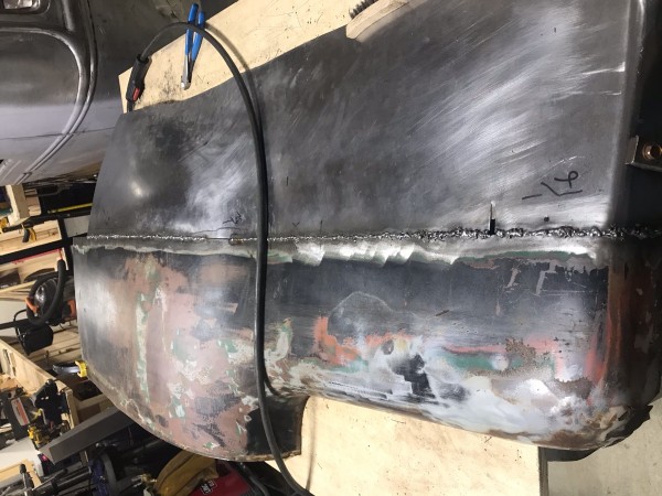

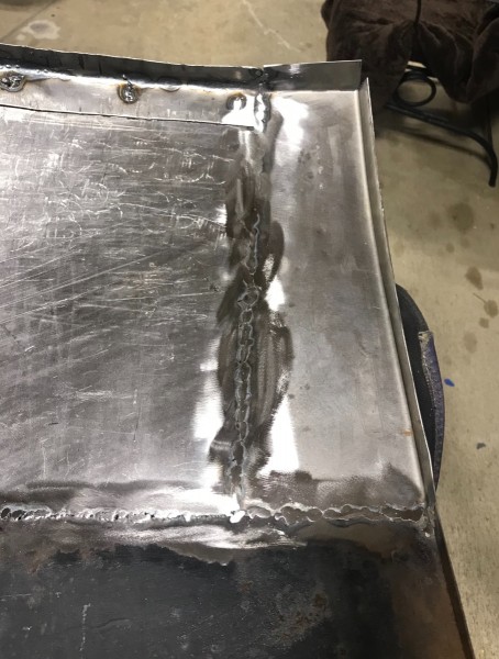

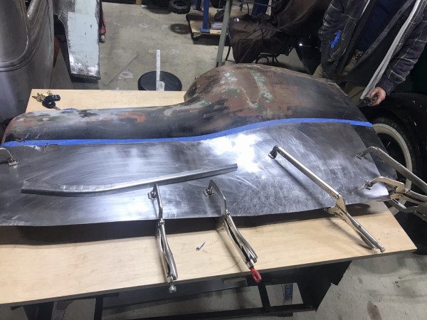

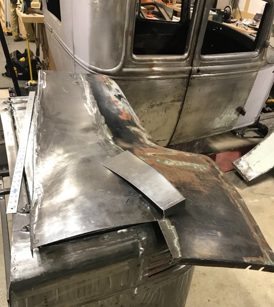

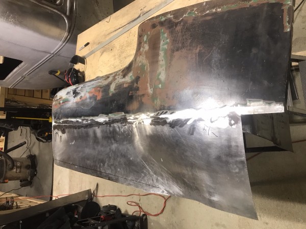

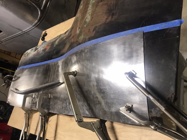

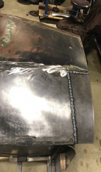

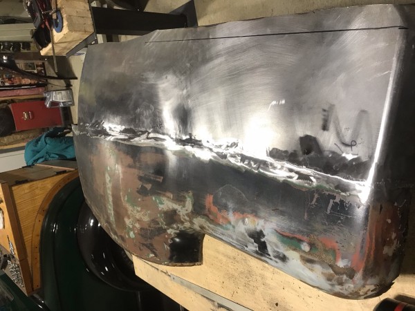

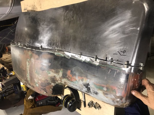

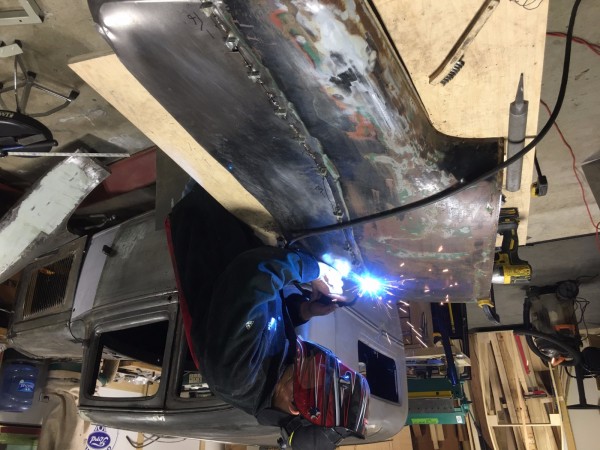

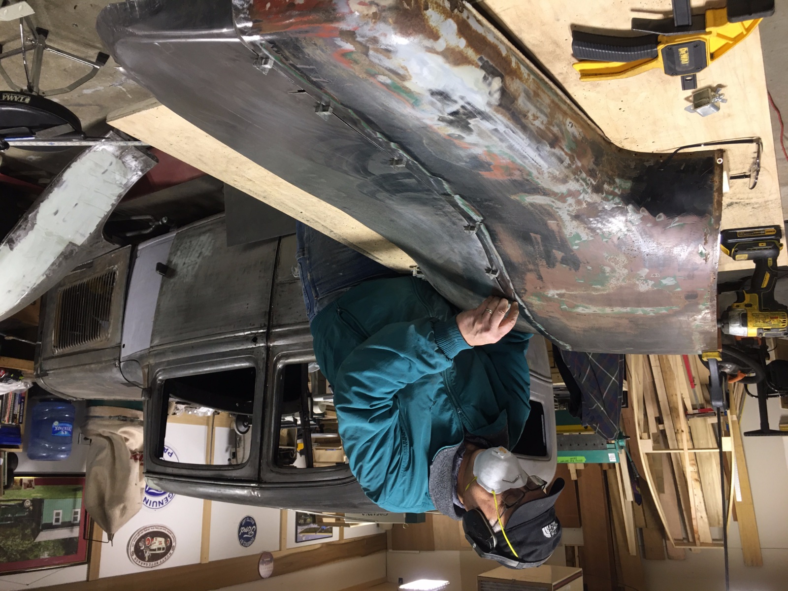

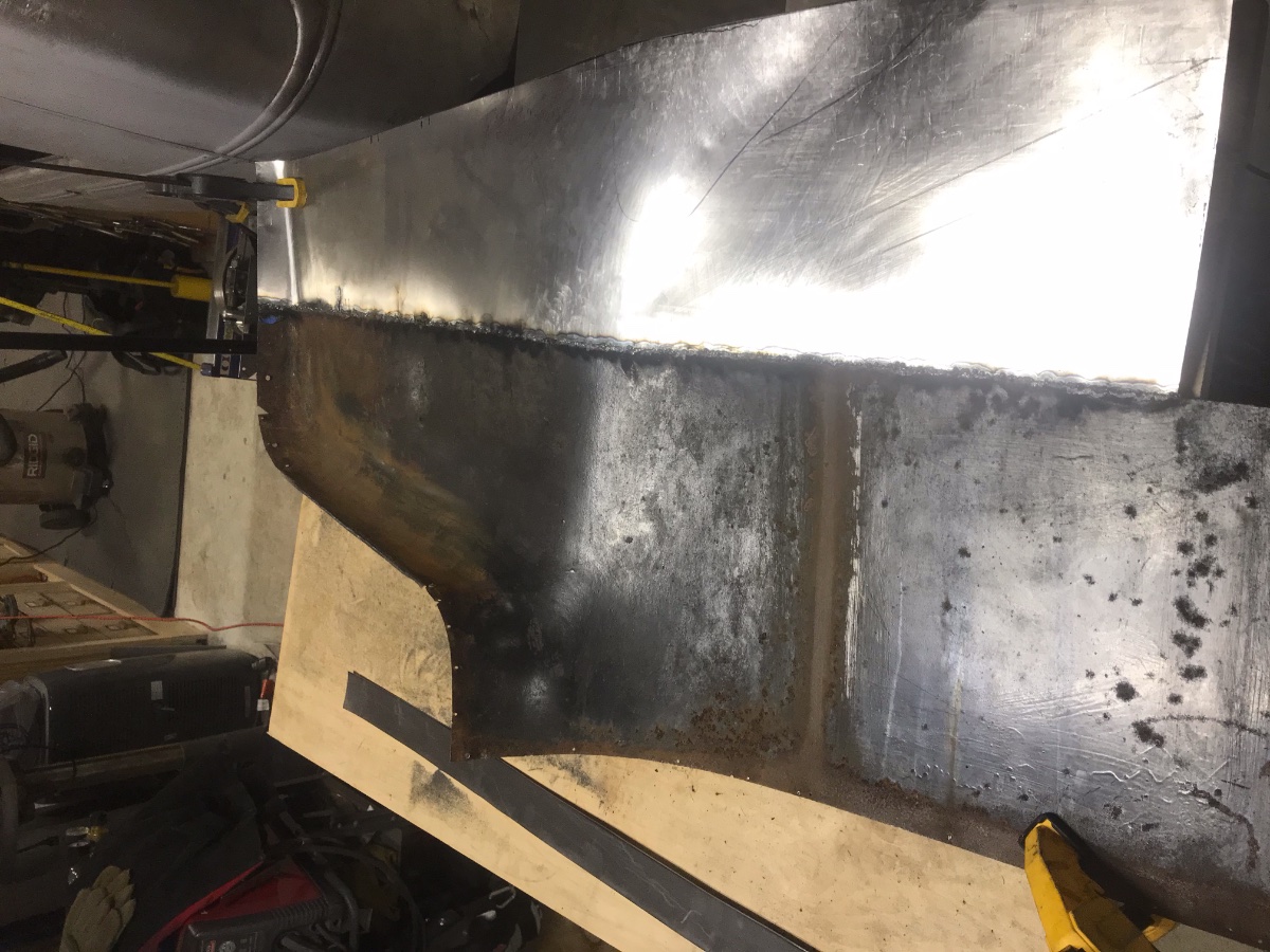

A friend from the Model A club (I have two of those) and I started to make a repair panel for the passenger side quarter panel. He has an English wheel and has some experience. I had assumed that it would be very difficult to make the panel, and it may well be, but we made amazing progress in about three hours of work. I don't have a pic of where we left off, but it is conceivable to me that we could finish it in a couple of sessions. How good it will be remains to be seen, but that will depend upon final finish. It seems doable to me.
My engine number indicates an April 1924 casting date, so maybe a May construction date? That doesn't seem like late 24 to me, but what do I know?

The last two weekends I have spent fabricating the lower passenger side quarter panel for my car. My car doesn't have a lot of rust through, but that panel was very bad and was taken off of the car. I wondered how to fix this, but a fellow Model A club member has an English wheel, stretcher/shrinker, welder and some experience, so we set to work. I have been amazed at how we have done! I worked about 5 hours today and three or four last weekend. I could not have done it on my own.
I have not welded since 1974 and from my welding job, it looks that way. I never really did any MIG welding in my prior welding career, so this was new to me.

I have kept at it over the last few weeks. I got the wood plans in the mail from Ron Buckley. I have barely looked at them. I have done some more work on the panel I am repairing. Last weekend I added another patch panel. A couple of weeks ago I removed the back panel so that I can repair the rust on that panel and figure out what wood I need to replace. A pending project is address any rust that might be in the gas tank. It looks good as far as I can see, but I can't see much. There was some rust rattling around inside. I will put some gravel or other material in side and rattle it around to see what comes loose.
I am having a great time with this. I especially like the body panel fabrication. Who knew I could do such a thing? My welding skills are improving, as well.
