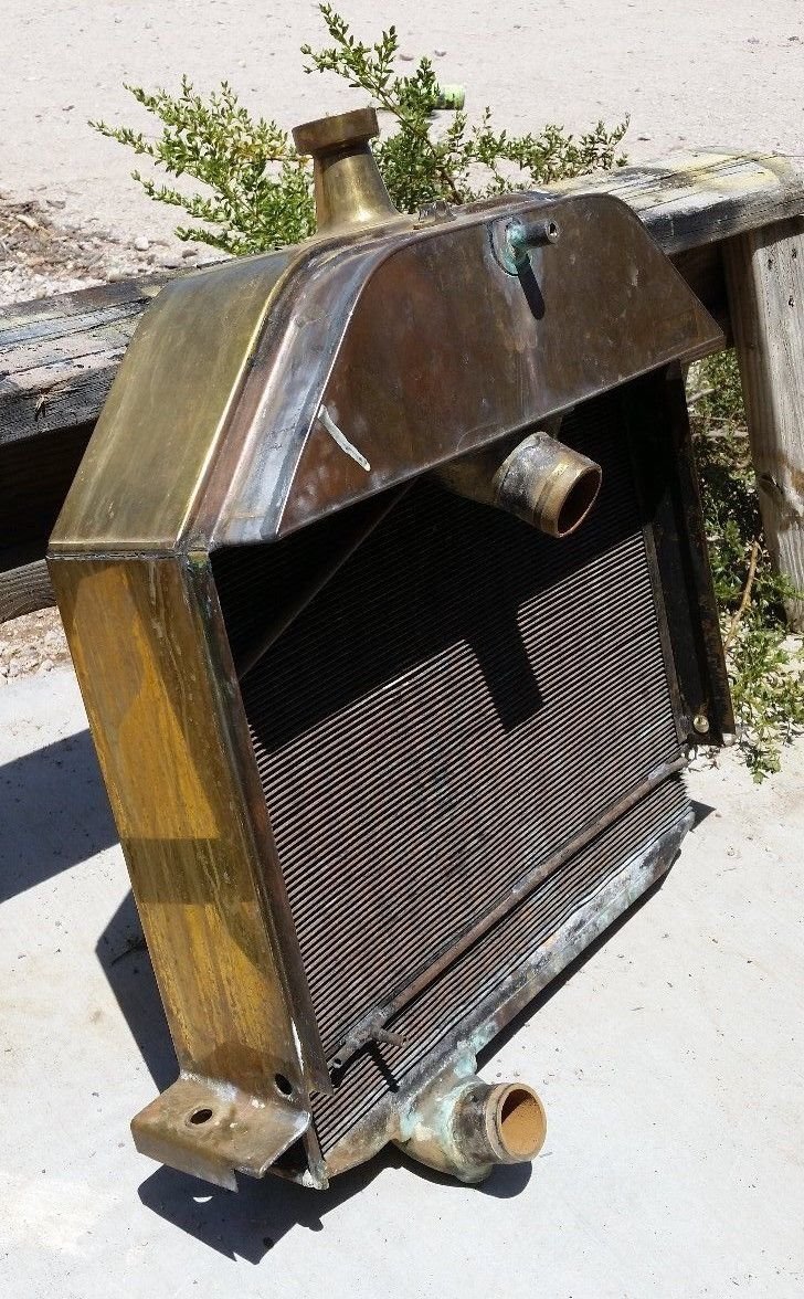

I believe the 1912 gas line along the frame is about the same as the 1911, however by 1912 they had begun to use the cross-over tube that was attached to the radiator. From the cross over tube to the lamps would just be the red rubber hose.
Here is a 1913-1914 radiator with the cross-over tube:
Note the holes in the side panel used in 1913-14

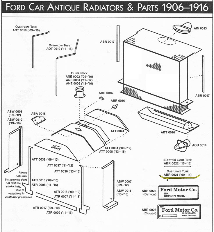

Here is a diagram of how Brassworks makes their brass radiator:
The 1912 radiator does not have the holes in the side panel.
(The note about the gas light tube used from 1909-1914 is incorrect. It would have been only 1912-1914. I have no idea if the gas light tube that Brassworks makes is accurate or not.
