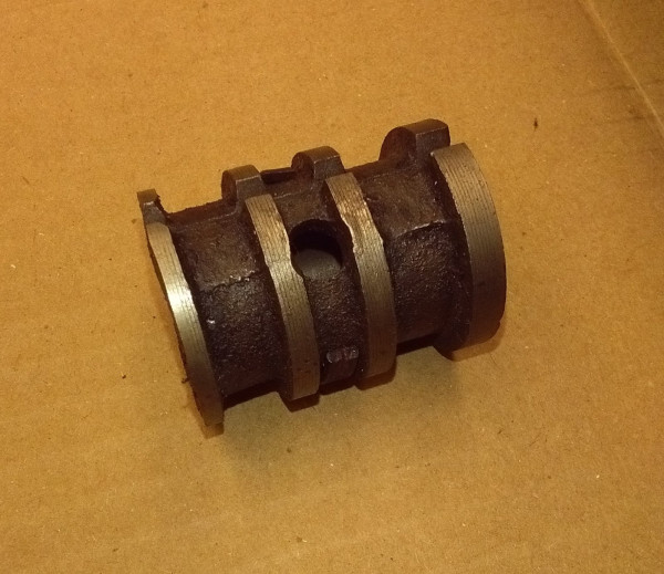

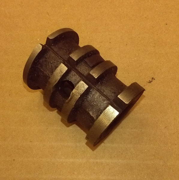

I will try to dig out an example of the style that John refers to above. On Edit- here are a few pictures of the true early cam bearing. This bearing has had the rear side ground off at some point (on the left in the pictures) so it appears shorter with the notch removed. This is the only example I had. The clip was still used in the center groove to hold the shells together.

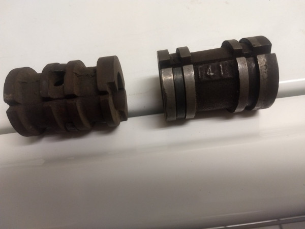

- Posts: 4960
Re: 1909 Camshaft Bearings...
The one on the right, I suspect is earlier.
You can see the part # in raised cast. T41 or T411.
Note there is 2 ring groves. One on each end. Only one ring installed.
Maybe some of the guys that work/have worked on early motors can tell us the correct years they were used.

Now those two bearings, are they both fronts or is one of them a middle? If it's not a middle bearing, would the middle bearing be like these but just a bit longer with those thin ribs and not like the later one which are a bit thicker. Also would they have two clips or just one like on later models?....I think what I'm going to do is draw both of those, put them in the drawing and let you guys tell me which one is correct, because I really don't know and I'd hate to go with my best guess, so I'll defer to you folks who may have either seen, worked on or have one of these cars or engines.

Martynn- the one I posted the picture of was a front bearing. The non-modified end has a large radius on the bore on one end as do the later front bearings. This radius was necessary to allow clearance for the radius on the front cam journal adjacent to the flange. Too bad the one I have has been modified on the rear side......
