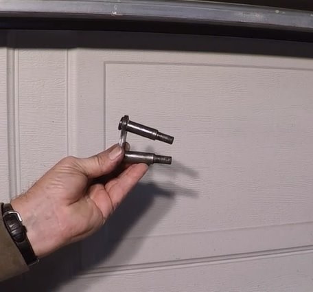

These new fangled spring shackles wear funny
I know I should be glad that these are available but I really should have ground some of the serrated edge off. When it touches the spring or perch they tend to bite & then the shackle itself wears in places that it shouldn't.
Thinking of re-making the worn parts in 8MM steel rather than the 5.5 MM they're currently made from.
The moral of the story is, if you haven't examined your spring shackles closely lately, it might be a good idea to do so.

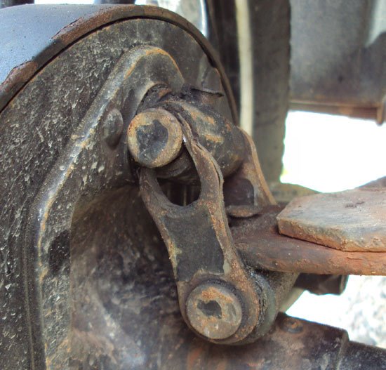

Re: These new fangled spring shackles wear funny
I'm only two years into Model T's but I could see, even with my novice eyes, that those new repro shackles were no bueno.
It took me a while, but I found a good set of used original Ford script shackles that'll be installed this weekend. They're not perfect but they fit nice and snug inside the brand new bushings I bought, so I'm happy with them.
I've heard the repros that Chaffins makes are also good. As soon as my car is finished mechanically, I'm going to buy a complete set of everything that will wear out on the car and stash it for the day when all these suppliers are gone. And...a set of Chaffin's shackles is on that list.

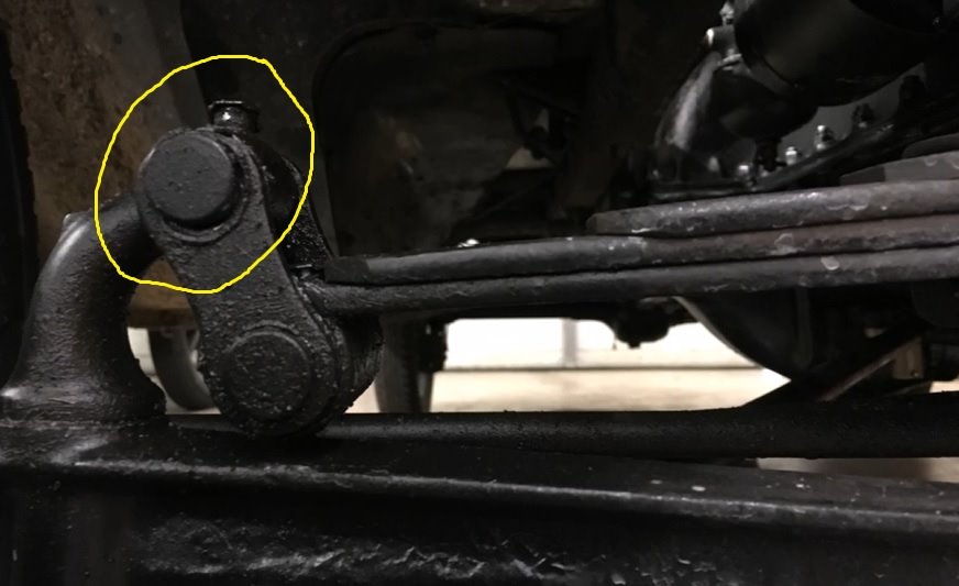

My car developed erratic steering problems 2 years after a complete front axle rebuild. At the time of the rebuild I saw no need in spending the extra $ on the forged type shackles, so the new ones that I installed were the less expensive stamped type with the knurled pins. Upon inspection the wear of the end plate was easy to spot. This wear, created lots of "wobble" in the pins allowing the camber to constantly change depending on the road, bumps, and contour of the pavement. New forged shackles were installed and good steering was restored.

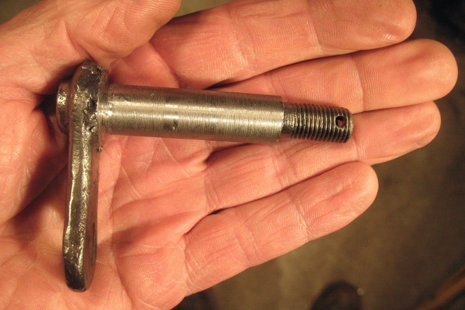

So what would happen if you welded that pin on a new repro set?

Welding the knurled shackles would be a help. Big problem with repro stuff is that you cannot know what grade of steel was used. I would hazard a guess that the knurled design with an acceptable alloy would still be a problem past a certain amount of stress and use.

One wrap of aluminium welding wire seems to space them out from the bushing far enough that they will not present a problem. For now.
A washer would be better.

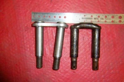

- Posts: 7275
While not plentiful, L shaped shackles are to be found. GOOD usable ones are a rarity. Re-building the L shaped ones is not too difficult if you have a mig welder and access to a lathe. I made a tool to hold the welded shackle in the lathe. It is simply a short length of old T rear axle with a drilled and tapped hole in one end into which the shackle thread is wound, until it bottoms out on the shoulder on the shackle. I then use a centre drill to make a relief in the outside of the shackle, and the shaft is turned down between centres. When done, the relief can be filled with your choice of goo.
Hope this helps.
Hope this helps.

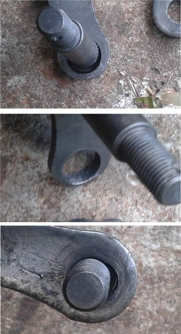

- Posts: 4084
Those two piece repro shackles perhaps aren't hardened either.
Tried using on the rear for install, the spring was being pulled in place to fit, the other side slipped a bit, and bent that repro shackle as it slipped.
Never had that happen with Ford forged shackle.
So decided then to refrain from using the repro.
Must be something to that soft repro, as this photo was on the old site a few years ago, soft metal worn by the serrated pin.
One of mine did the same thing.
