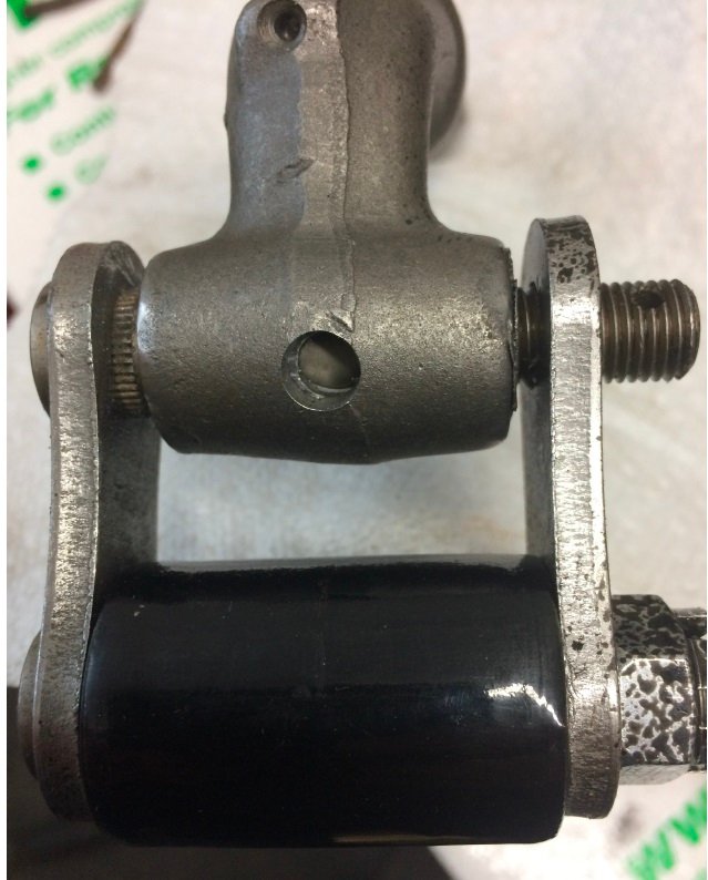

banjoe, post a picture of the perch so we can see what maybe up with the front spring

Hi Harold, I'll get to the workshop and take some photos of the perch to help illuminate the problem.
Should be able to get this sorted out tomorrow. ..... and thanks for that suggestion.

Still trying to post pictures of the spring & perch differences

- Posts: 6396
Re: Front Spring Width
I extracted the photo o make it easier for others to see.
- Posts: 6923
I buy off-the-shelf bronze bushes rather than the rolled steel standard issue. They are all 2' long, OK for the rear, but I have to turn them down for the front. It would be easy just to turn a bronze bush down to 1.75 " to keep things in line.
Hi Allan FDU,
Aha, a 1 3/4" bushing would bring the shackle into alignment and eliminate spacers, wouldn't it? I would have to replace the bushing in the A spring as it's 1/4" too short as well and sunken into the eye. (that sounds painful).
I'm going to visit the frame and tunnel out in the snow to see if I can get some meaningful information on the front frame crossmember and hopefully figure out what sorcery took place to make the larger spring fit. Depending on that, it may be best to stay with the change they made so many years ago.
It does have me wondering what this 1927 went through in its early age. It's now 93 years old and I've owned it for 56 of those years so that meant that, before me, it had 37 years of dramatic life and boggled repairs. Must have been quite an experience.

Another picture showing the shackle space.
Can you have the spring eye machines to the right width? No spacers and unoticable if done right. Just thinking.
Now that you mention it, Dallas, Perhaps the spring eye could be machined down the required 1/4" so that the shackles will align properly. Would have to be done with 1/8" on each side to keep things centered but this could be a winner.
Still have to address the frame mounting issue and it will take a close examination to see what was done and if it's usable or recoverable.
