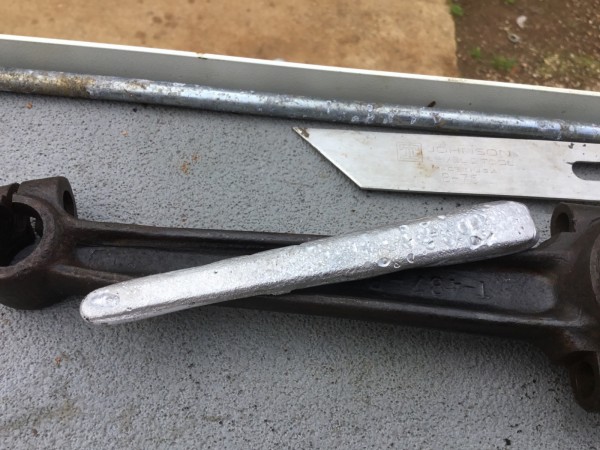

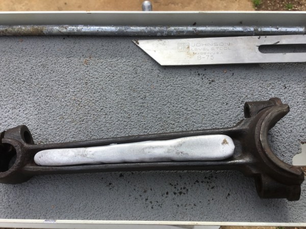

I use these sticks to tin with, poured in a cold rod they always look like this on the back. I do not tin, but I
always preheat the block and mold.

Bob, that is a great way to pour the tinning sticks!
I used to pour the babbitt onto a length of angled aluminium but I think your method is more appropriate for Model T work.
