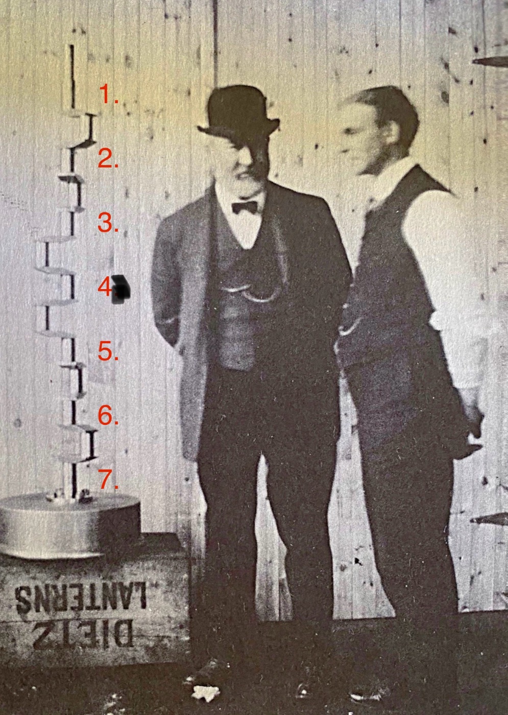

Below, FMC President John Gray and Vice President Henry Ford beside a Ford six cylinder racer crankshaft.

The early engine builders likes long bearings of relatively small diameter. That made for a very long 7 main, 6 cylinder crankshaft. I suppose the preferred long bearings for lots of surface area and relatively small diameter to reduce surface rubbing speed at the bearings.
