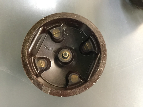

I know it’s not easy but Iam looking for parts for the American Bosch distributor. Type T-448. Manly the distributor cap. Part#65942. Also any surviving information books on the distributor. Thanks

I have a cap in a little better shape than the one pictured. In the past I have used the drive & adapted to a 009 Bosch distributer Then if wanted can go to Pertronics electronic ignition.

Be careful. Caps for Bosch front plate distributors are not the same as caps for clip-on style distributors.

thanks for the heads up! I’ve been doing research till Iam blue in the face. Is this cap one for a clip on? I noticed a different part number and manufacturers logo.

I believe the one shown by Sir Tim is for a clip-on. Notice how yours has a "male" locating lug, versus Tim's which has a groove for location.

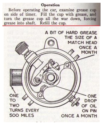

Looking for the oil cup for the distributor shaft. Attached to the outside of distributor housing.

It is not an "oil cup" but a "grease cup". Grease cups are designed to push grease into whatever

Post by Bryant » Thu Aug 18, 2022 7:18 pm
Here’s an example
I did see the clip on Bosch had the grease version. This distributor has to travel through an empty space about an inch. I think it may have had a wick. Thanks jerry for the pictures

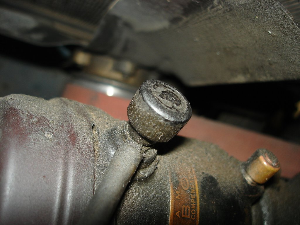

Here's another part to look for. It's a rare find though. Hard to make it out in the photo, but the thumbnut has the "AB" American Bosch logo cast into it. Obviously not a necessity, but kinda cool if you can find one.

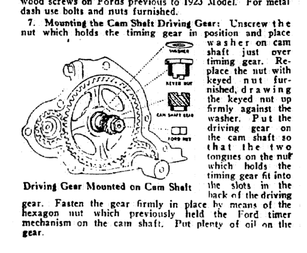

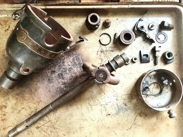

Trying to find the cam and distributor shaft gears for this unit..
Still looking for the oil cup

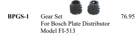

Chaffin's Garage, page 47.
A little cheaper at Lang's...
https://www.modeltford.com/item/BO2.aspx
You might need this too?
https://www.modeltford.com/item/BO-LN.aspx

Hope this helps Not sure what the difference is in Models "Type FI-513" and "Type T-448"
Whats the issue with the cam?
The conversion PDF discusses some measurements and options.
Instructions & parts list FI-513.
1923boschmaginstmanual.pdf
(419.76 KiB) Downloaded 110 times
from the above
from your earlier post T-448
Points & your missing parts look the same as a Model 600

Thanks Jerry! I think I’ve seen those before but wasn’t clear if they where for my distributor.
Thanks Frank for all the good info! The gears I have look to be repaired and I don’t think I will trust them.
