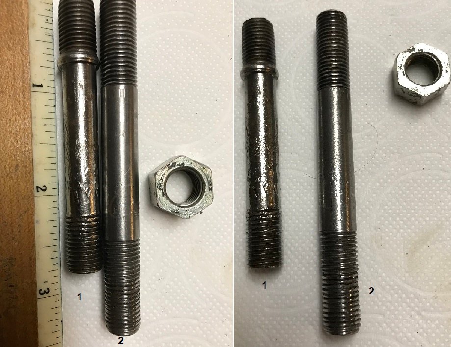

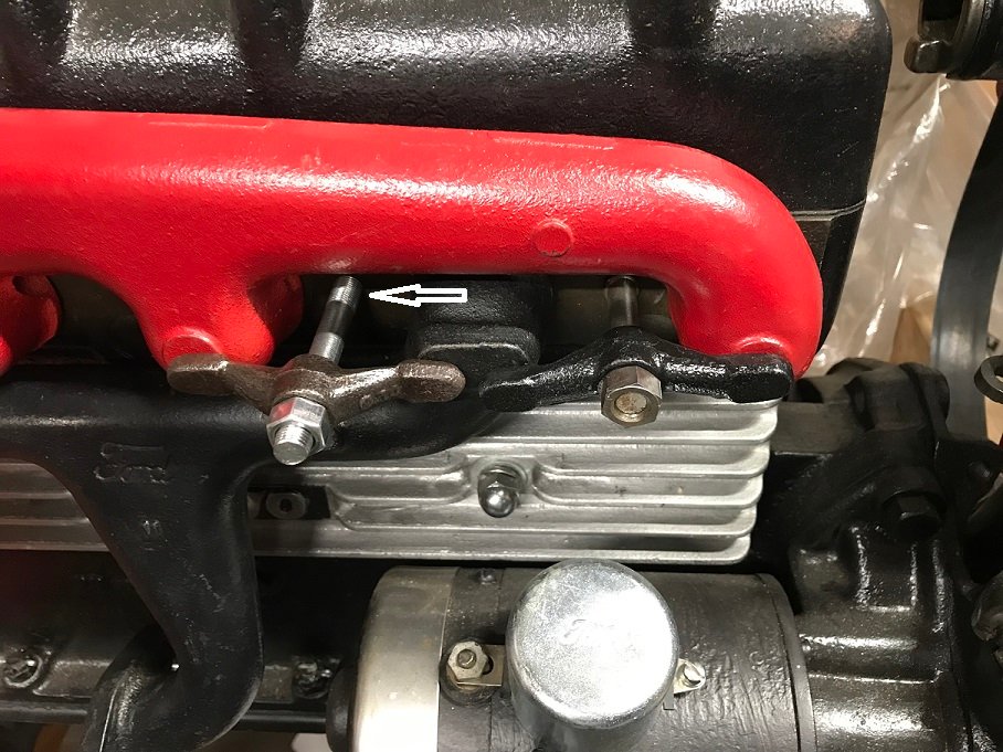

I need one manifold stud, the kind threaded on both ends, of coarse I can't find my old ones, I have bolts on there now but think I could better fit the hot air pipe by double nutting the end of a stud.

One end of the 1926/27 (maybe 1925 too) would be sedged to form a ring above the thread, to keep the stud from going in to far and to help lock it in place.

Re: WTB: 1 manifold stud for my 1927 Tourung
According to Lang's and Snyders the shoulder ended August 1926
Looks like maybe I need one from 1909-23, I see now that Langs has them
I have many of each. shoulder & without. I’ll email you a picture so you can. match. later too night
The longer stud has enough threads on the block end for a nut & washer. The short stud with the stop requires the the clamp to be inverted. I also have some of the earlier short ones without the stop. -- --
