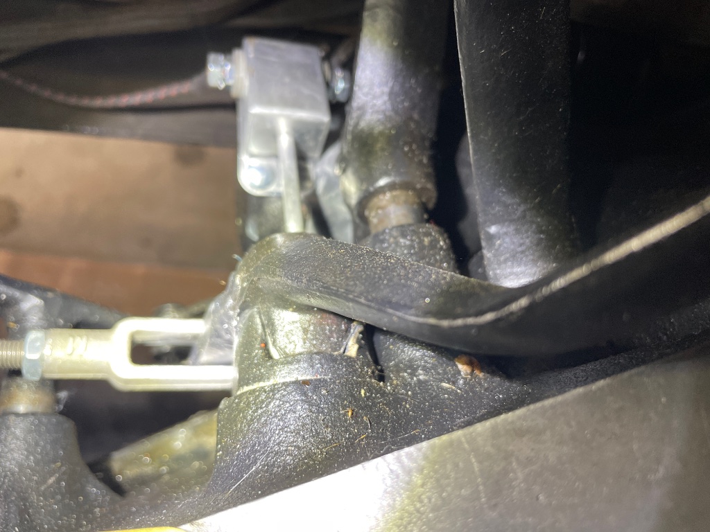

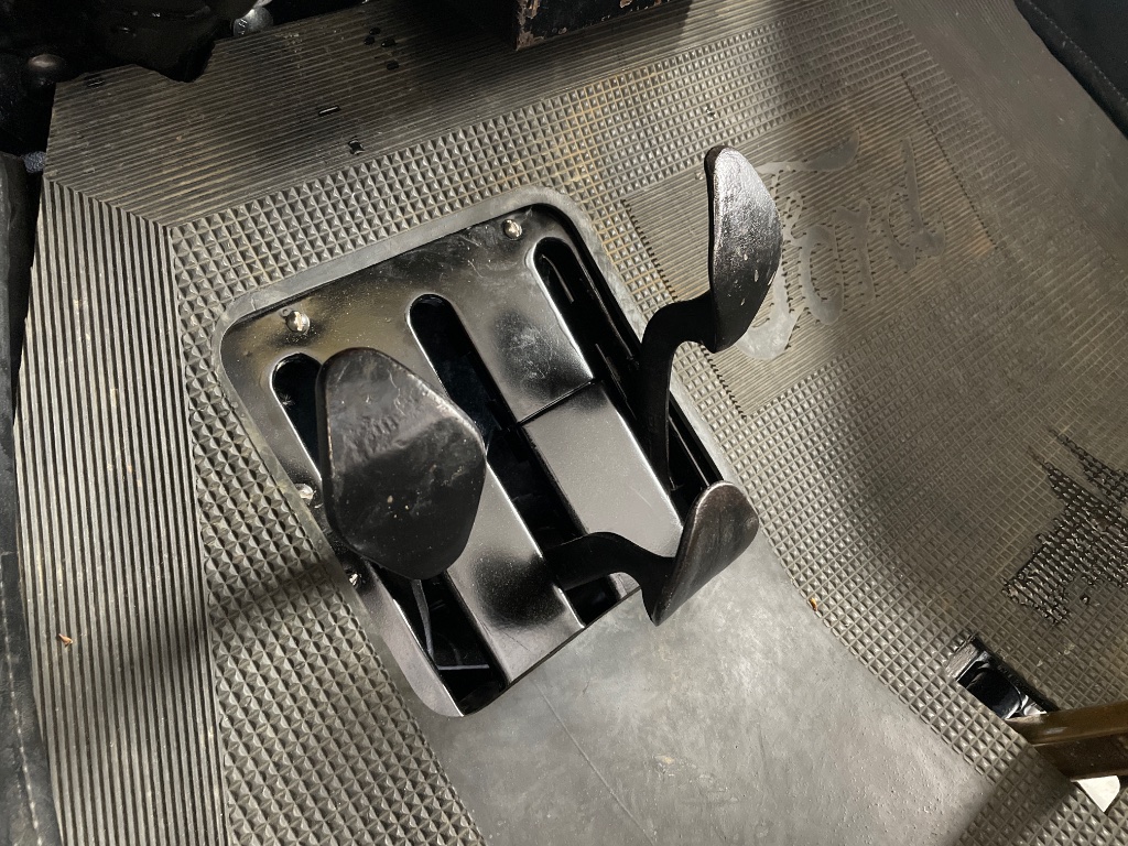

Re: Kevlar band adjustment tips?
Thanks Scott. The reverse pedal does not sit lower than the other pedals at rest. I adjusted it so that the reverse pedal engaged fully when it was just a bit lower than the other two pedals when it was pressed. You can see the pedal at rest with the parking brake on in the photo attached.
I don’t have a lot of play on the pedal shafts and the hey don’t leak a noticeable amount of oil. The cams don’t look worn and start to cam pretty quickly and hen depressed. You can see the out side cams below.
Deformed bands would be a pisser. Only way to check would be to pull the engine.

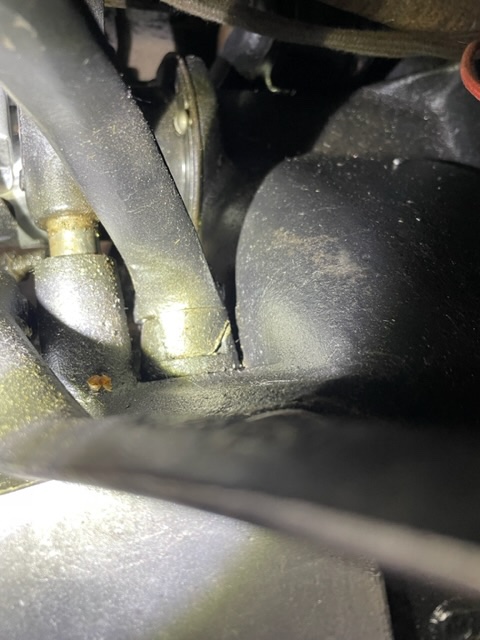

Reverse pedal and cam.
The cam surfaces on the low and brake look ok to me…
I backed the low pedal adjustment off half a turn and it’s not dragging when the brake lever is back half way. I have free neutral and can roll the car in that position.
I am concerned about brake and reverse bands dragging.
One more fun thing to consider. The floorboards in the car are new and were made off the old ones that were in the car, which were not original. It’s possible that the floorboards are not made correctly so that 1 inch from the board rule does not work.
