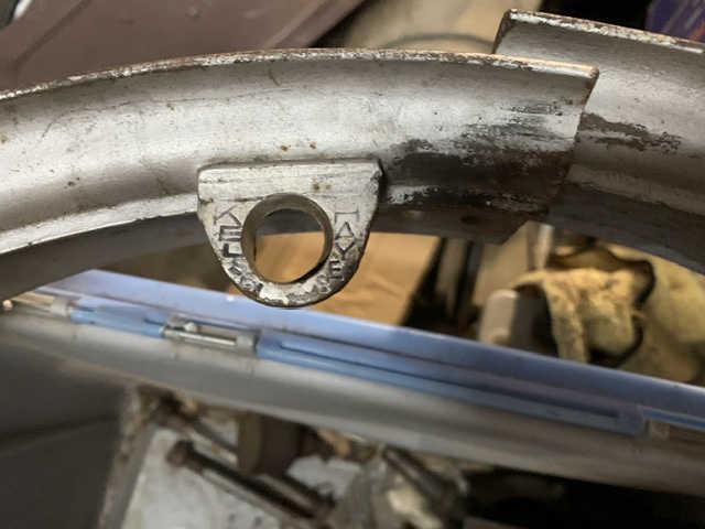

Allen I used to think that too,till I came across this.
May have been made after the T was just a used car, but it was made. Dan

Wonder if that was a replacement rim made after the merged in 1927?

Most likely is. But they were made. Dan

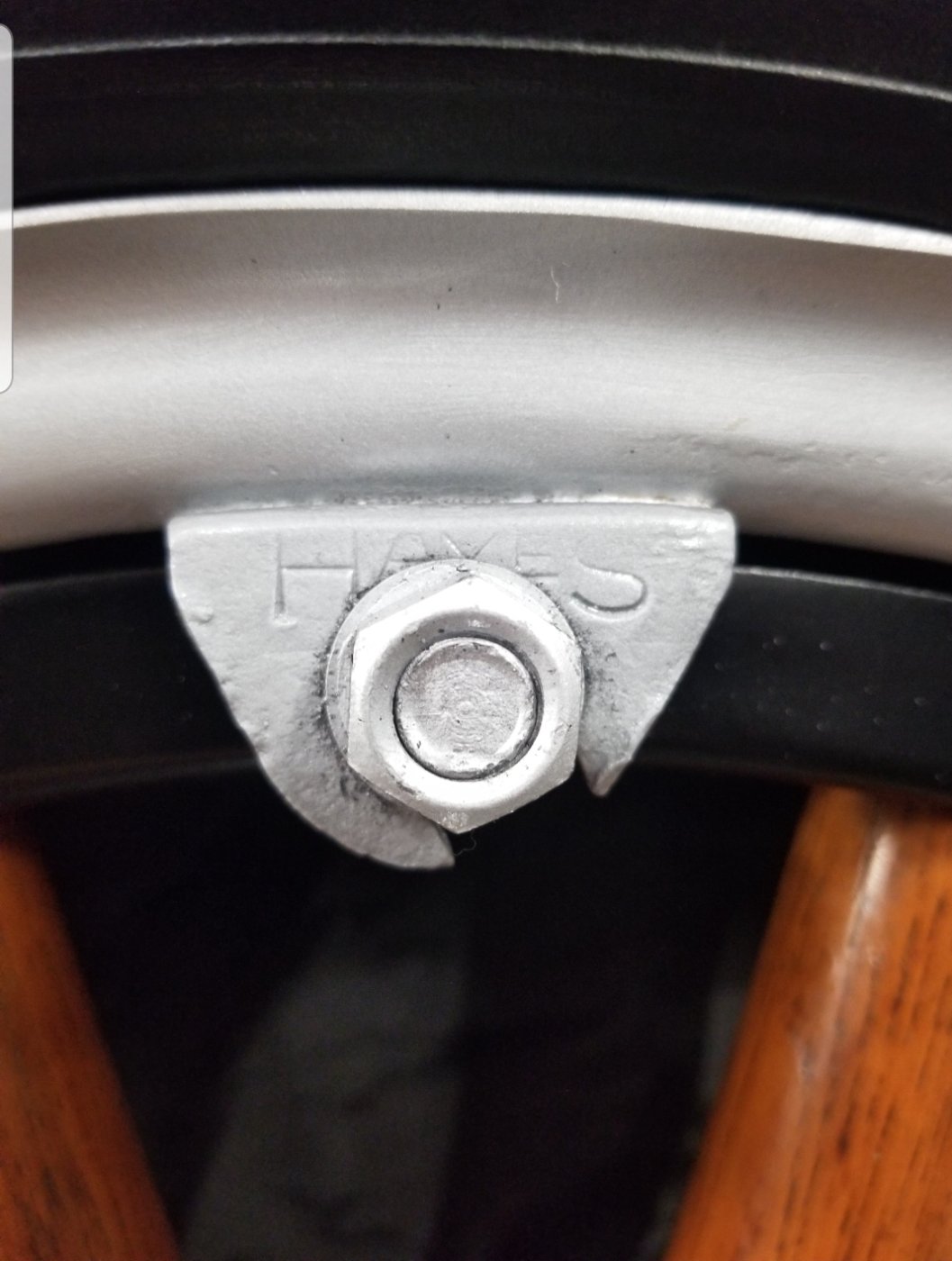

Mine say Hayes across the top above the hole. I assumed they were referred to as Kelsey Hayes.
So if they are just Hayes, that's what I'm looking for.

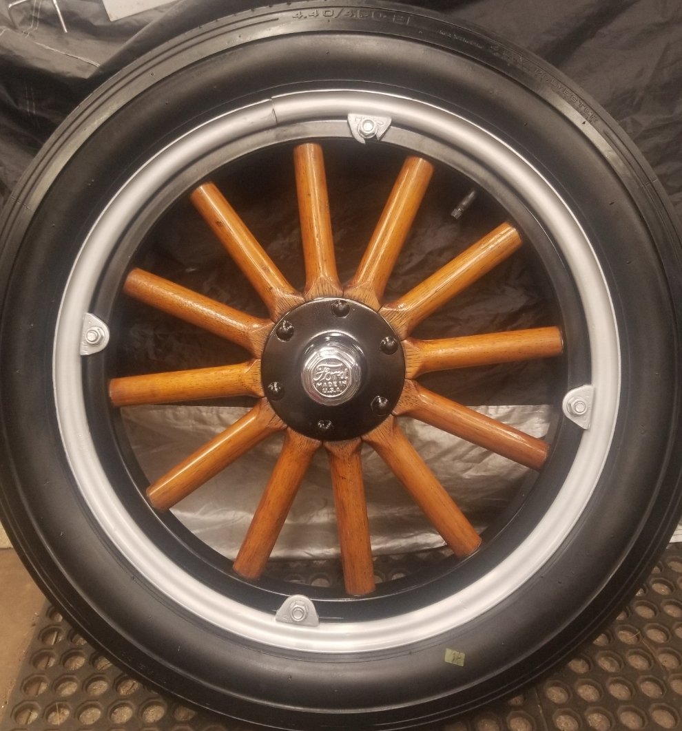

Here's one finished.

A close up

That’s a Chevy rim. Works ok, but started life on a Chevy.
Mine or the one "Kelsey Hayes" pic higher up in the thread?

Yours. Chevy rims have a notch in one of the lugs.?

I understand that the tube stem hole isn't the same place as the Ford.

You are correct. Chevy rims have stem hole in wrong place. Need to drill new one and weld up the old one.

If I remember correctly, Chevy valve stem to the left (?)and Ford to the right (?) of the split as you look at the wheel. You can weld up and redrill the valve stem holes to switch from Chevy to Ford. That is why Chevy rims have the cut out lug , because the valve stem is close and to help with installing rim on the wheel.
I thought I got it backwards and changed left & right but maybe you fellow is also Chevy. In any case you can redrill to Ford valve stem and the Ford rims don’t have the cut out lug.

I just went out and checked again. We have 2 Chevy rims and 3 Ford. The rim my son and I just refinished, is the one pictured and was drilled for a Ford valve stem location and the hole welded shut. We were wondering why and this answers our questioning it.
