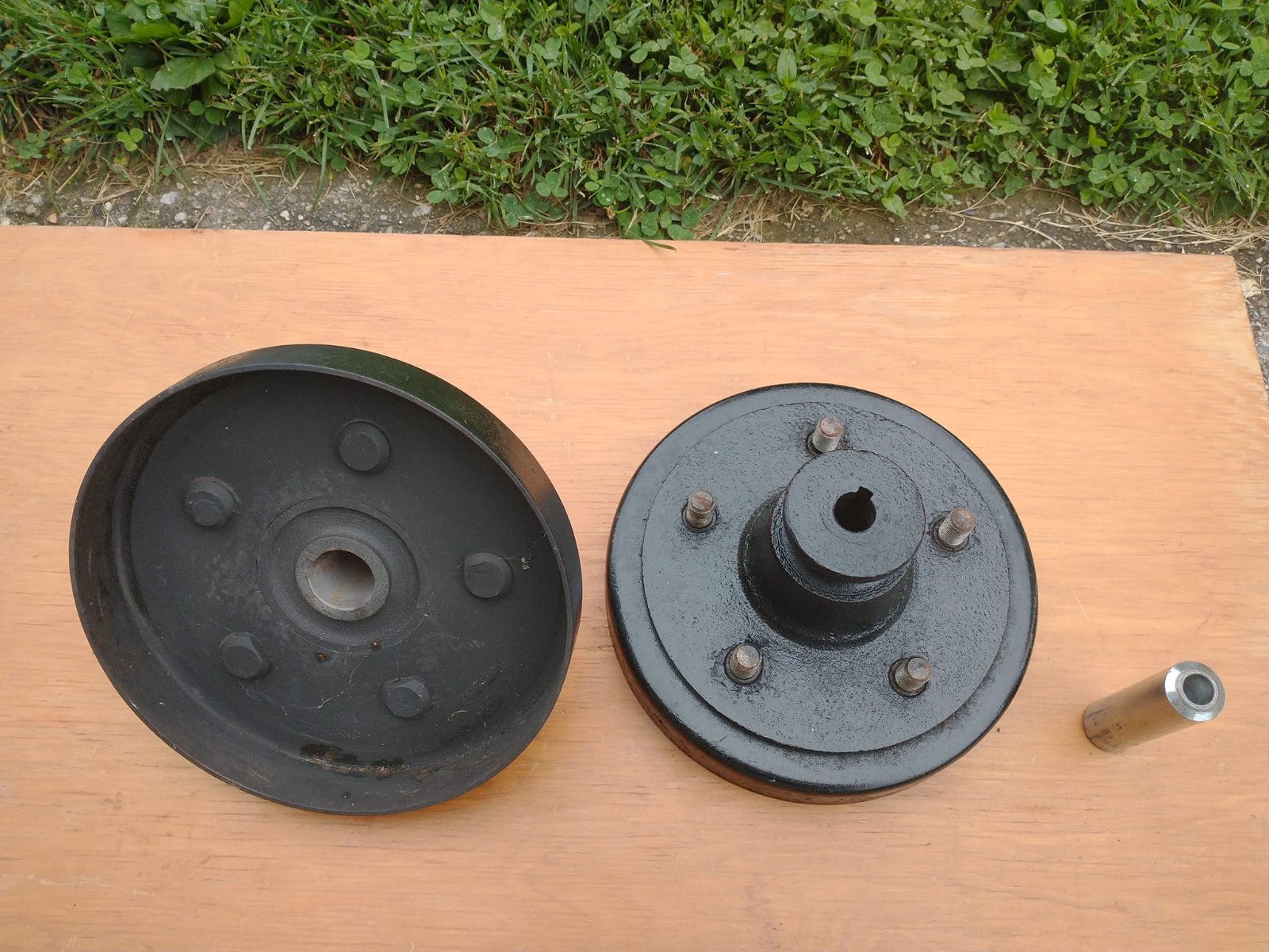

Hi Richard,
You can buy wood to wire adaptors Or I made these for a friend.
Craig.

Hi Guy's,
One thing I forgot to mention on those hubs I set up is that modern serrated studs were used because they needed to be longer than the originals
for the spacers that are needed to move the wheel out so there is room for A-C small drum outside brakes. The car they are going on has a Aux.
trans so they would be needed. If using Rockies the spacers would need to be even thicker. The wood to wire adapters will most likely give ample
room for A-C brakes but don't know about Rockies. I wonder if Sure Stop makes a set up for this application? Also keep in mind that when you
move the wheel out you increase the load on the bearing & axle.
Craig.

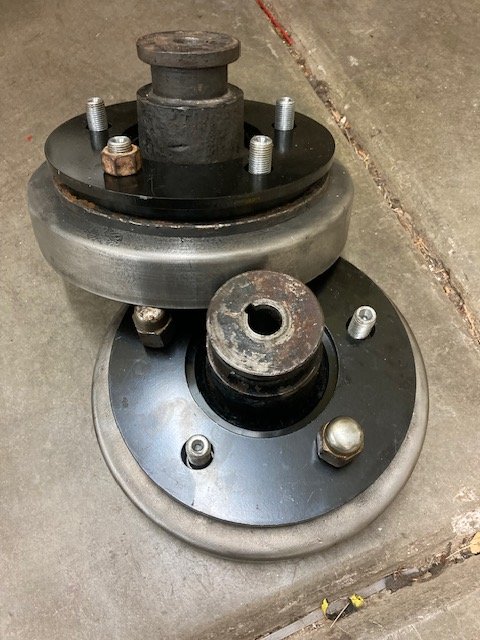

Here are the hubs I made up.
New studs and tool I purchased from Snyder's.
