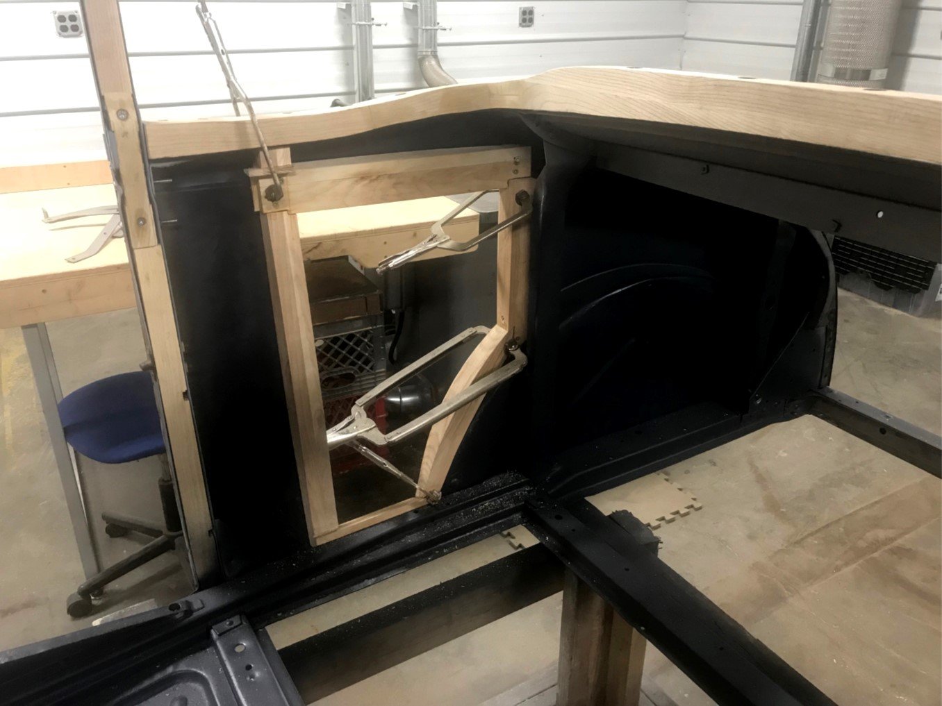

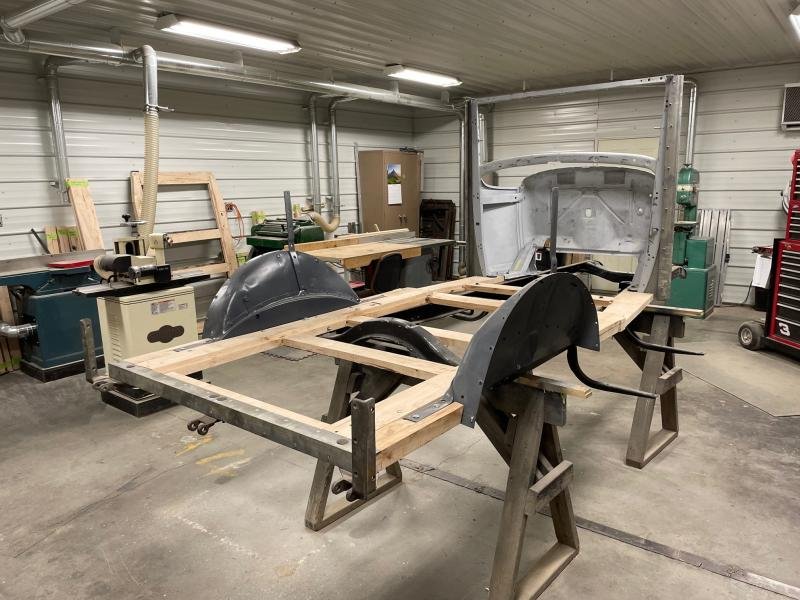

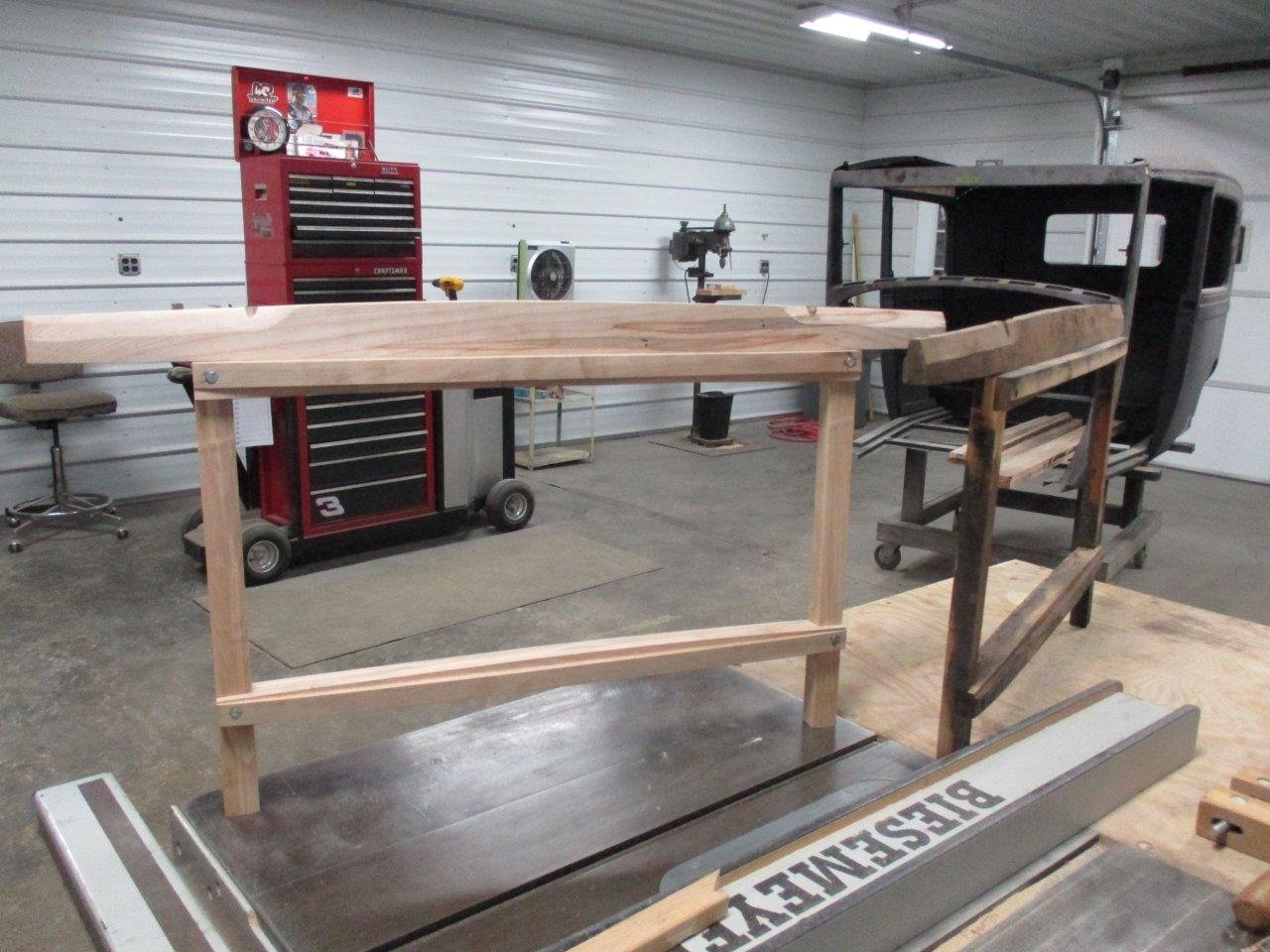

Mike, I own a restoration shop that also includes a wood shop (pix below) where we cut & fabricate wood infrastructure for bodies. On vehicles we do not have patterns for, sometimes we use original wood as our sample. Sometimes we use body filler to make our sample. I can expound on that if that is an option for you that you are unfamiliar with. In your case without much original wood to sample from, have you considered purchasing a complete body wood kit to use as your sample, -and then once you have patterned or replicated all of the wood pieces you need, then sell your kit used for patterning to offset the initial costs of the kit?

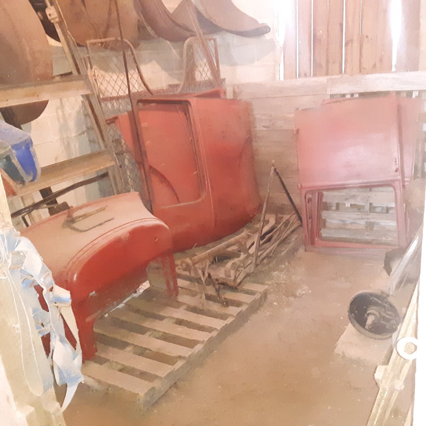

Yes, I have had this project for 5 or 6 years now and have searched for how it was done on several occasions over the years. There is a lot of great documentation with dimensions on the 26-27 coupe along with pictures on various forum posts. There are a lot of pictures of the Tudor roof but dimensions are not there. The Tudor roof is just a stretched version of the Coupe roof. All this can be used to make a reasonable copy of a Tudor roof with some thought. I like to make things as accurate as possible plus it would make things easier and faster. There are several 26-27 Tudors not real far away but they are all assembled and complete so I can not take them apart.
Health issues changed my finances and made it very difficult to tolerate getting cold or wet so I need to get one of my closed cars going to continue to enjoy the cars in less than perfect weather.
Maybe this is just an exercise with no results but I am going to try.
Enclosed is a picture of what I am starting with, a pile of parts in the corner of the barn.

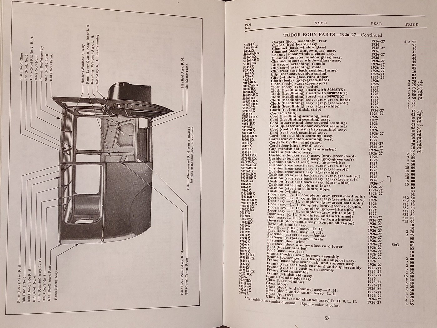

Yes it is true that the Coupe and Tudor wood parts do not share any common part numbers for the roof wood.
But I believe there is a common style between them.
I prefer to look up factory part numbers in my digital copy of The Encyclopedia.
26-27 Tudor Wood Factory Part Numbers
Frame (Roof) Assembly 50324X
Rail (Roof) Front 50613X
Rib (Roof) No. 1 50620X
Rib (Roof) No. 2 50621X
Rib (Roof) No. 3 50622X
Rib (Roof) No. 4 50623X
Rib (Roof) No. 5 50624X
Brace (Roof Rib) No. 2 R.H. 50178X
Rail (Roof) Side R.H. 50614X
Rail (Roof) Side L.H. 50615X
Rail (Roof) Assy. Rear 50325X
Slat (Roof) Short 50642X
Slat (Roof) Long 50641X
While it would be really nice to get a copy of the factory drawings it would take 9 or 10 drawings to get a set.
At $30 per drawing (according to their form) it adds up to $270 or $300.
If I lived near Detroit I would go over and get them at the self service price of $5 each for a total of $50.
When the budget says NO there are only 2 choices: Don't do it, or find a way.
At this point I don't think that 26-27 Tudor wood plans even exist.
