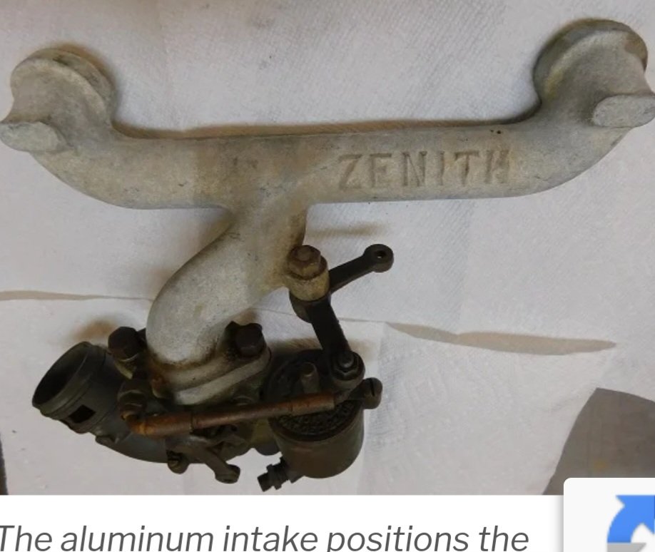

Re: Aluminum intake manifold
Your looking for a Zenith manifold. Not reproduced. You need to find and original.

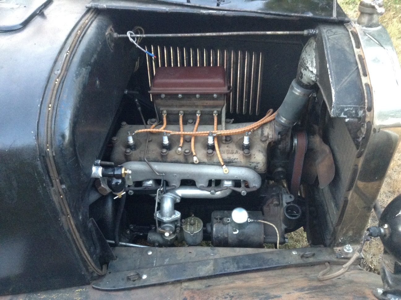

Not sure if these sidedraft manifolds are still being reproduced. I made up the elbow adapter for the Winfield and it worked great. Don’t those Zenith manifolds get really restrictive in the dogleg…?

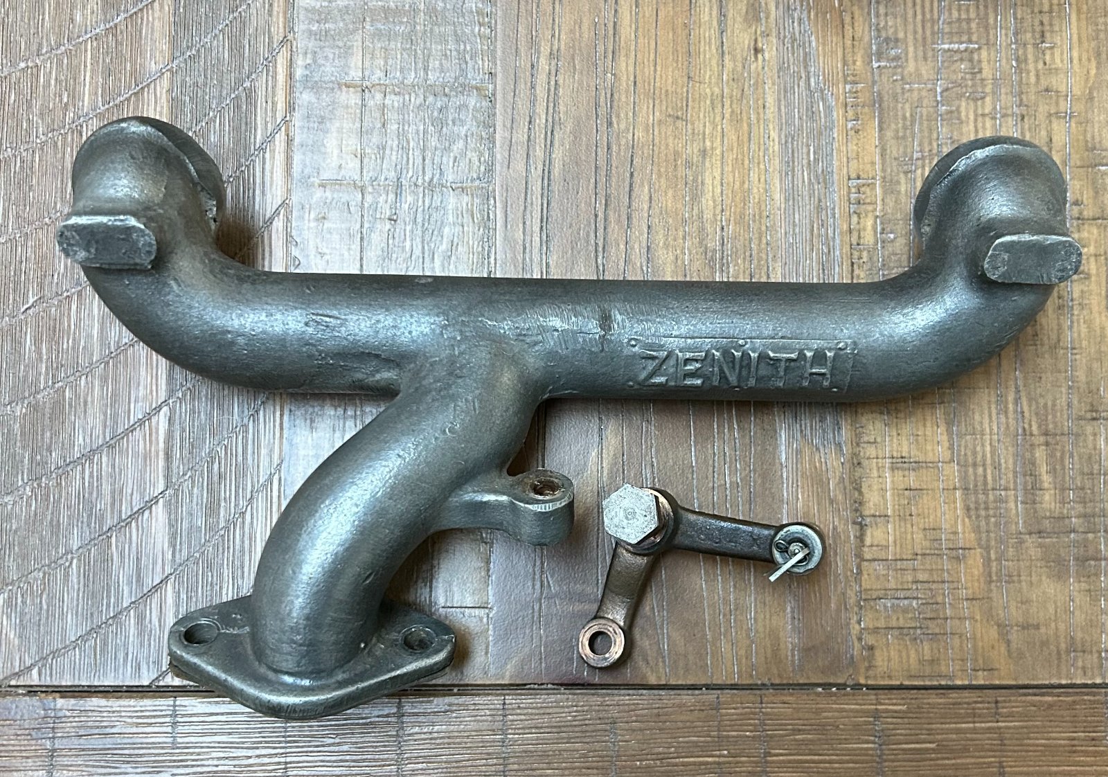

I have this one: I sent you an internal message.
UPDATE: If Tom is not interested, this manifold and lever is available. Give reasonable offer. SALE PENDING

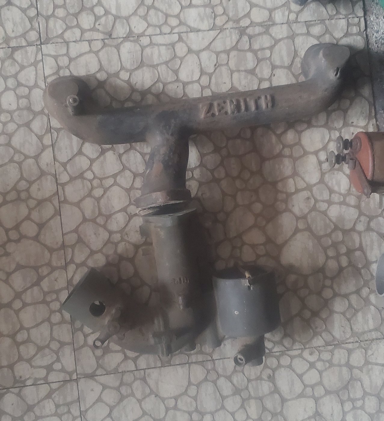

I thought I had it made with the one I found but the carb flange is the wrong way
Hi Tom,
I don't think I have ever seen a A manifold with a T exhaust ( other than a vaporizer exhaust manifold? & changing to a A manifold W/ exhaust
is more work.) The manifold in Kevin's pic I believe is a speedway manifold modified to use a Winfield carb. That is the third one I have seen
& I'll bet none of them are for sale. The Zenith manifold is as rare as the carb is, & if Chris is interested in parting with the lever I would be
interested as I don't have that part & will need to make it. Karl that is the more desirable set up if you can find all the parts to the carb.

- Posts: 5497
I was told in the past that the Zenith manifold with the lever on the side was the reproduction and the one Karl shows is the original because the carb Karl shows is the original type that came with the manifold and use the original Ford style carb rod.

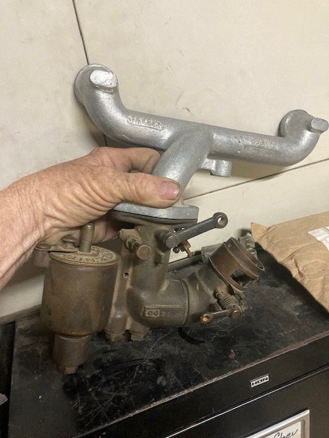

Zenith made carbs with the bolt pattern both ways. The O4 Zenith bolts are inline I have one just like the one Mark posted.
Yes the carb is on backwards to show the model # But this may be a aftermarket manifold that was referenced because the word Zenith
is different than most or could be a later production??
