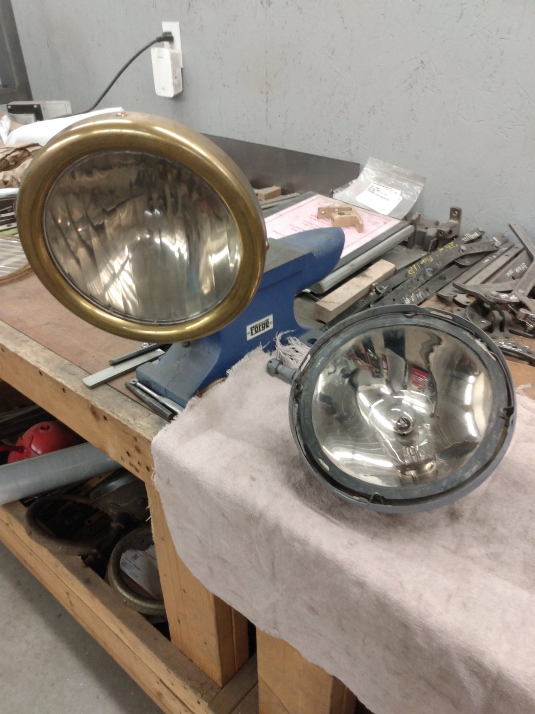

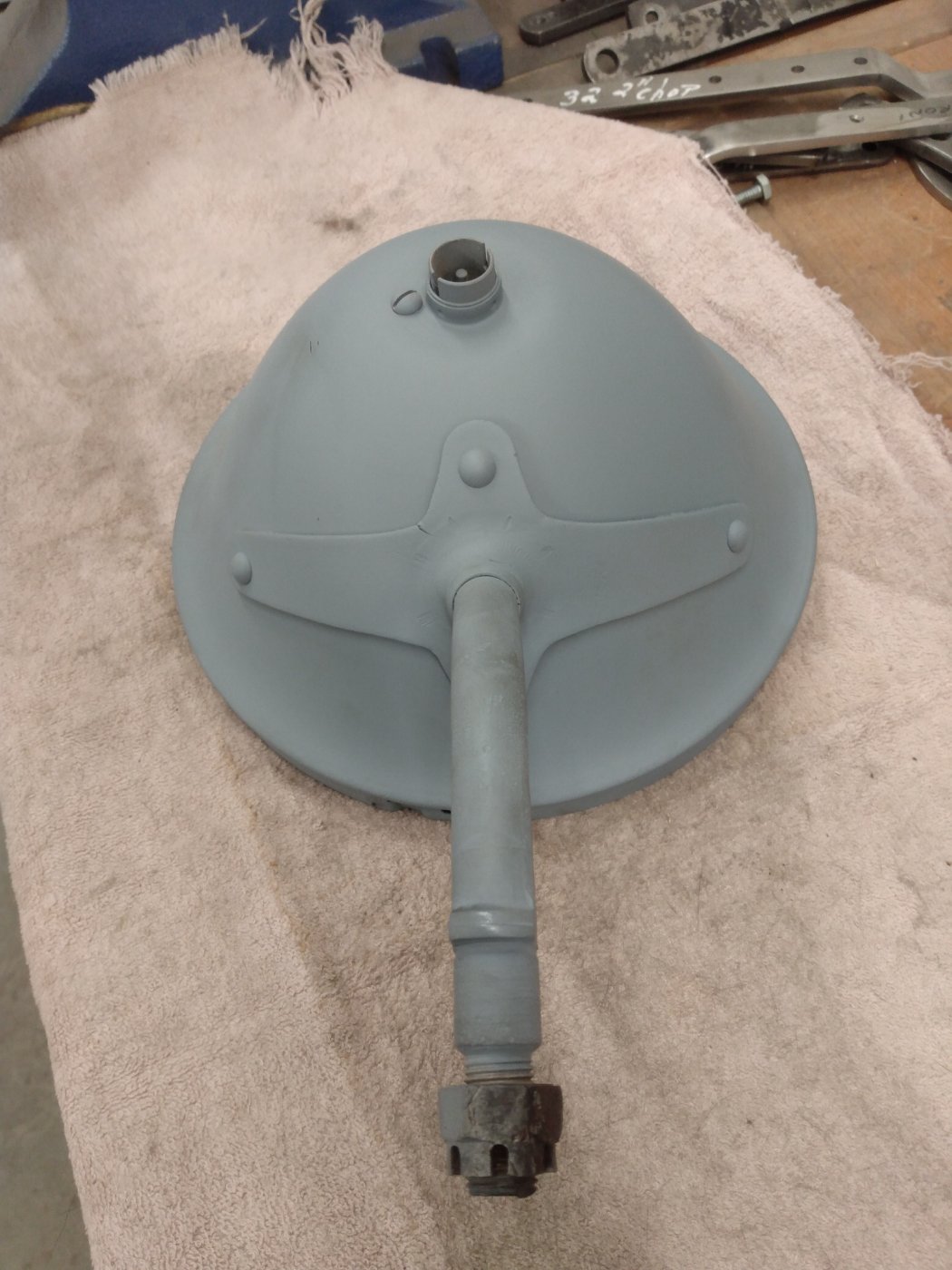

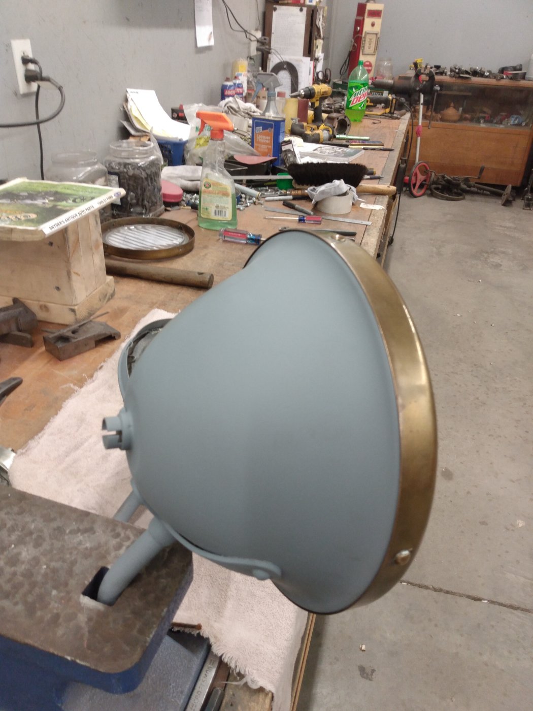

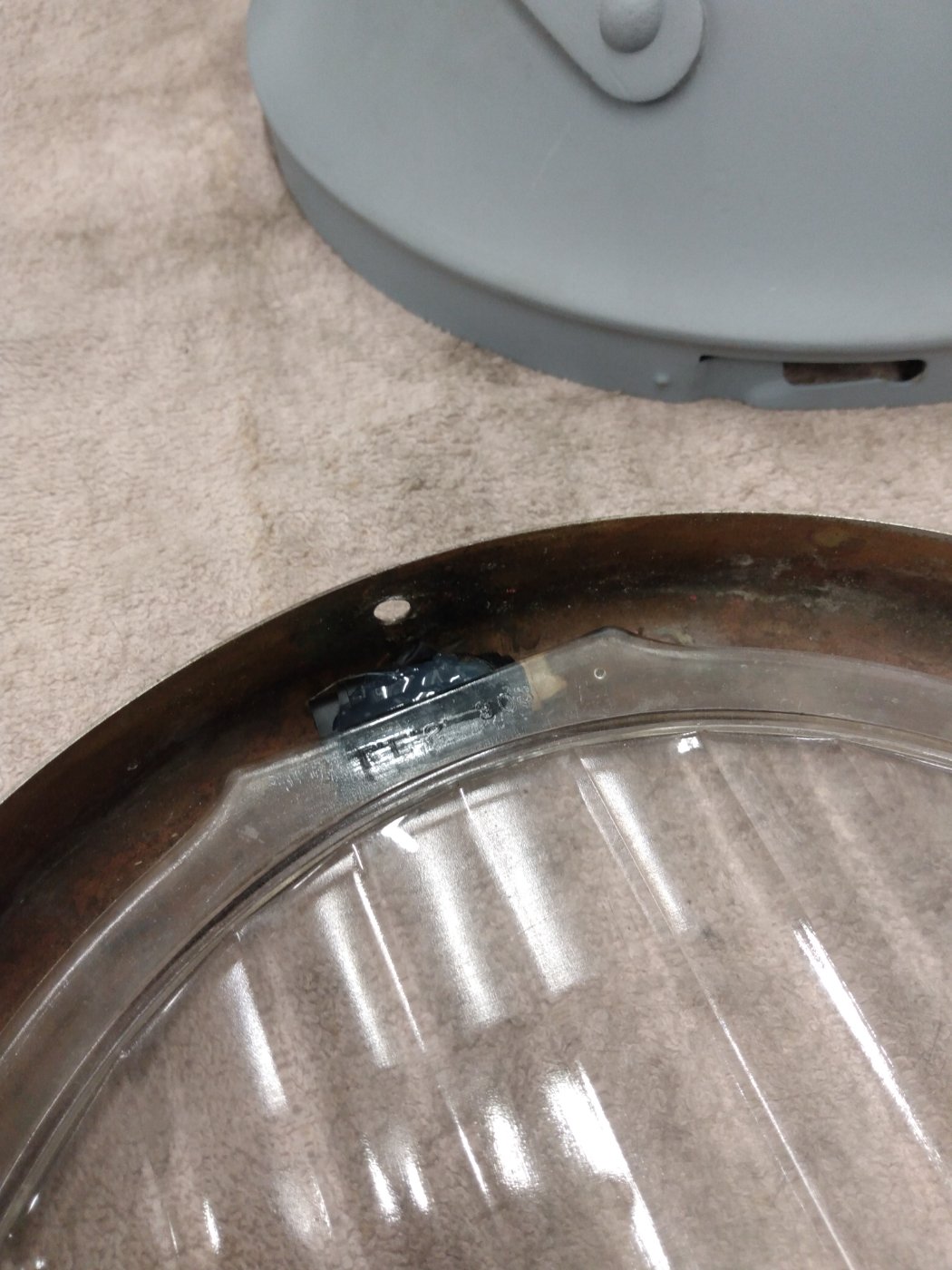

Pair of e and j 440 headlights. Blasted and primed. Good solid buckets. Both reflecters are good. One brass ring has a missing lens clip on the bottom. I believe the arms are early 15, but the adjuster screw is on the left. I don't know the relation to the screws left or on top. 200.00 plus shipping. ctleonard64@gmail.com

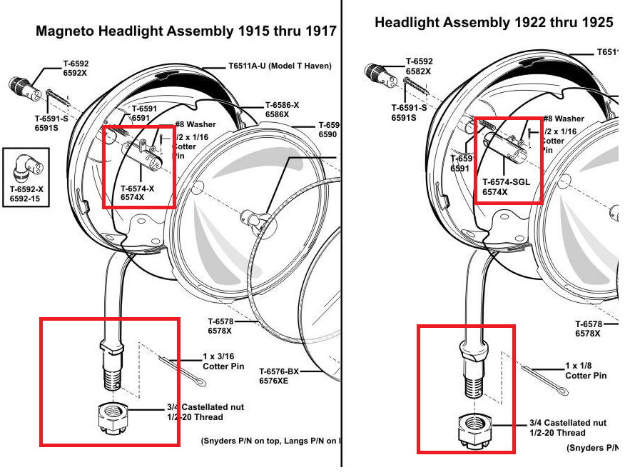

Very nice set, but not 1915.
The 1915-17 have the focus screw at 12 o'clock (above the socket) while the later ones have it a 9 o'clock relative to the socket.
Note too that the sockets were different as well. The later bases are tapered and fit different fender trons --

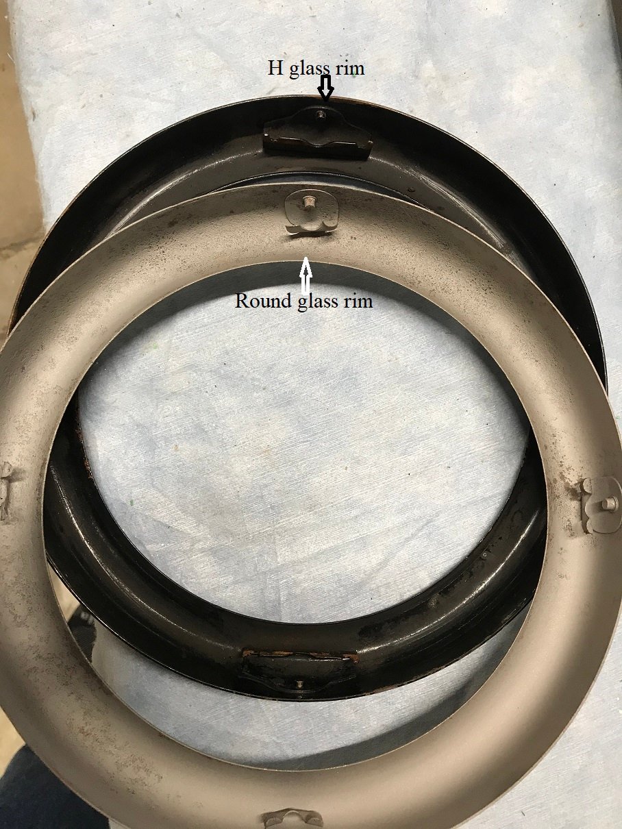

Rims for round glass had small claw like tab while H glass has a straight bar.
