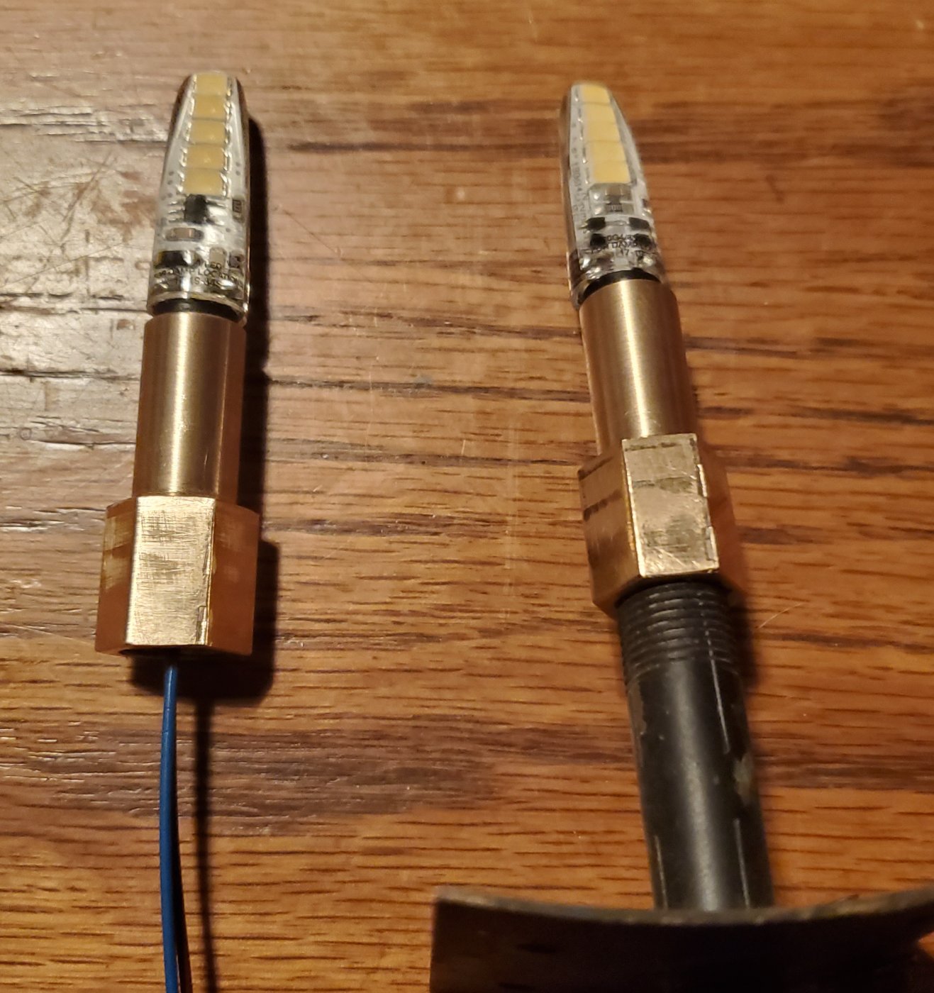

My LED kits do work with the reflectors for the brass head lights . snyders and langs carry them. They do sell a bulb now that works for the electric headlights it does not need the reflectors . they are about $40 a bulb they work great.

He is a picture these are the protypes. The bulbs unplug if they burn out.

I was just looking at those at langs site
how do they work for you?
REF: https://www.modeltford.com/item/BL-LED.aspx

Re: WTB - Gas Headlight Mirrors for 1914 Moldel T
When I first started with these there was only 2w led bulbs available. now there are 5 w bulbs . close to the quartz 50 watt.
