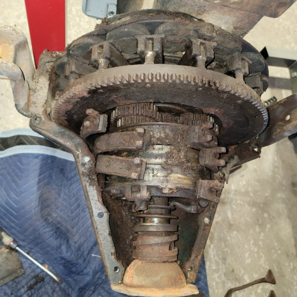

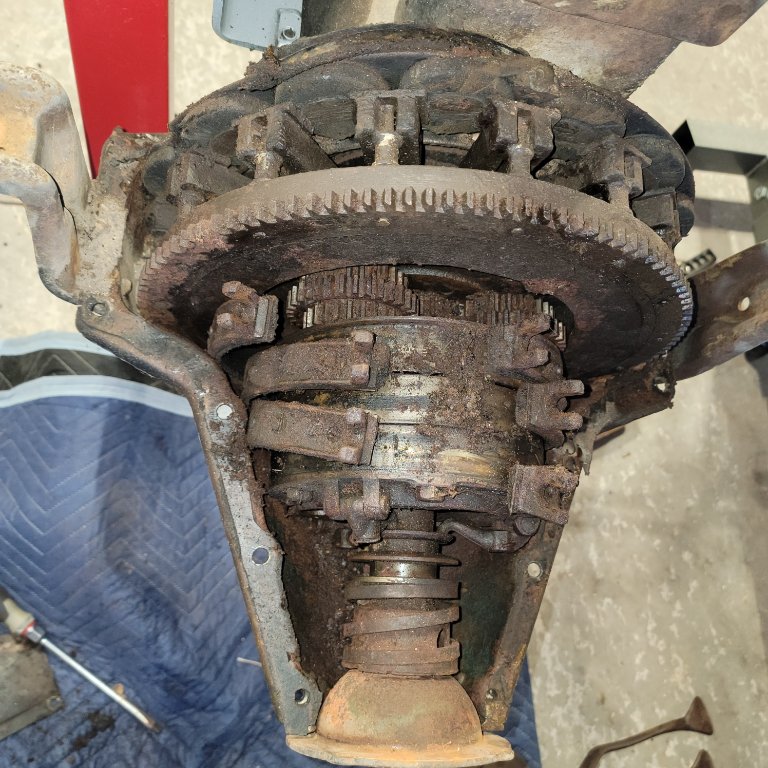

How do you remove the back side of the ball cap? I am trying to get the transmission off a 19. The cap looks very rusted.

I'm not conveying what the problem is. See Pic and you will see the ball cap on the end of the shaft. I can not get that off. The oil pan is gone now. Its on older picture.

It's rusted on - dead blow hammer should do it otherwise generous amount of penetrant !

That cap has a babbit bearing and it will need to be rebabbited and bored to size. The clutch spring should almost certainly be replaced, too.
Given that, I see no downside to simply putting a torch on it and heating it until the babbit yields from the output shaft
Afterwards, if the output shaft is in good enough condition to save (very likely), then any babbit that is stuck to it can be cleaned off during its restoration and resurfacing

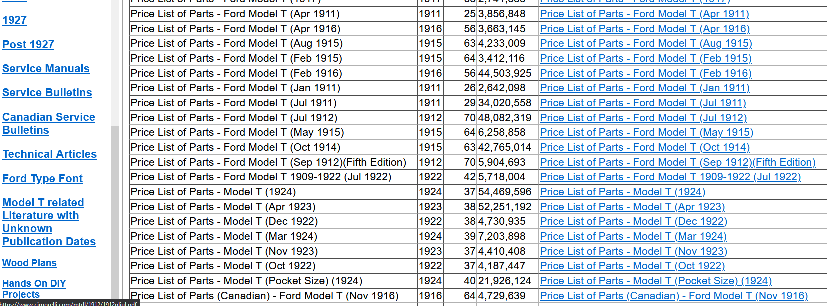

Just a sample of what is available in the link that Mark posted --Mark Gregush wrote: ↑Sun Aug 07, 2022 12:09 ama digital copy of most all parts books can be found here; http://www.cimorelli.com/mtdl/default.htm
In the left margin there is a list of links to numerous books. The listings of parts books by year goes on for two pages
