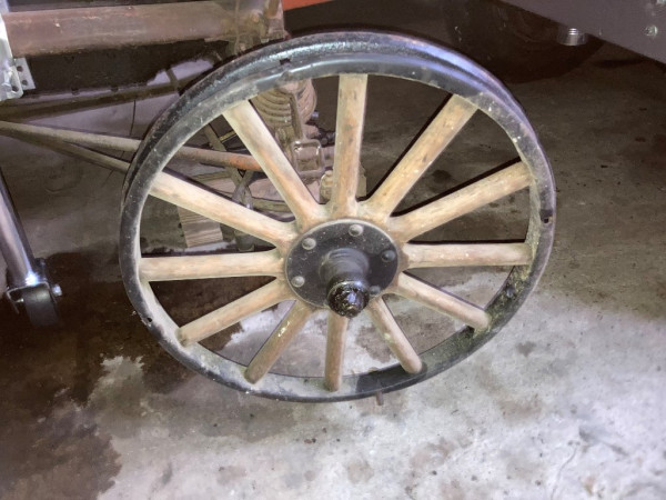

I bought a 1915/16 roadster last year and am learning on it. It has demountable rims on the rear but not on the front. One of the front wheels is very loose. I would like to buy two demountable front wheels & rims for it. mcobb@indak or text 8472541655

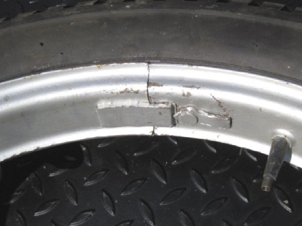

Re: demountable front wheels
Some of the rims have a clue on the lug that attaches the rim to the wheel.
The early Firestone rim had five lugs, but the later ones only have four lugs.
Removing the rim and looking at the split area method of attachment is a good clue.
This is the later Firestone rim that did not have their name on the lug.

My loose front wheel spokes seem OK but the rim is not tight to the fellow. One of the bolts (rivets?) in felloe has backed out (toward the center of the wheel) by about 1/4 inch.
If I find 30x3.0 front wheels and rims of the same make as my demountable 30x3.5 rear wheels, will the rims fit either wheel? In other words can I carry just one rim with tire to use as a temporary spare for front or rear?

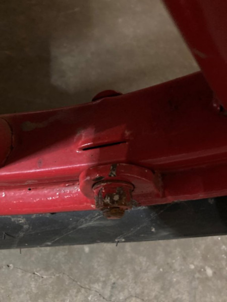

I've attached a photo of my rear wheel lug. The nut is tapered. The felloe has a "louver" that is not being used - do I have a mismatch of parts? This seems to work OK. Any advice will be appreciated!

To me, that felloe looks a lot like Chevrolet. That's how my '27 one-ton is made. They have a square clamp that rests on that raised edge.

It's a Model T wheel - '21 or '22 - used a separate lug with a rim nut shaped like a top hat.

Martin
photos are worth 1000 words! It looks like you have a FORD or Hayes rim on a Kelsey wheel. Happens a lot, but not the best combo for the long term as they are not really made for each other even though they may appear to fit, they don't fit that well.
You're starting with mismatched wheels/rims...so your going to want to find rims which match your wheels, and then purchase a set of rims/wheels for the front. This way everything will match.
Alternately, if your rear rims are in GOOD CONDITION, and the spokes on the wheels are fair/poor, if you remotely think you want to respoke the rears, then perhaps you want to respoke and REPLACE those felloes with Hayes Felloes, keep your rims, and then find matching wheels/rims for the front
This plan may be more easily done, because it seems to me that GOOD RIMS are harder to find than GOOD FELLOES, so perhaps keeping your rear rims would be the way to go rather than keeping your rear felloes. The point being, get your rears up to snuff (whatever that means to you) and then work to make a matching set on the front. Clear as mud?
Forum Member Mark Strange did a marvelous job with photos to show a series of correct/incorrect combinations of wheels/rims...to see correct rims on correct wheels, and wrong rims on wheels, take a peek here for info: http://www.mtfca.com/discus/messages/50 ... 1434340728

That red felloe is a Kelsey loose lug wheel, which is what I have on our 23 Coupe.

Thanks for the photo. Chris has nailed the felloe. It is a Kelsey loose lug item, which takes a U shaped lug and the top hat nut mentioned in a previous post. Both nut and lug are available from Langs.
However, the rim with lugs is not a match for that wheel. Only Ford lugged rims will bolt up to that felloe. Hayes rims with the foot on the lug would need to have a depression in the felloe for the foot, or the foot of the lug would need to be ground back. None of the lugged rims actually fit as designed, by wedging on the inner land on the felloe. Felloes for lugged rims have a wider land on the inside, onto which the rim is wedged. The lug bolts are there just to maintain this wedging effect. That Kelsey felloe does not have the wider inside land. The four lug bots and a Ford lugged rim will work, so long as the bolts are kept tight.
Our Canadian sourced cars used Kelsey loose lugged wheels right up to the late 1925 models, so they are more common here. In the USA, lugged wheels were introduced earlier, and so are more common. You may find it easier to find a whole set these rather than a pair of Kelsey fronts. It should also mean that lugged rims should be more plentiful. However, good used rims are difficult to find. The good news is that both loose lug rims and fixed lug rims are available new. The choice is yours. You will have in the vicinity of $400 worth of tyre and tube on each corner, so new rims are a good investment to protect these.
Hope this helps.

Thanks to all who have educated me! I bought a parts car that has two front Kelsey "loose lug" front wheels that seem OK, and three rusty (but not terrible) Ford rims. I already have this Kelsey/Ford combination on the rear so I'll end up with four Kelsey wheels and five Ford rims.
My question now is what is the best way to clean these wheels to prep them for painting? The rims can be chemically stripped or sandblasted, they seem easy. Should I trust a sandblaster to stay clear of the wood spokes? Can anyone recommend a sandblaster (or "media" blaster) in the Chicago area?
