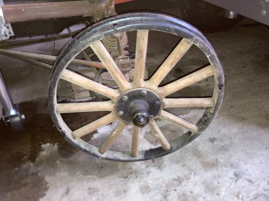

I have a 1915/16 roadster that is not very original. It has two Kelsey "loose lug" wheels on the rear with one (I think) Ford rim and one (I think) Hayes rim. The front wheels are non-demountable.
I recently bought a parts car with two demountable front wheels (Ford, I think - they are not Kelsey loose lugs. Photo attached) in fair condition, but the rims (Hayes, I think) are very rusty.
I'd like to buy three serviceable rims, of whatever manufacturer will work with my wheels, so I can carry a spare tire-and-rim.

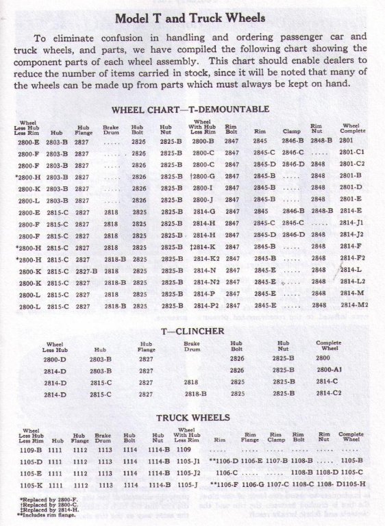

You need all four wheels to be same make. Rims do not interchange between different makes.
There is a chart in the Ford Service Bulletins that shows the difference. Dan

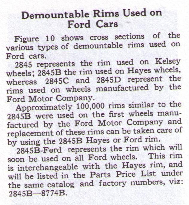

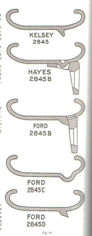

the wheel you are showing appears to be a Hayes.
Hayes and FORD 2845B rims fit it
Similarly, rims which will fit that wheel will also fit FORD wheels, so you have the option to mix/match within that range of combinations

The wheel shown does appear to have the relief in the felloe edge at the lug holes, indicating a Hayes wheel. They will accept both Hayes and Ford lugged rims, so you have the best option in your wheels for a mix and match that will allow correct matching of rim and felloe.
Ford lugged rims will bolt up to your Kelsey loose lug felloes. Hayes will not. However, the four lug bolts will taking the "drive", so they must be monitored to make sure they stay tight. The rims will not wedge on the felloe as they are meant to. So, your spare should be a Ford lugged rim.

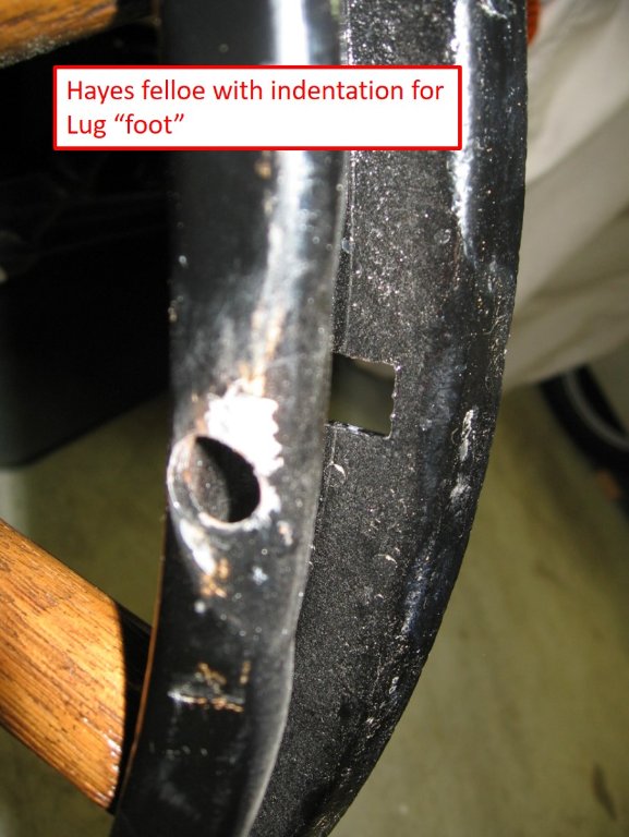

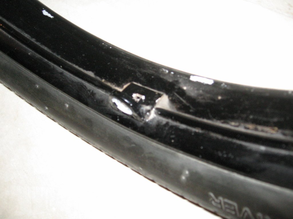

Some Hayes felloes have a "dent" in the outer rim at each lug location to allow the lug foot to clear, others have a cut notch. It's hard to tell, but I think I see a faint indication of the "dent" in the picture, I would need a closer view to confirm. Here is a picture of a Hayes rim showing the lug "foot" that requires clearance, and a Hayes felloe with the clearance "dent".

Mark, your photo shows the typical relief pressed into the outer rolled edge of the Hayes wheels with which I am familiar. I am aware that some felloes have no rolled edge, but have a straight up outer edge. Steve Jelf has shown photos of this type of rim. It is my belief that these are not Hayes rims, but rather they are from a different manufacturer. They are notched as they are to make them compatible with all the lugged rims used by Ford, including Hayes rims, making interchangeability possible over all cars.

Thanks all! My "new" front wheels do have 4 slight "dents" so they apparently are Hayes. I'll contact Vintage Rims Australia.
