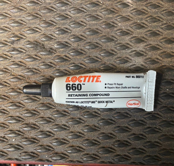

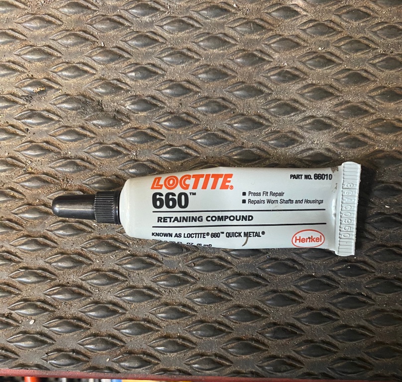

Loctite 660 gap filling, hi strength, bearing retaining compound. This stuff will fix your problem.

Jeff - good advice from John and Scott. I used Loctite 660 on one of my 1926 wire wheel hubs. I also used a prick punch to raise the metal on the inside circumference of the hub - worked well.
