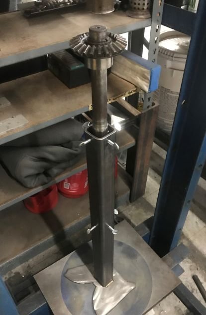

Glad you found a pair! If you plan to press them on yourself, be extremely careful to construct some kind of cage to restrain the axle shaft in case it decides to shoot sideways out of the press and become a missile under the force. My HF 12 ton press wasn't up to the task, I had to take my axles to a machine shop and they used their 30 ton press to install the side gears. When you think you have the gears seated fully, check for movement of the keepers in their slot. If they can be moved, they aren't fully seated, press them further.

Thanks, Mark for the advice. I have gained a lot of insight into this process from this forum. I am in the process of building a restraining fixture to keep the axle from bending and moving out of the press and have access to a machine shop and 20-ton press. I plan on measuring the bores and shafts and dressing them as required to get a proper press fit.

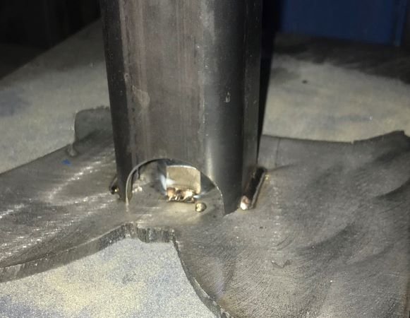

Thanks to all on this forum for the gears and advice I received. I built a holding fixture and was able to press the gears onto my new axles without issues. The press fit was 1.4 thousands interference, and I had to dress one side of the new keys a bit for a nice tap-in with a brass hammer fit. For the fixture, I welded a standard 5/8"-18 nut to the baseplate, centered on a 2' piece of 2"x2'x1/4" wall square tube. I drilled and tapped eight 1/4"-20 holes and installed thumb screws. I threaded the end of the shaft into the nut on the bottom until it bottomed out, the adjusted the thumb screws to hold the axle in the center of the tube. I used press-fit lubricant, and the process went smoothly.
Today my T is back on the road with new axles, good axle gears and new ring and pinion!
