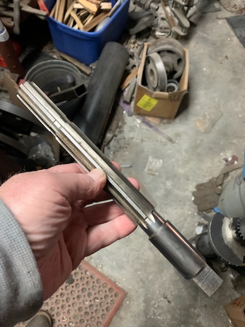

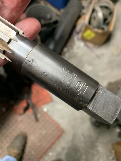

KRW were not only maker. Here is pictures of my Keystone reamer. Not for sale. But I have thought about having some made. Would not want to think about the cost!

Easy enuf to make. Buy a 15/16" chucking reamer on eBay and make a 1" sleeve to place over the 3/4" shank. Actually .999" per KRW . Best way to do it is make the sleeve a slip fit, then make it a permanent bond with sleeve retainer before turning the OD. Center by indexing off the reamer.
