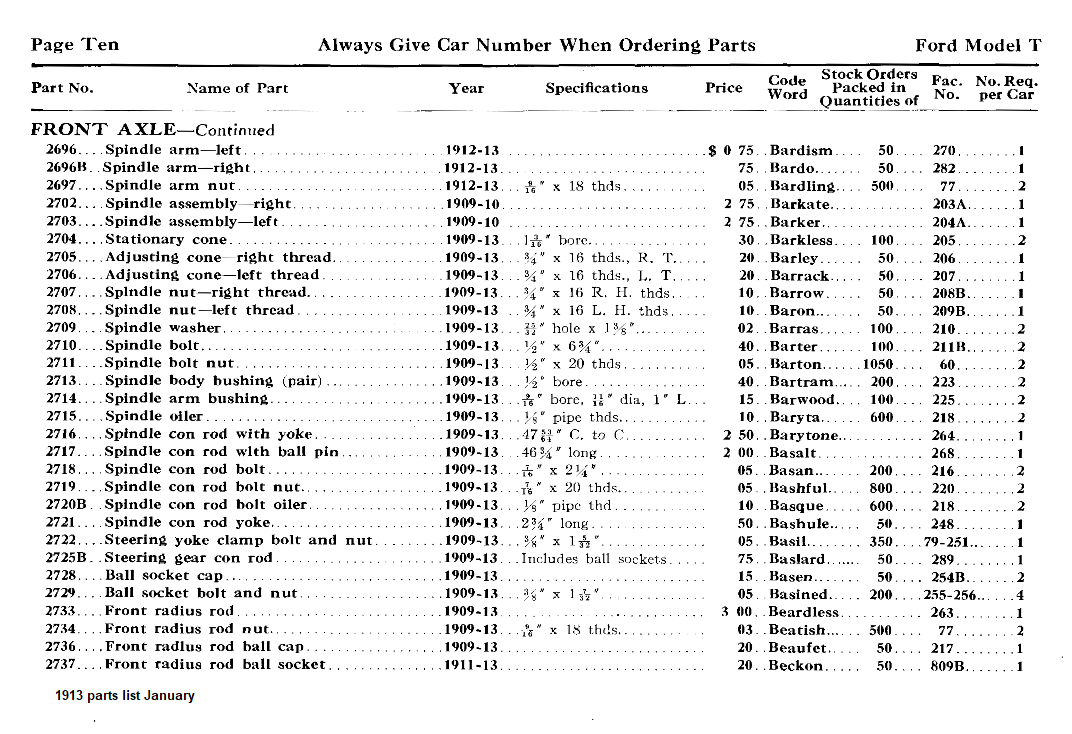

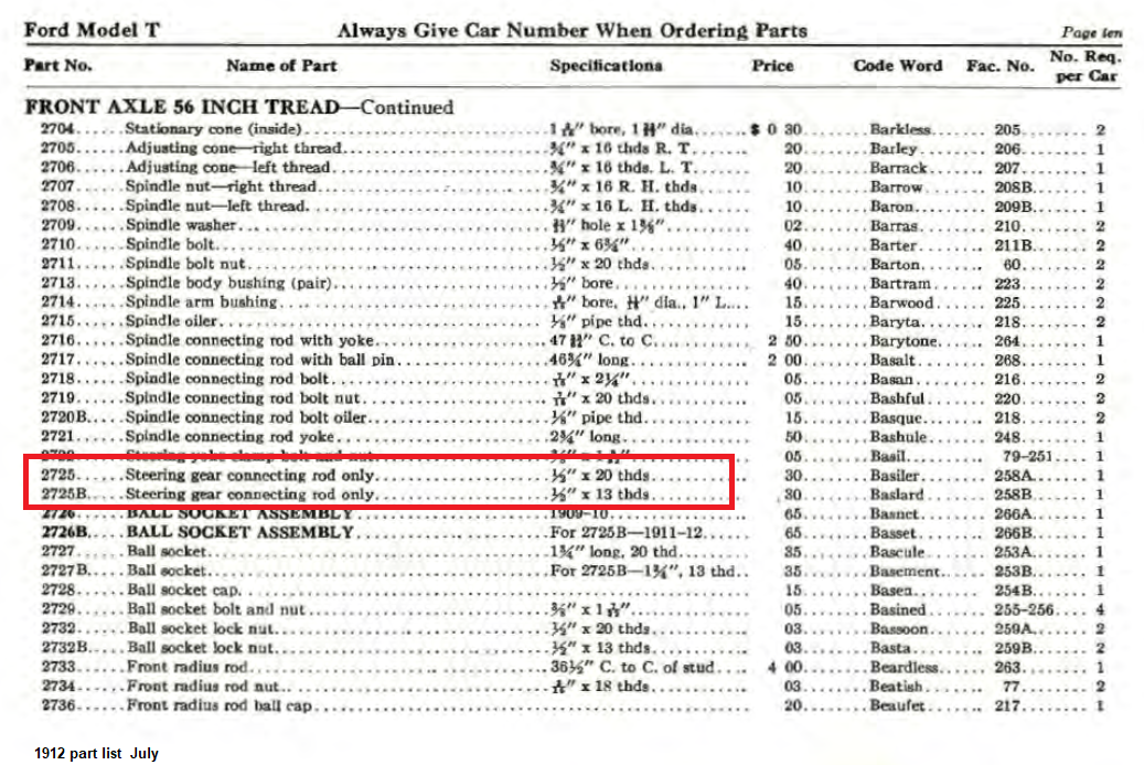

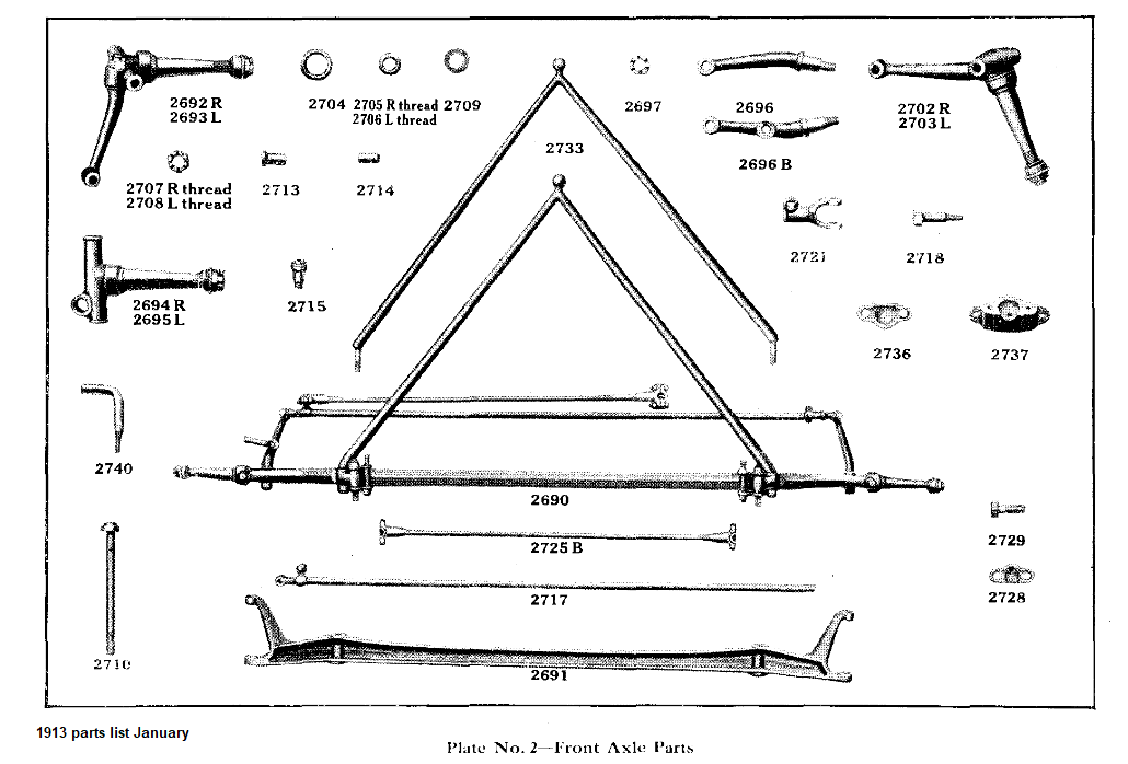

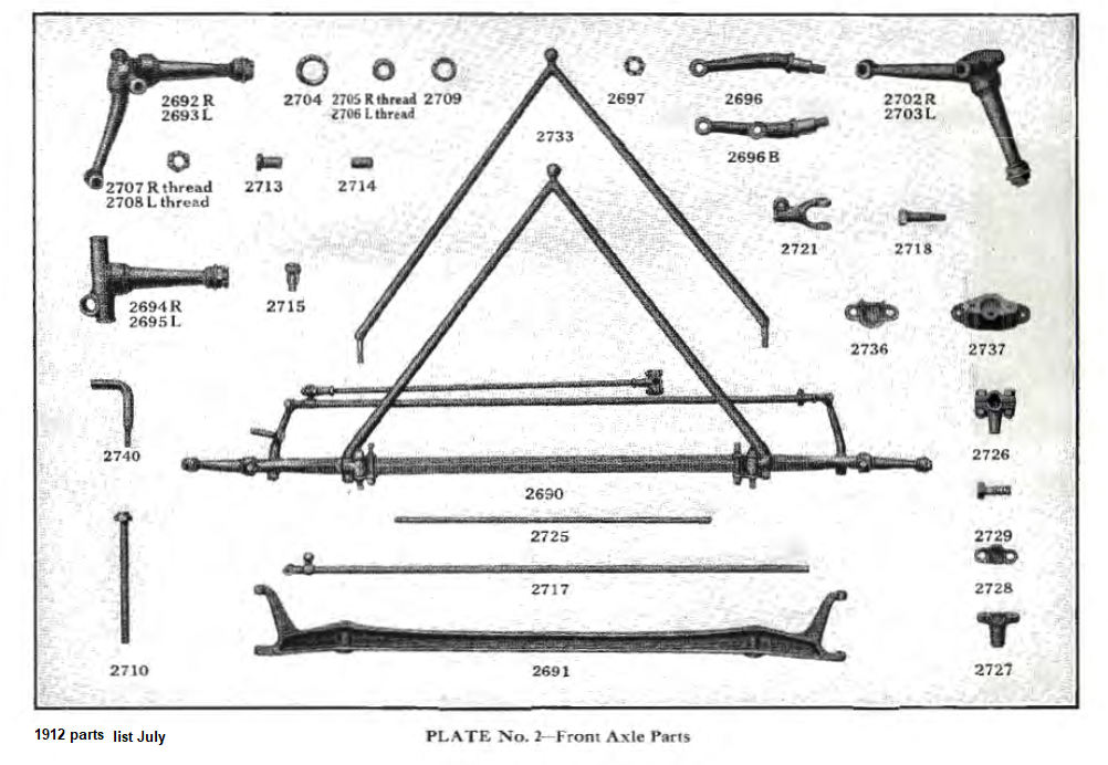

Posts: 6587
Re: WTB: 1912-13 adjustable drag link
Post by TRDxB2 » Sat Mar 04, 2023 4:54 pm
Benji wrote:
Sat Mar 04, 2023 2:33 pm
I thought about July of 1912 was when the riveted style started, and the adjustable was phased out?
I'd say you may have nailed it.
The 1912 July parts list does not show a picture of the nonadjustable but references its part number. The 1913 January parts list makes no mention of the adjustable one
