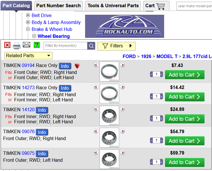

Why not just buy new from RockAuto?
Posts: 6575
Re: front wheel bearings
Post by TRDxB2 » Wed Apr 12, 2023 12:56 am
Yes! RockAuto get the race too

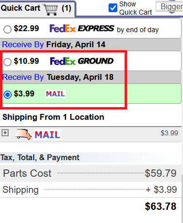

Shipping FedEx Group same for 1 or 2 bearings. USMail went up to $5.99
eBay is $80 with free shipping +tax

Last I knew R.A. didn't have one side, I got one that they had, have to go look which one, I forgot which one they hadn't had for over a year. I like to keep both Left & Right outer at least in stock.
havnfun
Posts: 478
First Name: Joe
Last Name: Kowalczyk
Location: Kuna, Idaho
Post by havnfun » Wed Apr 12, 2023 9:46 am
I got an email from rock auto a couple months ago, the out of stock front outer bearing is now in stock

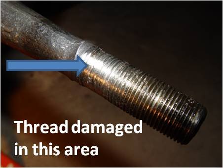

I have had Model A wheel bearing on all three of my cars. I drive them on tours every year and have never had a problem. They say it will hurt your spindles but after having them on all my cars for over twenty years the spindles look just like they did originally. Maybe I am in error using them but so far things are good.
Posts: 6779
Post by Scott_Conger » Wed Apr 12, 2023 4:25 pm
Larry, you are the fortunate exception. Unrestrained, and sitting on the crests of threads, unlocked from rotation in any way, they usually will put moderate to severe wear on the spindle threads upon which they sit. This completely ruins spindles, and is particularly tragic when it happens to early, rare parts. Getting away with something with good luck is, I hope, not an endorsement that it is good practice. If the spindle was ground round, for a solid and precision fit of the bearings, that would be an entirely different story. Hopefully, you will continue with your luck.
this is what usually happens when using Model A bearings in a "T":
