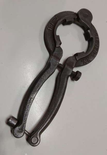

Stevens Thread Chaser on TBay

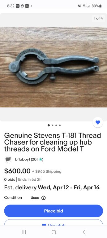

I'm predicting it will sell. Somewhere between the 600.00 to 850.00 range

It missing the rear clamp screw and nut. DISCOUNT!!!

My 2 cents, it doesn’t get any bids and maybe a private offer around $400 after the auction ends.

I did not notice the missing clamp screw. I'll adjust my price estimate to just 600.00.

Price lowered to $500 on eBay, I’m not affiliated with the item, simply updated this thread

Item ended with ZERO bids, if you’re interested in this item, you might make a private offer to the seller. There answer is always no if you don’t ask, good luck if you make an offer

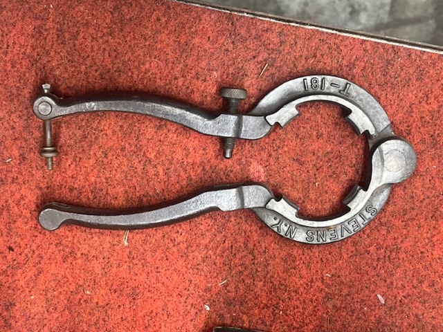

Disclaimer: I have not personally handled or examined the Stevens T-181 tool listed on eBay.
Having said that, I have handled, examined and used a number of T-181 tools over the years. The condition of the thread chasers on these tools is critical to the usefulness of these tools. The chasers are subject to wear and if not in good condition, the tools are little more than wall hangers. The thread chasers can also get bunged up by mis use of the tool. I would be hesitant to bid on or outright purchase a T-181 if I could not clearly see the condition of the thread chasers on the tool.
By the way, did anyone else see the auction for the KR Wilson brake drum bushing reamer for use with the Wilson transmission bushing tool on eBay Sunday night? All the action took place in the last 10 seconds of the auction.

Re: Stevens Thread Chaser on TBay
Jerry VanOoteghem wrote:
“Trent,
Do these tools actually cut away the deformed portions of any threads, or do they re-shape a burred or rolled-over thread?
Thanks.”
Jerry,

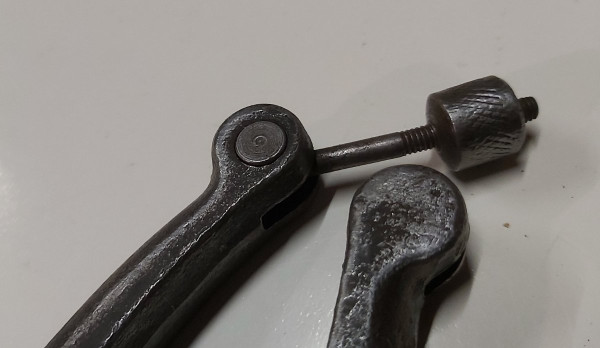

That’s an excellent question. Here is a close up of the inside of a Stevens T-181.
It appears from the design that the tool actually can recut an existing, not just reswage. If the threaded portion of a hub is badly mangled, this tool will not help you much. If you are just trying to get a hub cap to go on easier and straight, it works great.
It also works on NRS hubs, but you have probably figured that out already.
Respectfully Submitted,
Trent Boggess

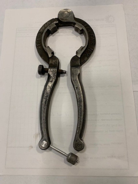

A single most important point about this tool is it is clamped around the back of the hubcap thread and winds OFF the hub in use. It starts on good thread and winds off onto the damaged thread, cleaning/reforming as it goes. I know of no other tool which does the same.
I do not lend my tool. I do volunteer to use it on any hubs brought to me for work.

Allan the OTC7402 mentioned above works the same way. It has a single removable and replaceable die style cutter. Opposite of the cutter is a V shaped guide that is the body of the tool. It is made of aluminumn. In use the adjustable cutter is adjusted large enough to place on the threads behind the damaged threads then the cutter is tightened in place and is guided by the v shaped aluminumn guide. You can tighten the die as tight as needed. Then unwind the tool off the threads restoring the damaged threads. The only real drawback to the OTC tool is the aluminumn v guide is rubbing/sliding on the threads opposite the cutter die. So the aluminumn v guide is wearing out as you use the tool. It is designed so the soft aluminumn does not damage the threads as you restore them. But it takes a lot of use to finally wear out the tool to be unusable. I have both the OTC tool and the Stevens tool. While the Stevens tool works a little better I used the OTC tool for years with good results. It also comes with several dies of different thread pitches that can be used on other things.

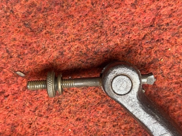

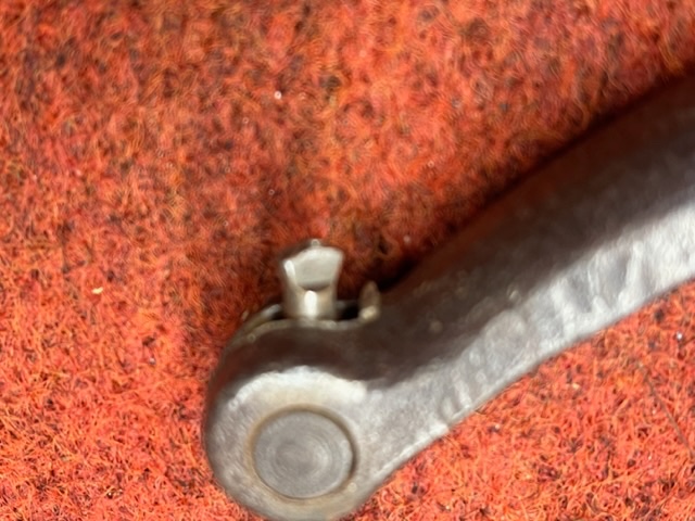

I am gratefully the new owner of this tool. I waited until it was in my hand before speaking. Thank you Mark for noticing it and letting us know about it.
I spoke with the seller and he told me he was cleaning out the attic of a deceased elder relative. The man had worked on cars only when he was young. This one looks like it was either not used, or very little.
Thank you Joe for your kind thoughts and, as always Trent, for your insight and willingness to help.
Jerry, this tool like all thread chasers, should not be used to cut through rust. Bead blast clean before using.
If anyone has a latch to sell or, can help me with closeup photos of the latch screw and threaded swivel, I will make one. Or I can forward it it to the seller so he can look further in the attic.

Hope this helps.

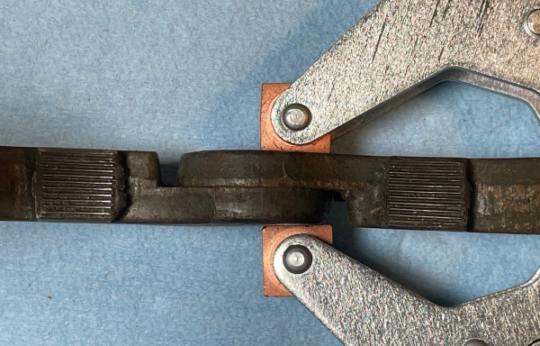

Thank you Allan. You are always very helpful. This sale/purchase attests to the fact that affordable prices can be established when it is for a need and not the last dollar. Four hundred is better than no hundred.
I have a knurling attachment so, off to the lathe. And to answer your salutation, this helps.

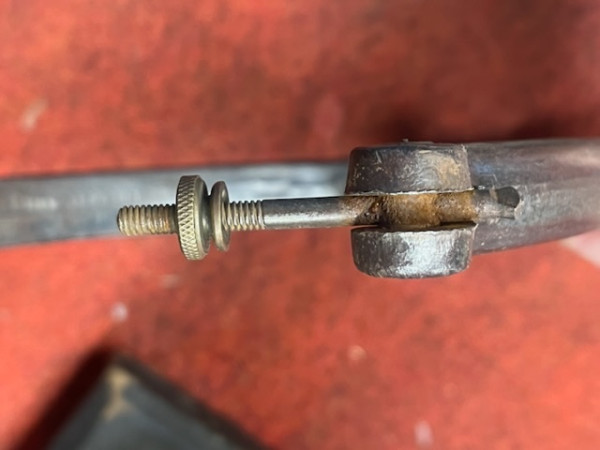

- Posts: 1631

Thank you Kim,
The nut looks like spark plug or coil box nuts. In which case, I may be well under way.

The back side of the nut on mine is radiused so that it sits nicely in the base of the curve in the handle. Kim's does look like a spark plug nut, a good substitute if needed.
