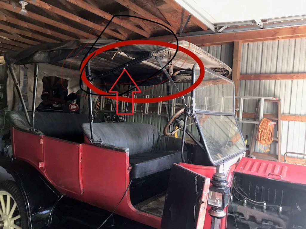

Please help …. I need only the drivers front iron for a 1913 Touring (the one that attaches to the windshield).

You mean the body iron the socket/bow mounts to? The only connection between the header bow and windshield might be a strap.
Posts: 7278
Re: Wanted 1913 Touring top iron
Post by Allan » Sun May 28, 2023 3:42 am
Russ, do you mean the stay between the windscreen hinge and the top of the body?

I might have what you need show a picture of the passenger side and that way we will be able to see what you need

Thank you all for the replies. I misspoke when I said attaching to the windshield, it attaches from the front most iron to the front bow (which attaches to the windshield via a strap). The attached picture is of the passenger side, but am looking for the drivers side (which is not intact). Although I am new to this, searching this forum I have found reference that these "front extension" bars are unique to 1913 because that iron is 26" long and other years are 23" (I have only found one reference to this)

If this is your T, It appears to be a !4. Short doors & W/S folds inward. If 13 is unique for the iron you need, this will matter.

That is the T in question and I “believe” it to be a 1913 based on the serial # and title (we all know how much that means). The forum thread I saw mentioned a difference in length (IE 1915 were shorter). From that post I am unsure if the 26” length mentioned is 1913 or 13&14.

13/14 top sockets are the same. I would think you could get that single socket from John Bornakis.

What is the length of the front top socket for the 13/14 t's? I purchased a set of top sockets for my 14 Roadster quite some time ago and the front socket measures 20" long. Thank you Craig

The short doors and the dogleg in the windscreen stays would indicate a 1914 model but that socket is the same as a 1913 anyway. The 1915 onwards socket was shorter because the windscreen was set further back on the new cowl.

You should ask for the socket, not top iron. For Model T's, the top irons are what the top mounts to on the body.
