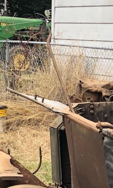

Allan,
Which Windshield does this one take? 13 or 14?

Robbie,
That rod is for a 1913.

Re: Wanted: 1913 or 1914 Complete Windshield
Post by Dan Hatch » Mon Aug 28, 2023 11:47 am
That looks like 14 . Looks like it has the bend in the end.
James: if you want 14, I have a couple in the swap meet trailer. Dan
Post by Tourabout » Mon Aug 28, 2023 12:38 pm
Makes sense,
Engine is a July 1913.
Thanks,
Robbie

Post by Allan » Tue Aug 29, 2023 5:03 am
Robbie, That photo shows what I believe is the support rod for a 1913. There is a dogleg bend in the BOTTOM of the support rod on a 1914, to allow the backwards folding top windscreen to pass between the rods. The backwards folding top windscreen on a 1914 has a rain deflector fixed to the lower edge of the windscreen. This is not found on the forward folding top windscreen of the 1913 models.

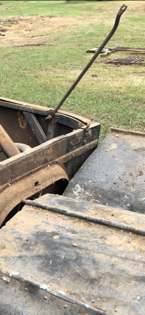

Allan,
Here is another view.

Post by Allan » Tue Aug 29, 2023 8:26 pm
No bend in the bottom means a 1913 windscreen which folds forward.
