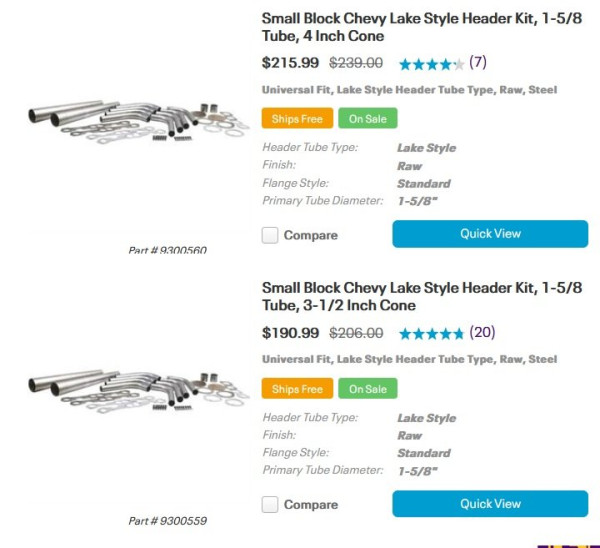

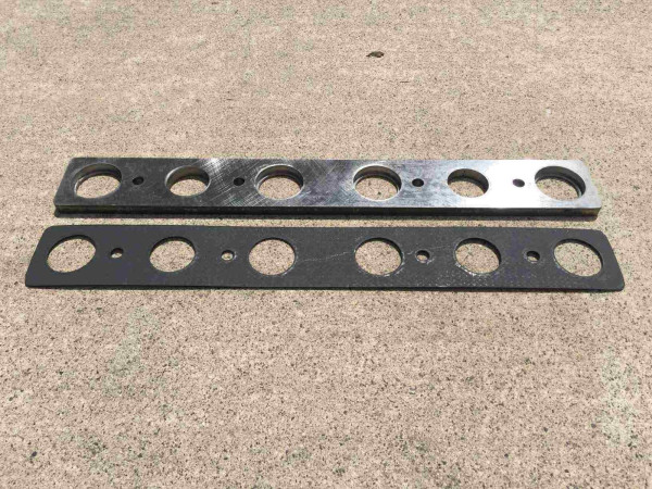

Here's one....

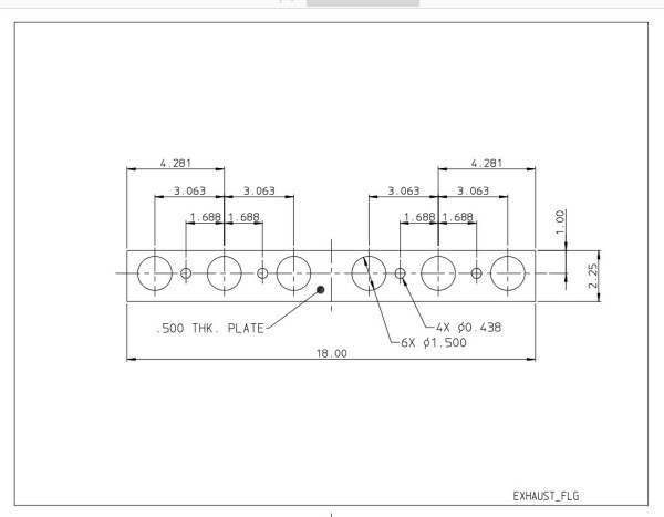

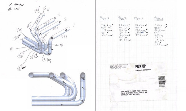

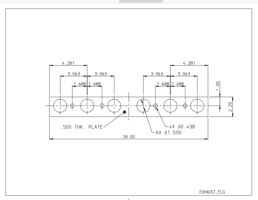

Some other info

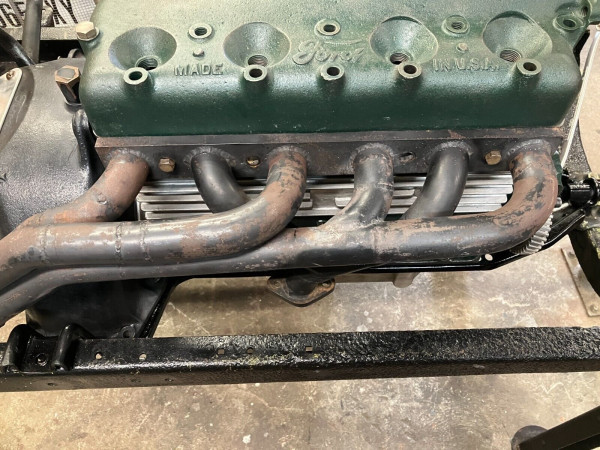

old school someone had on eBay
