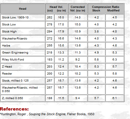

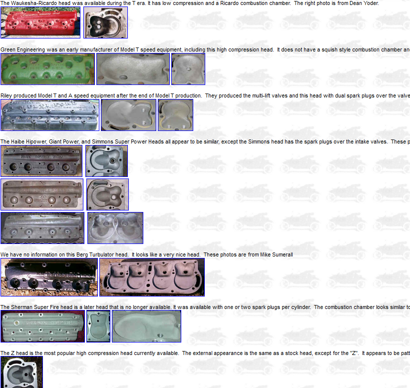

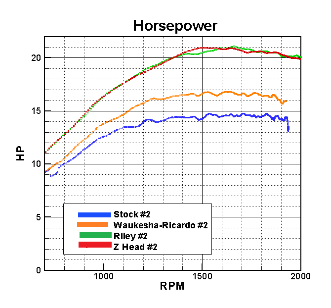

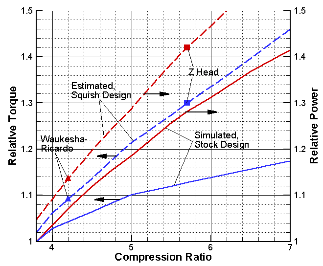

Needs to know
https://mtfctulsa.com/Tech/index.htm
compression ratios.png (105.07 KiB) Viewed 3134 times
"RELATIVE"
