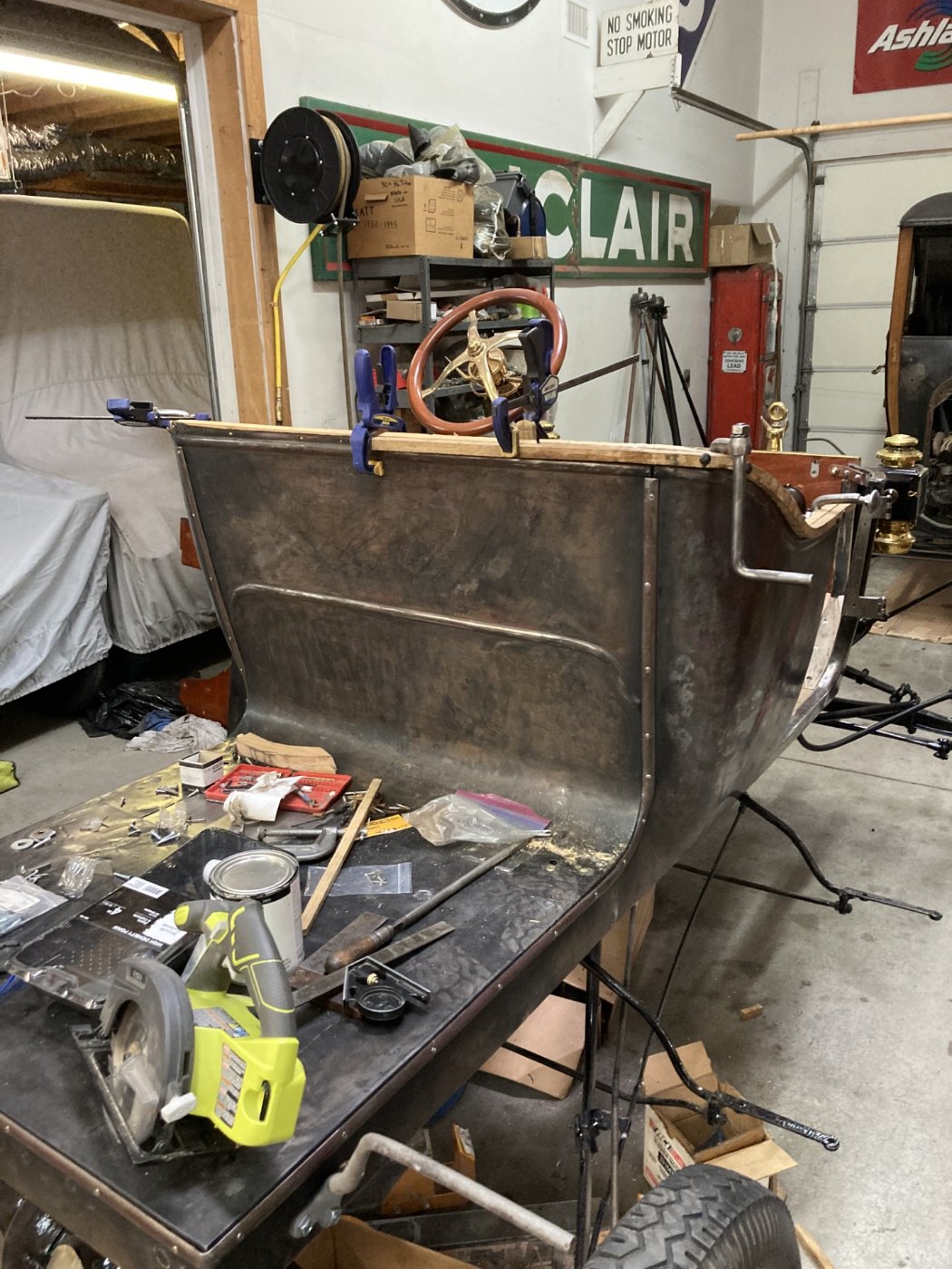

WTB Outside body moldings for a 1914 Ford Model T Roadster. These moldings mount on the back of the body and "curl" down following the lines of the turtle deck just below the deck. The moldingd appear to be solid steel and mounted on the body via screws. any help would be greatly appeciated

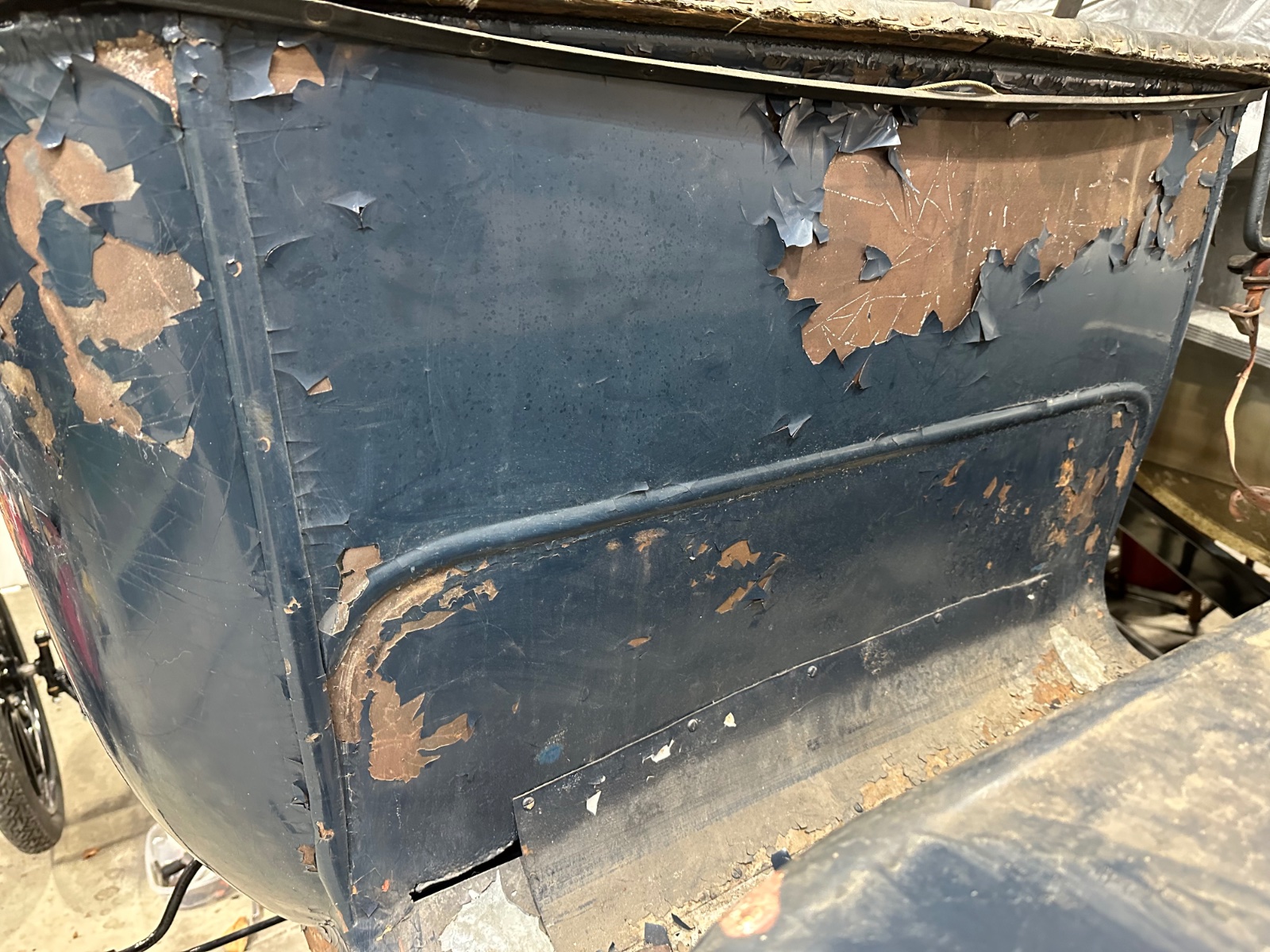

The body moulding on a 1914 is one piece. Here is a photo of the moulding on a Wilson body 1914 runabout

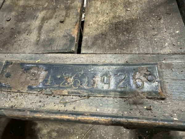

Ty his is the body that came with my 14 project. It is different than what Russ has. I do not know how to determine the body manufacturer. Any thoughts ? Art

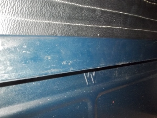

On many 1913-14 bodies, there is a letter stamped into the kick plate in front of the gas tank. The 1914 body pictured has a "W" stamped into the kick panel and a "W" stamped into the wood frame that supports the seat springs. Also note the Wilson rear body panel is one piece and goes from the the top of the body to beneath the turtle deck.

Post by Russ_Furstnow » Sun Jan 07, 2024 12:06 pm
Here is the "W" stamped into the kickpanel.

Thanks Russ. Mine is B.

Post by Steves Ts » Sun Jan 07, 2024 7:00 pm
Thanks Russ and Art for Your replies. I am going to try and replicate the moldings on Russ's '14 . Still hoping to find a "set" that is" pre-molded". Great pictures Guys !
