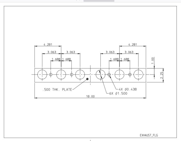

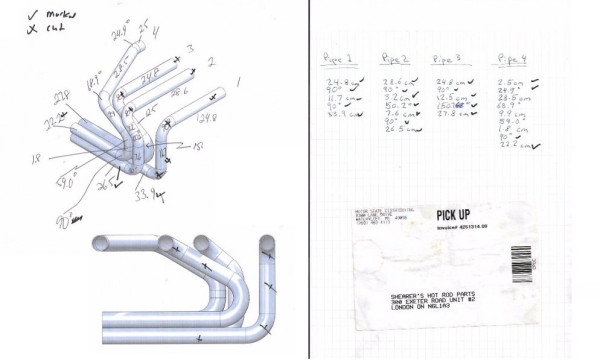

Here are some ideas from a previous discussion
Some flanges available but not as thick

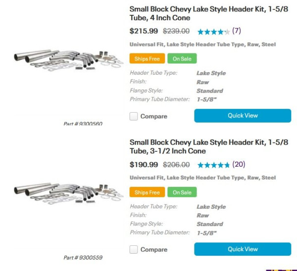

Lake style header - buy and make two, sell one
Older add from Speedway

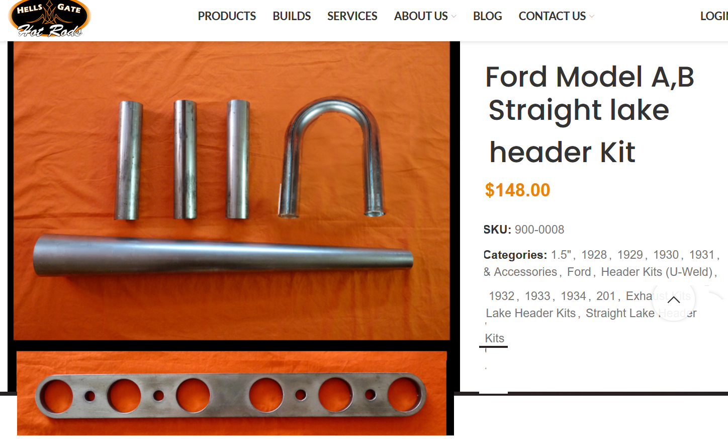

I've wondered if this Model A would work - not sure if the kit is still available but they also weld & fabricate
https://www.hellsgatehotrods.com/shop/f ... eader-kit/

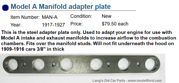

Since the suppliers sell and adapter plate to fit the Model A intake & exhaust to a Model T. I would expect that the Model A/B key above would work.
