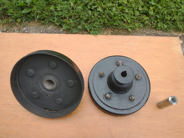

Hi Richard,
You can buy wood to wire adaptors Or I made these for a friend. Craig.

One thing I forgot to mention on those hubs I set up is that modern serrated studs were used because they needed to be longer than the originals
for the spacers that are needed to move the wheel out so there is room for A-C small drum outside brakes. The car they are going on has a Aux.
trans so they would be needed. If using Rockies the spacers would need to be even thicker. The wood to wire adapters will most likely give ample
room for A-C brakes but don't know about Rockies. I wonder if Sure Stop makes a set up for this application? Also keep in mind that when you
move the wheel out you increase the load on the bearing & axle.
Craig.

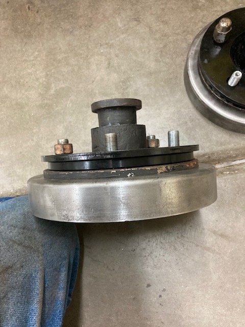

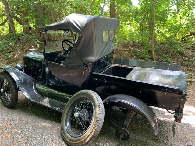

Here is one recent result using that small adapter plate to change from 6 bolts to 5 wheel lug nut bolts.
That truck came close to a roll over!

The problem was solved by buying a set of 1926-27 rear wheel hubs, then drilling four holes in an earlier small drum and enlarging one original hole slightly,
Selecting the proper original hole will allow four holes to be drilled completely without interference or overlapping with any of the original six holes.
Then, some file action on the inside area of the holes allows the original five type bolts to be installed and hammered into place.

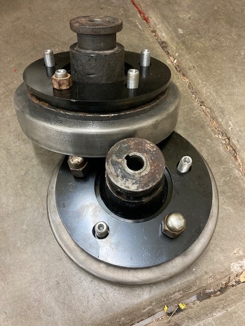

Here are the hubs I made up.
New studs and tool I purchased from Snyder's.
