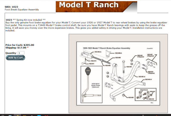

- Posts: 6401
Re: WTB Brake equalizer for '23 touring
You may be putting the car before the hearse. What is it that you want to accomplish? Contact Model T Ranch. The diagram has different dates than the textArbs wrote: ↑Wed Aug 07, 2024 9:18 amGreetings! I'm looking for a brake equalizer that fits a '23. I see ones for sale at the vendors for '26-'27 but not older cars. If you have one you would be willing to sell, know where I can get one, or have plans of how I can put one together, I would appreciate it.

Re: WTB Brake equalizer for '23 touring - Found one
Thanks for everyone's reply. I ended up calling Chaffins and Mark said they don't have any in stock. He said he is not sure when he will have them as his source was from the family that make rocky mountain brakes. Apparently they aren't making any more RM brakes at this time either but the kids might pick it up in the near future. They are currently selling the RM stock they have.
Model T ranch had the equalizer, and they said they have brake systems as well. I ended up buying the equalizer from them.
