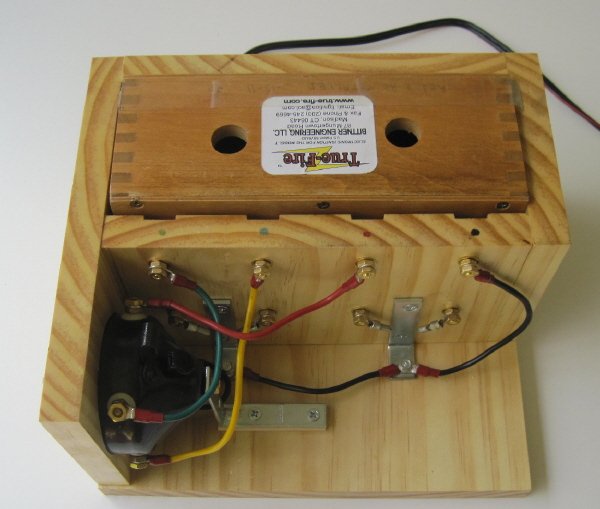

I did make a TrueFire test set that will test the box and timer.
It is not very difficult to do, but most of the time the box is OK, if the fuse inside is not blown.
A big wing nut on the left turns the rotor and is not shown.

Re: Wanted True Fire Ignition Coil Box
The Test Set.
