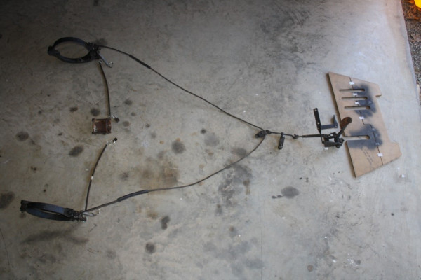

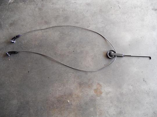

Re: Info on Strong Hold Brakes
Post by ThreePedalTapDancer » Tue Oct 08, 2024 7:16 pm
Here are a couple of pics of similar cable and pulley set ups. The pulley equalizes the cable.
