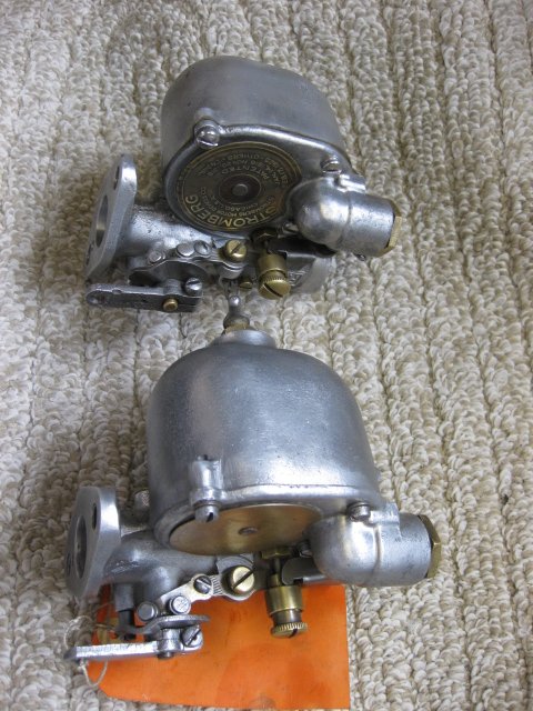

Bruce, can you please post a photo of your RF. I'd like to know what to be looking for.

Here is a pic of the Stromberg RF

Thanks Bruce. It is quite distinct. I'll be keeping an eye out for one.
