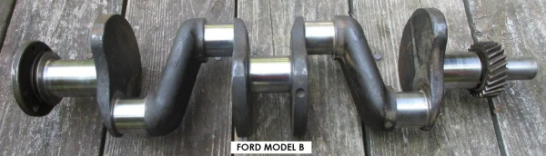

There is a lot of confusion regarding the 1932 through 1934 Ford four cylinder engine designation. These are B motors. The confusion comes from the "C" cast on the cylinder head. The "C" is there because of a quirk of Ford's part identification system. When the Model As were produced they had an unmarked cylinder head. During the production run of the Model A a factory high compression cylinder head was developed, the "Police Head", and to make it easy to tell from the regular heads it had a large "B" cast into the top surface. When Ford updated the four cylinder engine design for 1932 the whole engine was updated to be the Model B, and the new three bolt water pump head got a large "C" cast into the top surface. Confusing, yes? Link to a nice description of Model A and Model B cylinder heads" https://www.fordgarage.com/pages/ABcyli ... arison.htm
The "B" engines had three different crankshafts during the 32-24 production run. The first engine made through at least the end of 1932 had no counterweights. Some of the crankshafts without counterweights got press on counterweights when these engines were returned to the factory for overhaul (Ford had started a factory rebuilt program in 1932). Starting sometime in 1933? new crankshafts in Model B engines came with traditional looking counterweights. All three types of crankshafts are B cranks. A link with a nice table of Model A and Model B crankshafts: https://www.fordgarage.com/pages/rotatingmass.htm
Out of curiosity, why did you end up using German DIN specification cast iron instead of USA SAE specification cast iron?

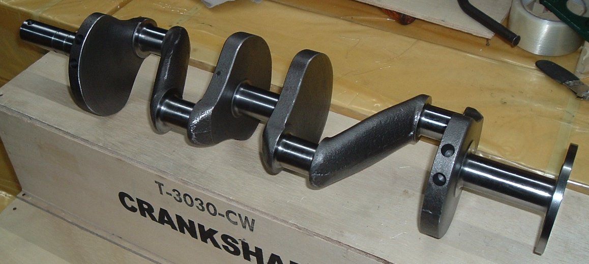

How about some pictures?

They are supposed to be dynamically balanced within 15 grams, I don't have a way of dynamically checking each one.

Well- they have balancing holes so..... also, the units of unbalance are "weight (mass)"- "distance". ex: gram-cm etc. That IS a nice looking crank shaft!
