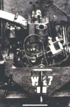

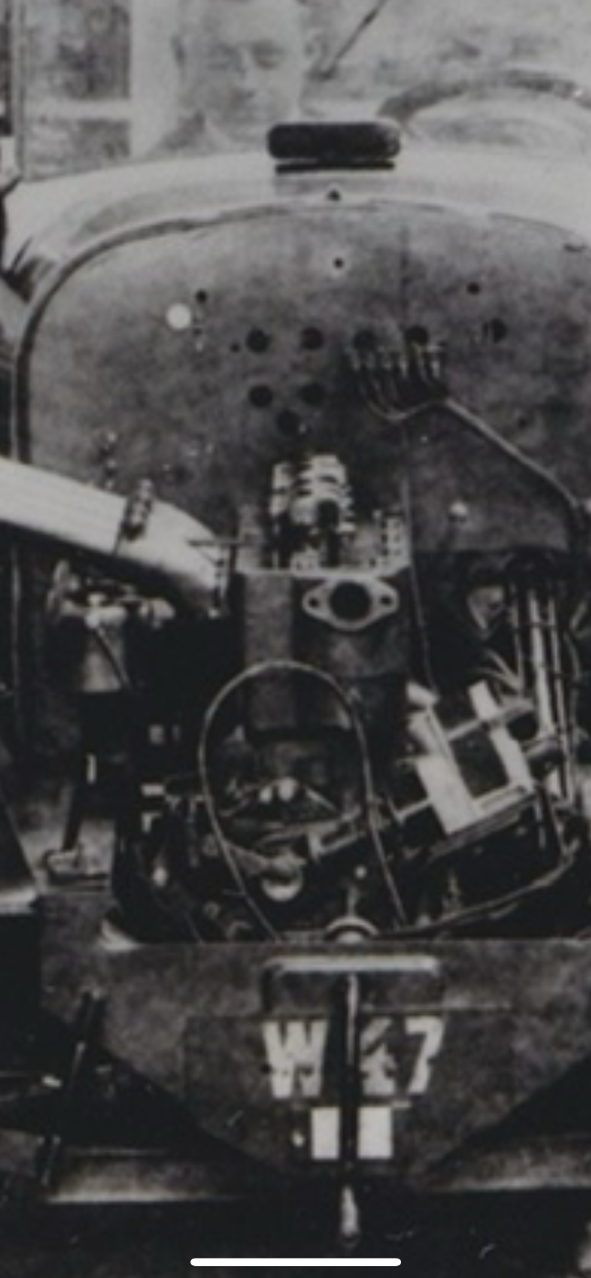

Does anyone know what kind of magneto drive this is? Its not Matco or columbo. It has to much angle.

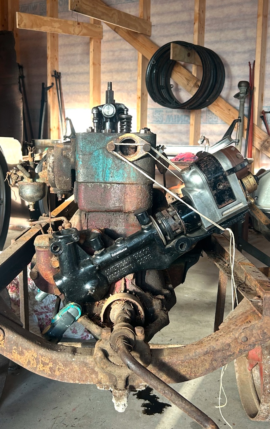

This is a Matco drive and has to little angle to be the one Im looking for.

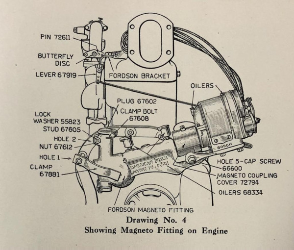

Post by Wayne Sheldon » Wed Jan 22, 2025 7:14 am
Are you trying to buy one like in the old photo?
Must be some reason to want that specific magneto drive?
The Fordson one you show tied onto a T engine with string was probably made by Bosch, and they did build a shorter version for the model T engine. While the Bosch Fordson and several others made for model Ts (including the Matco) are fairly common, over the years I have seen barely a handful of that style Bosch magneto drive for the model Ts. A couple other Bosch styles are also fairly common.

Wayne, I´m recreating this car, so I hope someone can identify this magneto drive so I can start searching for one to buy.

I think it maybe a Lucas unit. I know of 2 vehicles in the UK who have them installed but I can't find any pictures. Nigel Hugo.

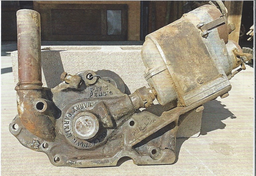

Post by Layden Butler » Thu Jan 23, 2025 2:09 pm
Looks like an Apollo or perhaps a Parkin.

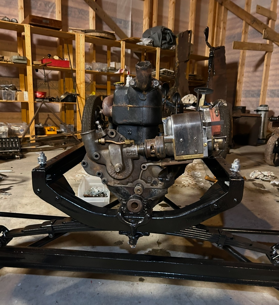

Post by Jonny Eriksson » Fri Jan 24, 2025 3:08 am
Layden Butler!
Thank you! I strongly believe in Parkin! Is yours for sale?
