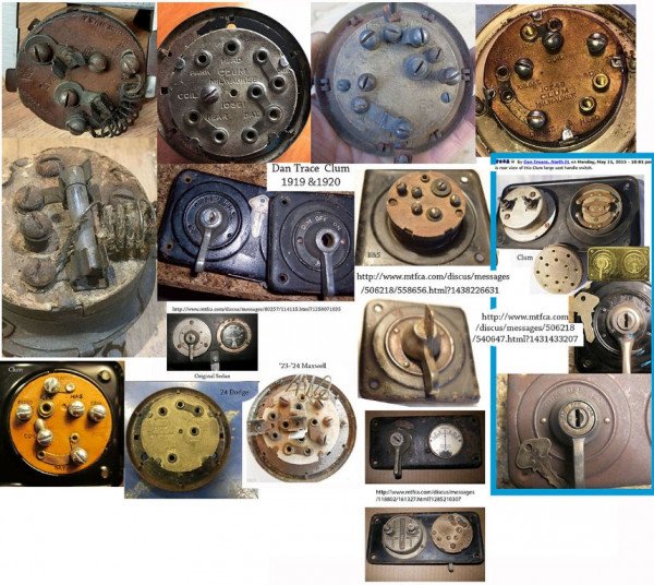

While Briggs & Stratton was the predominate manufacturer of the switches, CLUM was also making them. The internal parts of early switches were entirely different than the later ones. In fact I have at leas 11 variations. I'm thinking that you have a CLUM switch because of the number. In any casemicshotrodgarage wrote: ↑Tue May 13, 2025 7:43 amWTB # 42 ignition key, But did not see this # on the key list. MY switch has 42 stamped on it, Any one else run into this? Thanks. Mike
it would help to see the switch face, keyway & handle, as in the picture below. You can see that the CLUM keyway is a different design. I have a number of Dodge Brothers keys, similar in shape as Ford, but their numbers range from 101-125

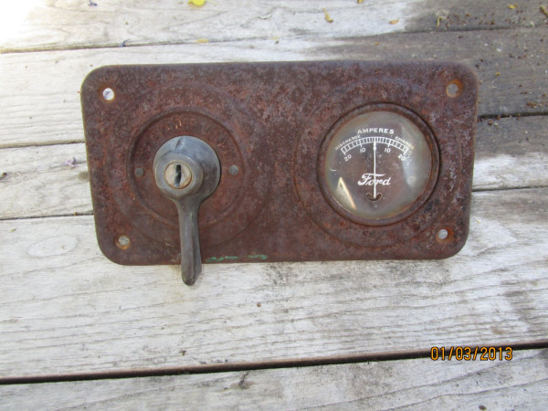

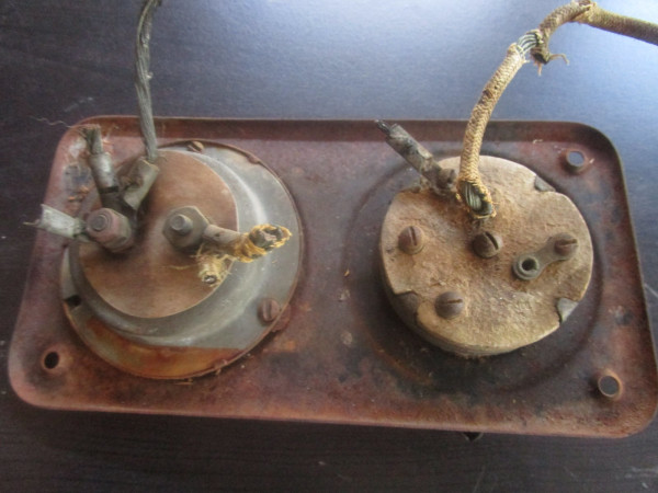

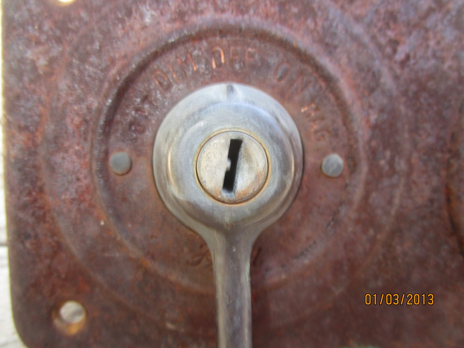

Here are a few pictures of my ignition switch with the # 42 next to the key slot. I wasn't able to take a closeup of the # but Looks closer to A Ford then any thing I have seen, Although the jury is still out with no know # 42 keyed ignition? I do have a set of T master keys and one did turn the lock to the right. Also wasn't to read anything on the back, but it does look like the first "Briggs & statton" photo from TDRxB2. This may never amount to anything but a Model T era mystery. Mike
- Posts: 6577
Re: WTB #42 ignition key
The pictures generate more questions and a path to resolve them.
Looking at the pictures of the switch..
How long have you had his switch / where did you get it (may help understand if its been modified)
The switch plate has Ford script behind the lower part of the handle - likely an original
The handle condition doesn't match the rusty plate - (modified?)
The two rivets don't look original, but could be.
The backing plate is the final design used - the tabs don't look like they have been messed with, that would have caused markings in the backing plate so might not have been modified.
If you can rotate the cylinder without a key inserted in it (maybe one just in a bit to try) - then its split and no use getting a matching key.
When turning the handle you should feel it going over some indents that are in the underside of the backing plate. If not then it needs repair or replace (the fuzzy paper outer layer may not mean it needs replacement could be surface)
Given what I see I would remove the backing plate and see what the guts look like. Some designs do not require the rivets to be removed to get to the cylinder

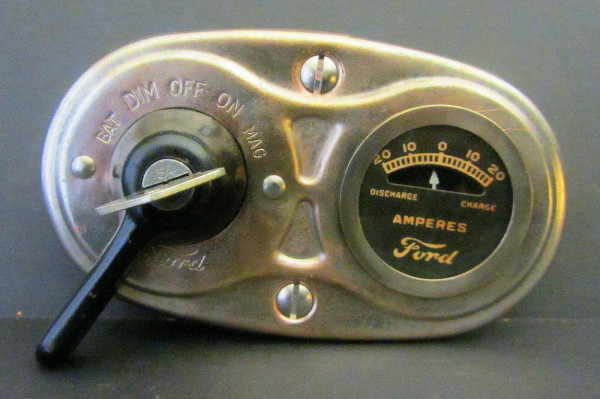

So for you '27 pickup wouldn't you want a switch for that year. Oval shape. Note the repro switches (chrome handle) do not have a good record.
The ammeter you have has value if it works.
This is a picture of a restored original
Repro switch with repro cylinder and keys (chrome plated instead of nickle)

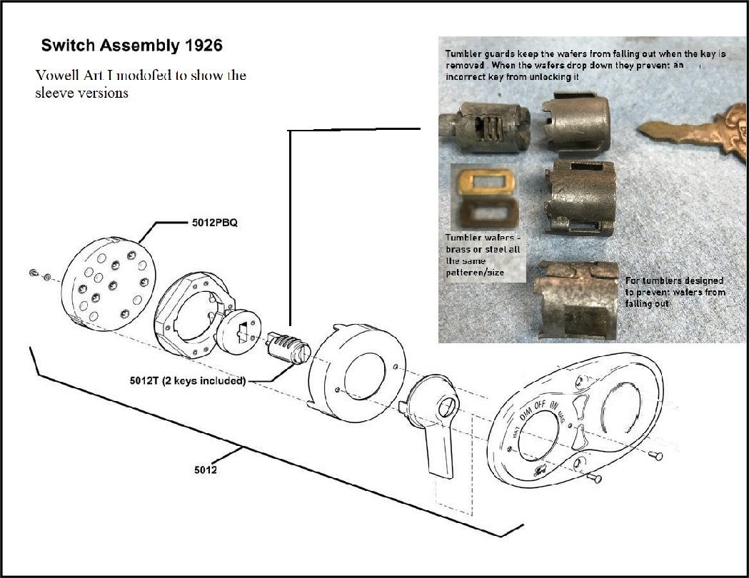

The repro cylinders don't fit very well (note they say for use without the sleeve that fits over the cylinder). That's what the wafers fall into to cause a lock. The diagram is a generalization of the assembly as there are two different backing plates (clip & pin types) and the method that the sleeve & handle attach to large & small contact disksmicshotrodgarage wrote: ↑Thu May 15, 2025 12:31 pmFrank, That would be the one I need. I do have the nickel face plate part, So I'm hoping I can use parts from the one I picked up and make it work? I have seen the replacement parts for these, but I didn't see a separate lock cylinder available? Also I'm sure a member of the clue here might have one to sell, see what I can come up with the parts I have first. Might need to ask your advice as I go along if you don't mind. Thanks...mike
