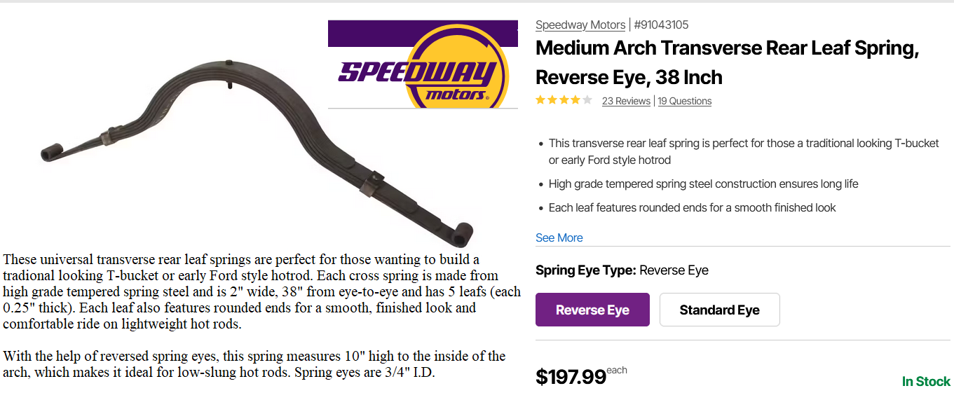

I looked at Speedway Motors they have the correct width, 2", but way to long.

Mr. Brandi, much thanks for trying to help me, but I had hoped to buy just the main leaf either made reversed new, but preferably an original main leaf that someone straightened first, then bent the other way to reverse the eye - which I am guessing at this point, I am going to have to do myself. Unless I am real lucky, which usually never happens, even if I find one someone has reversed, the arch may need tweaking to fit with my seven tapered leaves.
