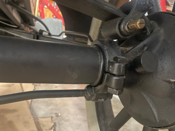

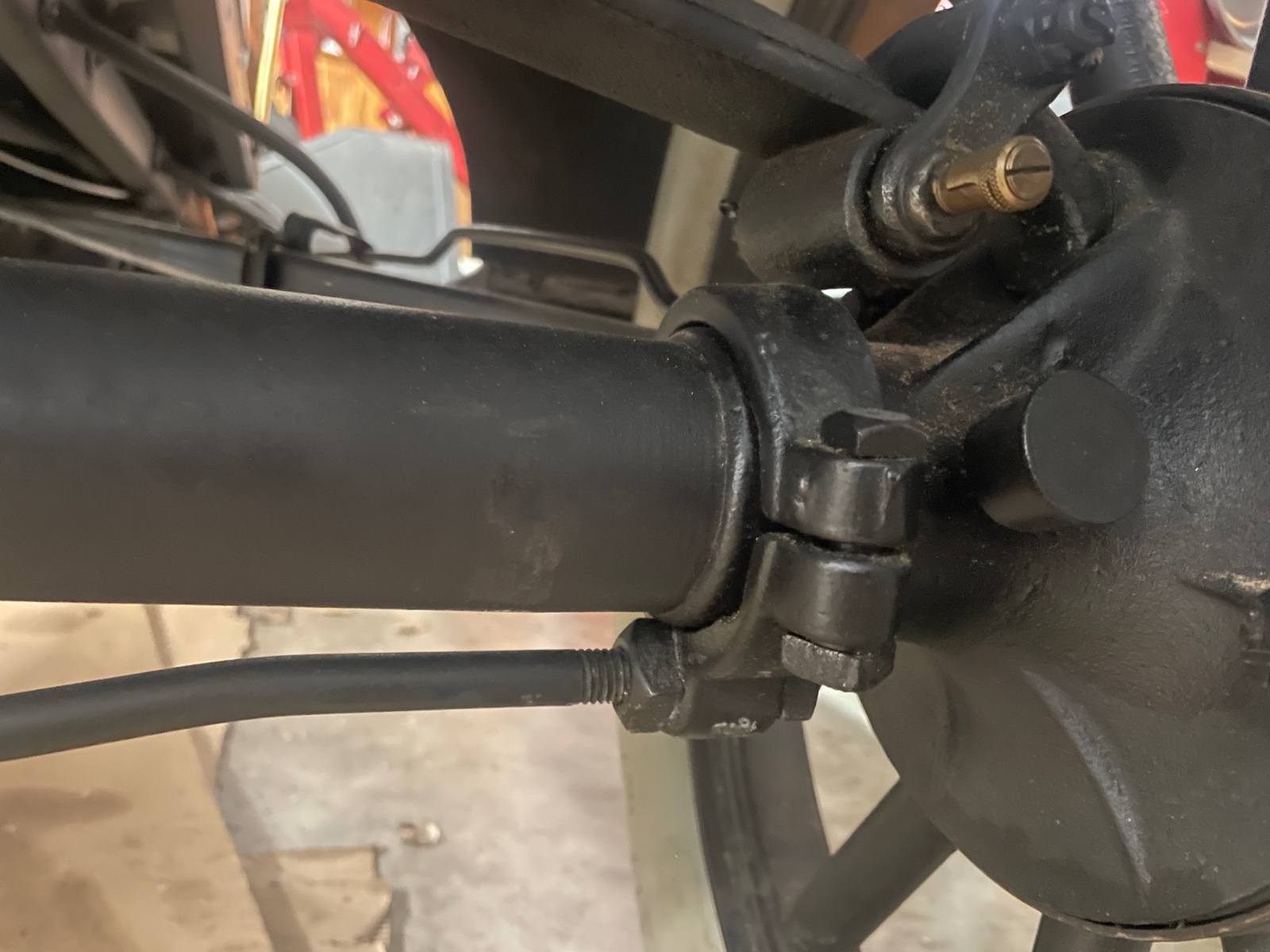

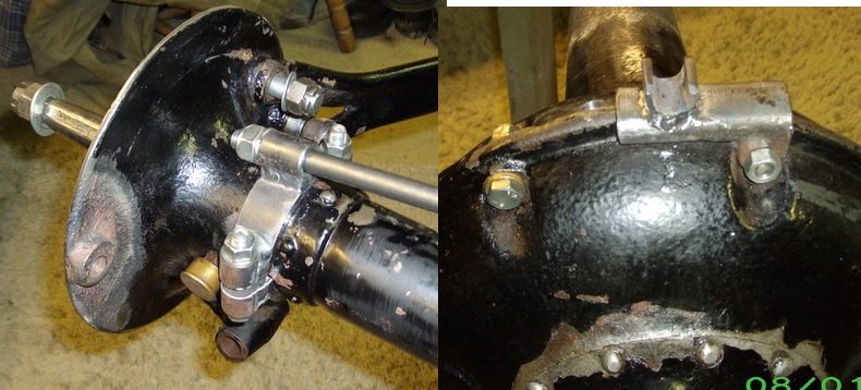

What keeps the rod in place when it goes under the pumpkin?
- Posts: 5599
Re: Looking for a rear axle brace for a 26
Mine has a cast bracket that nestles one of the lower pumpkin bolts.

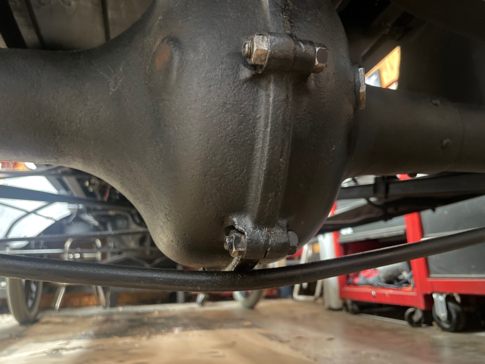

- Posts: 4090
On my '12 open express project, just did the shade tree fix, bent the steel rod to run close under the pumpkin. At least looks good to me! Besides the heavy cast later pumpkin is plenty strong.
And some types of the rear axle braces were made with just a support rod, not fixed to the pumpkin.
Did a lucky find one time at Hershey Swap years ago, a complete original accessory axle brace, with the plate that fits to one side of the pumpkin, and had square lock nuts to fix the long rod that was threaded also in the middle. Paid a bunch more $$ for that original set up, as the seller knew what it was and how rare. My later add on garage made unit was so less $

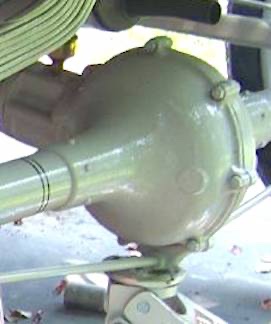

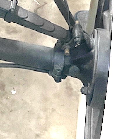

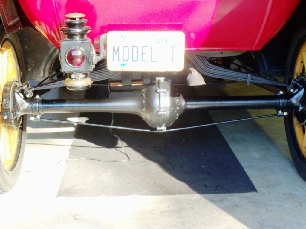

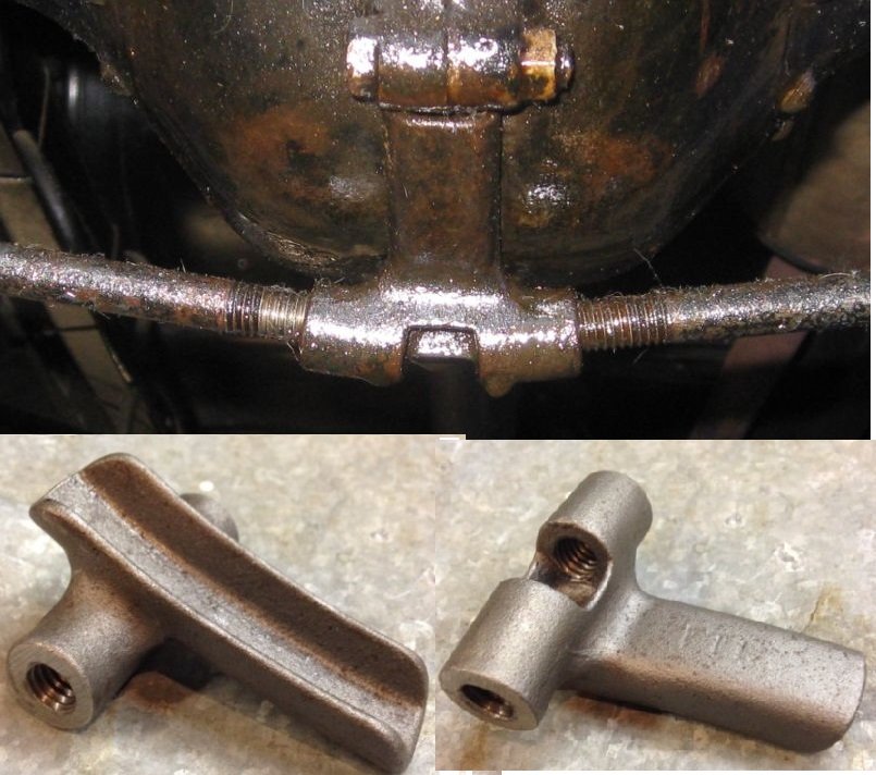

- Posts: 6588
Shows pictures og different styles & the original attachment that goes on the pumpkin https://www.mtfca.com/discus/messages/1 ... 29976.html
This is a DIY setup for all part but the pumpkin part is of interest https://www.mtfca.com/discus/messages/4 ... 75167.html These pictures are from another links
