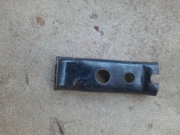

Post by Melba Nolan » Sat Aug 02, 2025 1:17 pm
For sale: spare tire rim clamp $10 plus postage

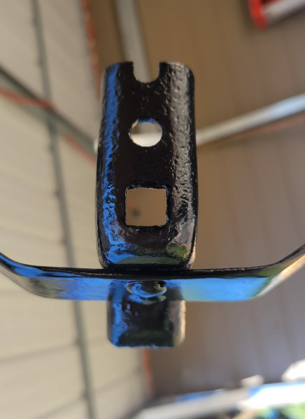

Re: spare tire clamp
Post by KWTownsend » Tue Aug 12, 2025 4:48 pm
I'll take it.
Do you have the bolts for it?
Keith
Posts: 4797
First Name: john
Last Name: karvaly
Location: orange, ca
Post by speedytinc » Tue Aug 12, 2025 4:55 pm
There are no bolts.
The big hole goes over the existing carrier stud.
The upper hole & notch are for a padlock.
Posts: 1407
First Name: Keith
Last Name: Townsend
Location: Gresham, Orygun
Post by KWTownsend » Tue Aug 12, 2025 5:04 pm
Mine has no stud, just a square hole, about 7/16".
Posts: 4797
First Name: john
Last Name: karvaly
Post by speedytinc » Tue Aug 12, 2025 5:16 pm
There should be a demount able sized fine thread stud swedged from behind.
You'll need to make & secure that stud.
Posts: 1407
First Name: Keith
Last Name: Townsend
Post by KWTownsend » Tue Aug 12, 2025 5:58 pm
My thought was to fabricate one out of a lug bolt.
Posts: 4797
First Name: john
Last Name: karvaly
Post by speedytinc » Tue Aug 12, 2025 6:14 pm
That can work. Might want to weld/braze into position.

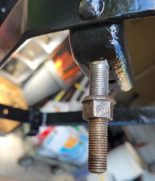

Post by Jack Putnam, in Ohio » Wed Aug 13, 2025 4:36 pm
Once it is in place. Held by the nut it won't fall out. No need to braze.
Posts: 4797
First Name: john
Last Name: karvaly

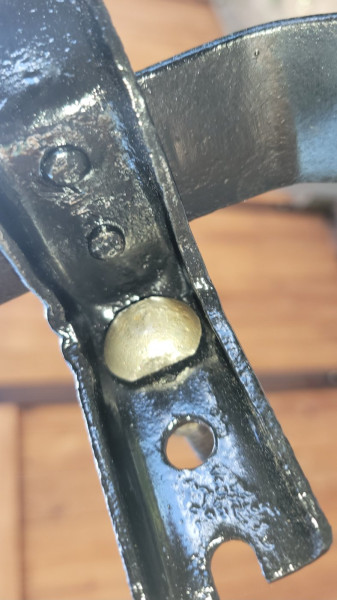

Post by speedytinc » Wed Aug 13, 2025 4:52 pm
Until you remove the spare rim.
Quiescently, I saw a nos replacement carrier base mount last night.
The stud is a fine threaded carriage bolt.
The outer edges of the square of the carriage bolt are chiseled down to lock the square under the bolt head in place.
