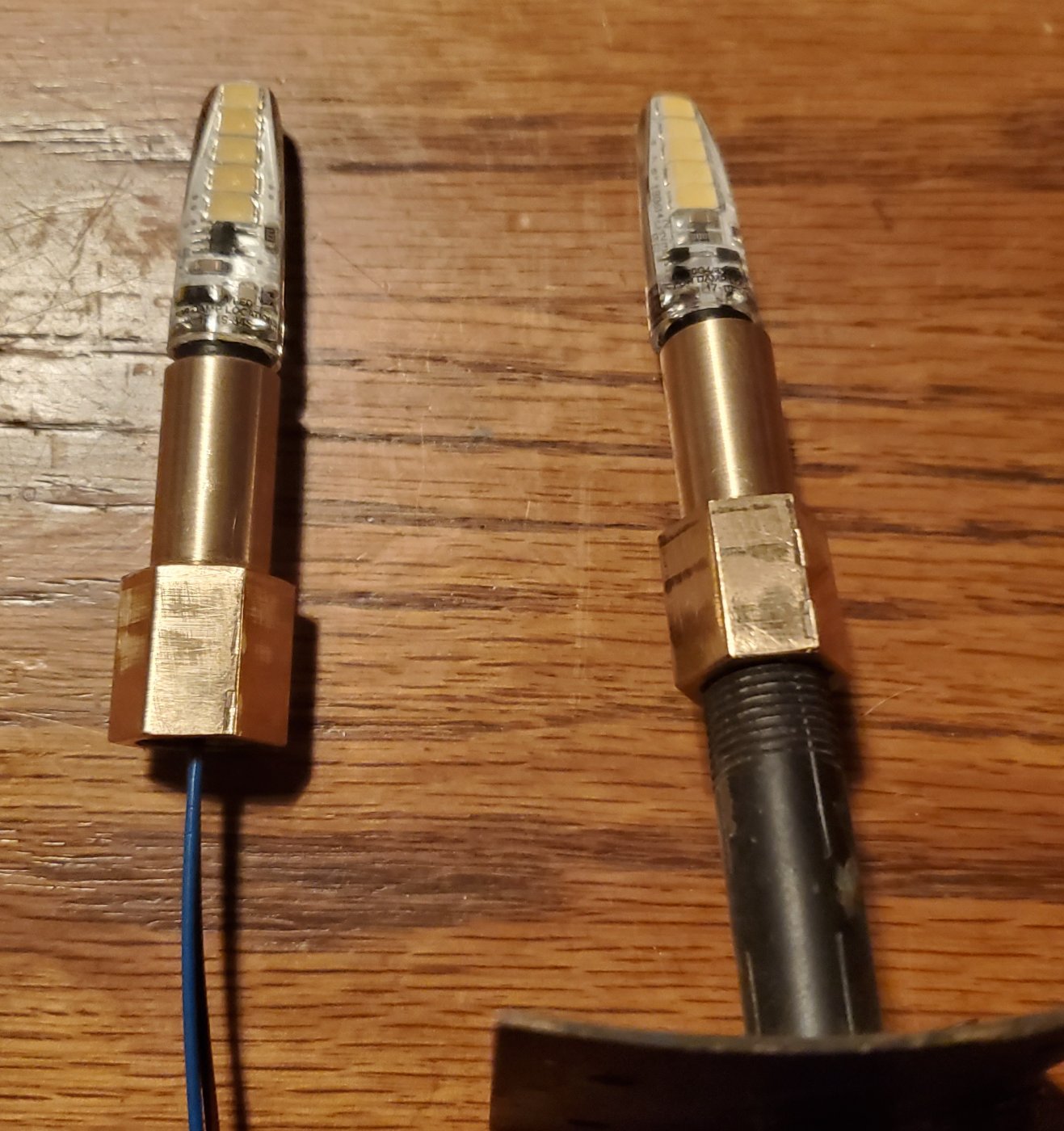

My LED kits do work with the reflectors for the brass head lights . snyders and langs carry them. They do sell a bulb now that works for the electric headlights it does not need the reflectors . they are about $40 a bulb they work great.

Quartz bulbs can draw up to 5 amps at 40 watts each bulb depending on the brightness of the light. The led bulbs only draw 1 amp each at 40 watts. food for thought.

Post by Tim D » Thu Feb 19, 2026 4:14 pm
He is a picture these are the protypes. The bulbs unplug if they burn out.

Post by fireheadman » Thu Feb 19, 2026 4:20 pm
I was just looking at those at langs site
how do they work for you?

Post by Tim D » Fri Feb 20, 2026 2:40 pm
When I first started with these there was only 2w led bulbs available. now there are 5 w bulbs . close to the quartz 50 watt.
