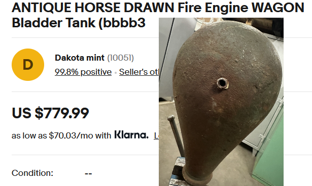

Out of curiosity, I bought this thing from Lang's. I would like to buy a copy of an instruction sheet, advertisement or other helpful information as to how it is installed and its operation. Many thanks.

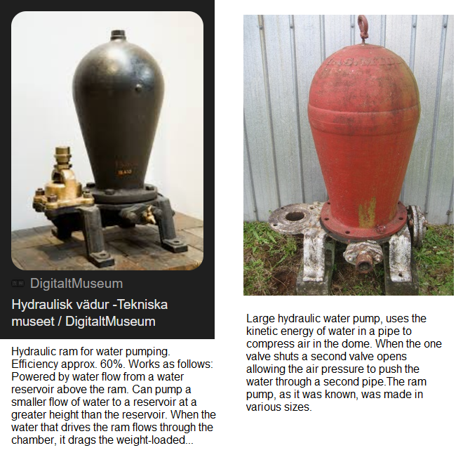

Looks like part of a hydraulic ram water pump. Depending on size could have been part of the water pumping system on a firetruck. Don't know just making a guess.

I did an image search. The eBay one looks closest, the other two have a relief outlet on the top
